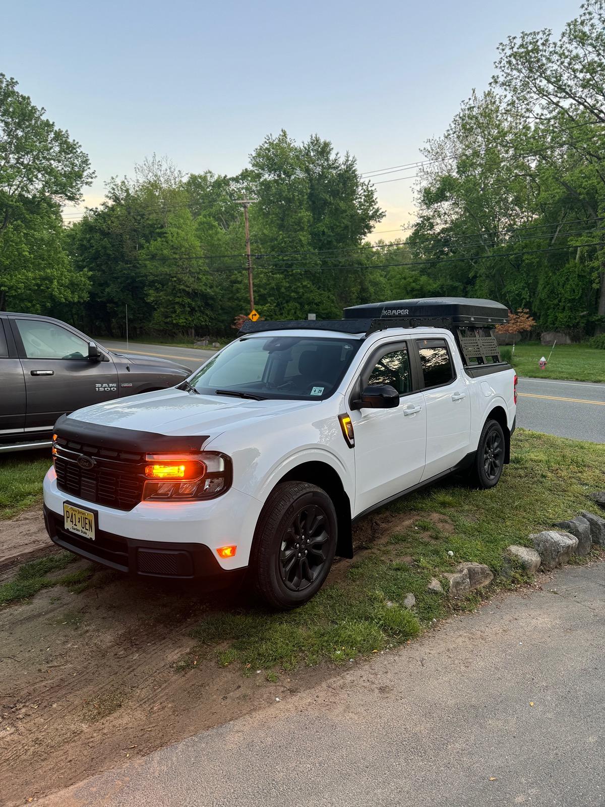

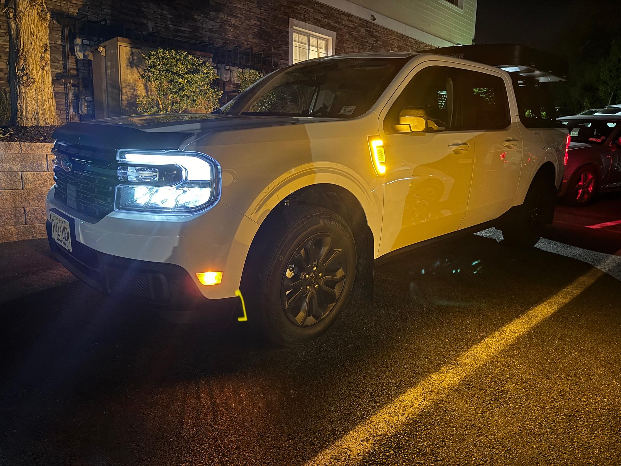

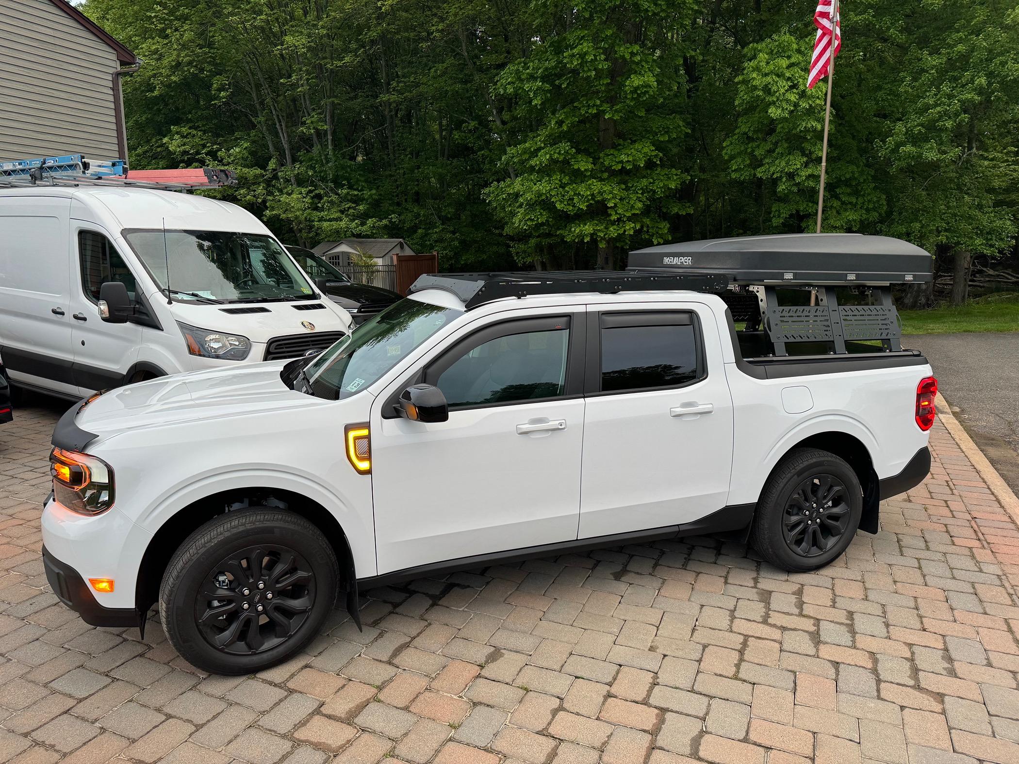

Mabett has been a big friend of mine during my build. I have their mudflats, seat covers, side marker lights, and a couple of cab accessaries. Haven’t seen many people with the side marker lights but I assume the wiring for them is incorrect.
your right on the side marker lights . The are quite a few of them out there, with the passenger side wiring being messed up.
