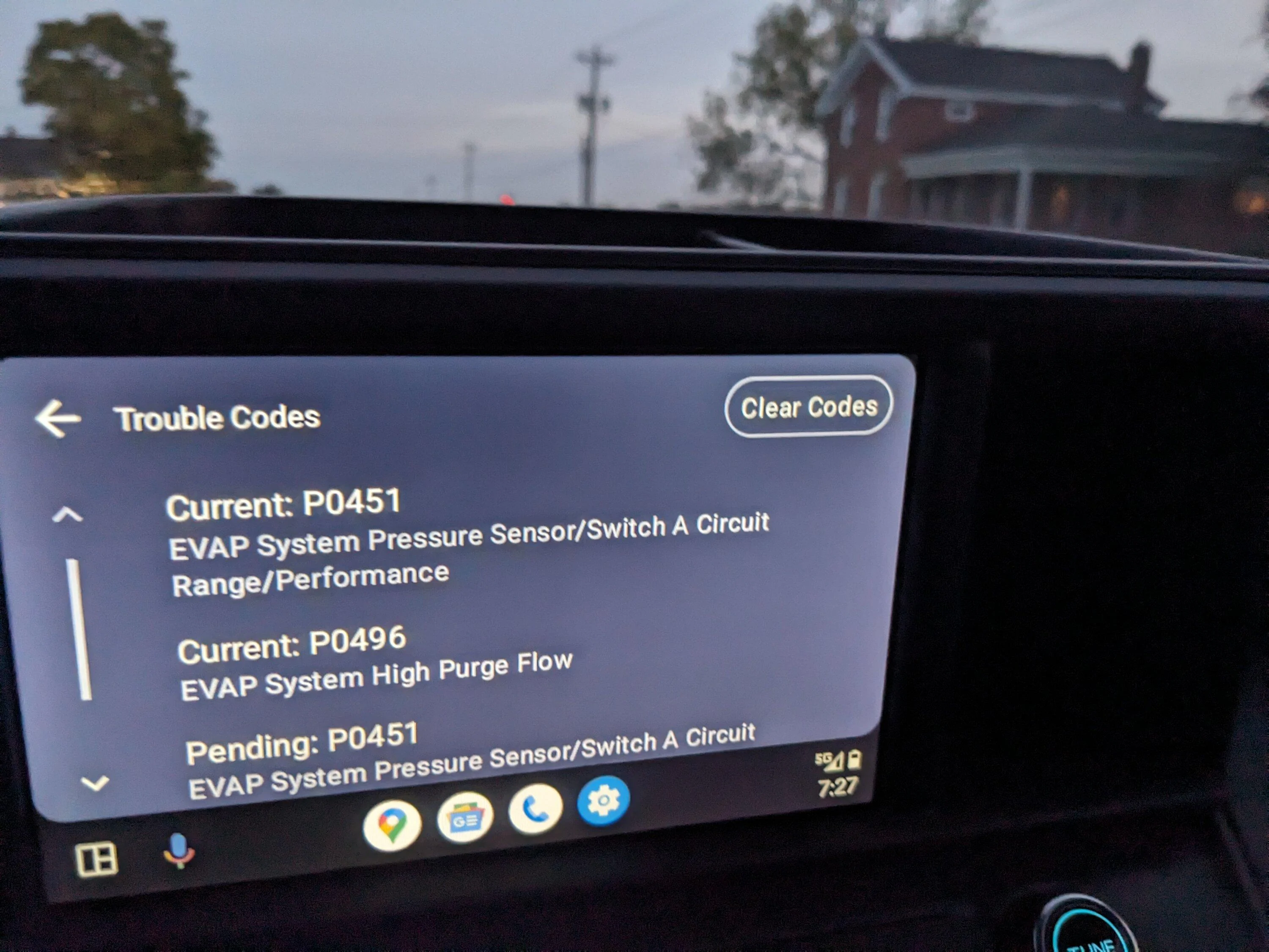

I, and many other owners, have had similar issues with the hybrids, and even some have reported the issues with the 2.0. See my thread entitled My Experience With Deep Sleep Mode Messages. So far, I have not been provided a solution and I haven't read that anyone else has. Some think that we are experiencing the early symptoms of a wiring harness complete failure, at which time Ford will apparently deal with the issue. I will add that the "longer drive solution" has not worked for me as I have often received the message shortly after taking a 20 mile drive.
I too received the same FordPass message REMOTE FEATURES DISABLED TO PRESERVE BATTERY on my 2022 XL ECOBOOST with 29K miles. This was after driving 35 mile to work so it was not from not being driven. It also reset my check engine light that had been on for at least 2 months waiting for a replacement fuel tank pressure sensor. Odd that was the morning before my service appointment to replace the sensor and now no CEL is displayed. The current PO496 and PO451 are still stored but no light. Did my truck lose power and reset?
Ford Maverick Low battery warning message received in app! PXL_20231019_112731087.MP
