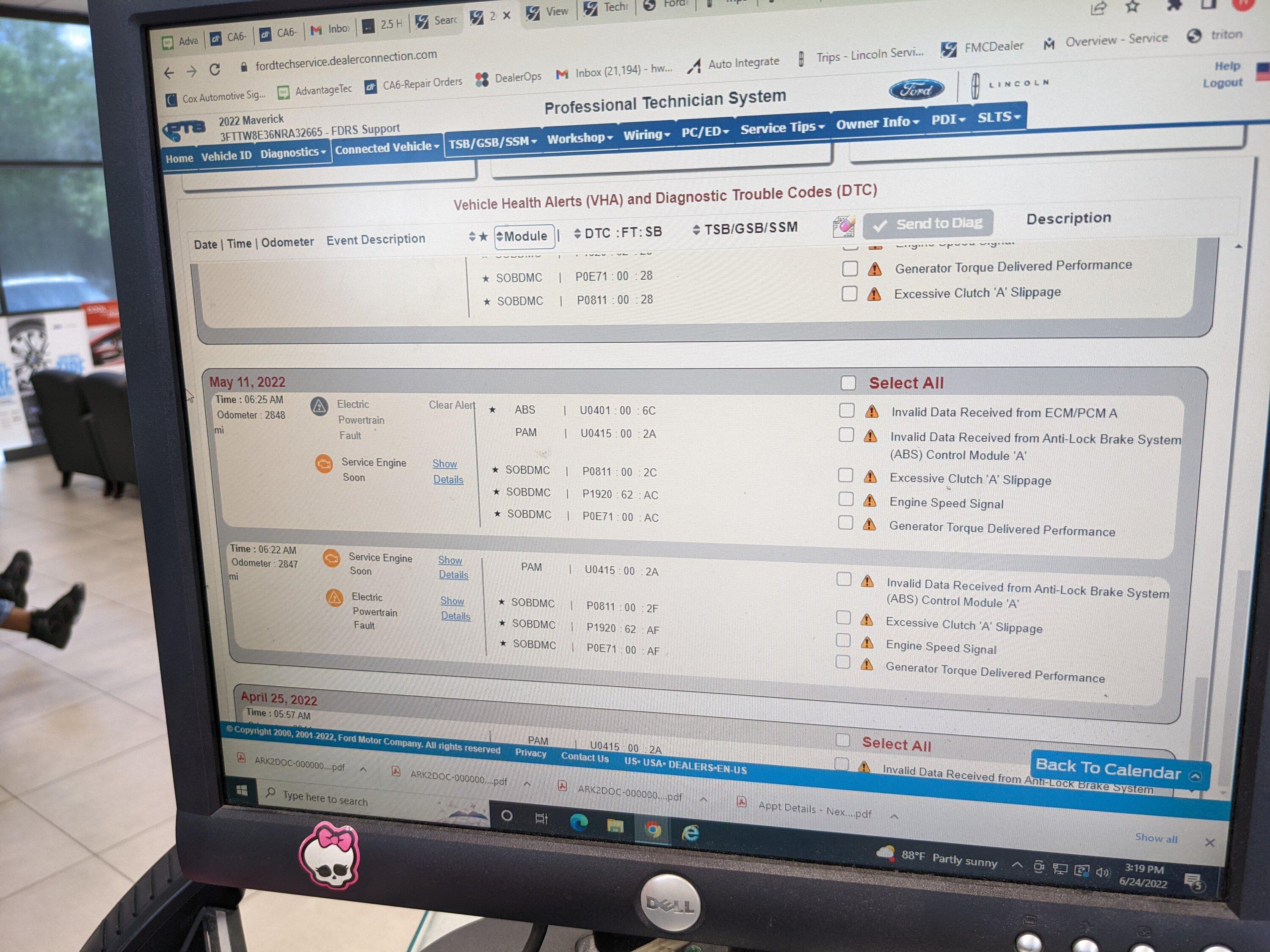

Looking at the screenshot. the error conditions of slippage could be due to the error concerning the engine speed. If the engine speed is misreported, it can be construed as slippage. I am sort of surprised there was no suggestion to check the sensor that determined engine speed.
You originally mentioned speeding up to get around another vehicle, which in most cases would involve an increase in engine speed. It seemed the problem occurred immediately after engine speed increase. I would be looking at any OBD-II data that would demonstrate if the engine speed sensor was broken, needed adjustment, or perhaps had a poor connection or damaged wiring. IF the sensor(makes no sense as the computer does the spark control... i.e., engine speed??? weird) is working, then the clutch connecting the ICE to the CVT could indeed be slipping. MIght make sense to take a look at the lube in the CVT, checking condition and level. I have not looked, but assume the clutch involved is a hydraulic unit as used in regular automatic transmissions. They can slip when the pump is worn, there's too much leakage in the plumbing or in the clutch pack(damaged/cooked/hardened seals), or other mechanical.
The rest of the CVT is all gears and bearings, depending upon the small motor to adjust ratio and direction, and hold fast to get max gear ratio. I think.
The clutch is dry and external to the transmission between the input shaft and the engine flywheel. It is similar to a manual transmission clutch without any throwout mechanism; effectively always engaged. It's there to slip intentionally should there be an excess in power across the linkage.
