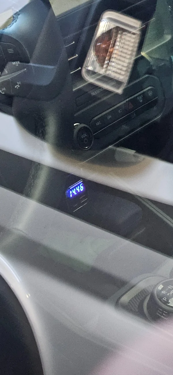

I have a simple 12 volt indicator plugged into my trucks cigarette lighter port/12 volt power port. If power is on in the truck, I can see what the battery is being charged to when ever we are driving. (Bought off Amazon.ca)
It will also give you your battery charge level after you turn off the trucks ignition for about 90 minutes (as per reported in this forum).
1st photo shows what the 12 volt power level is when the ignition is turned on and charging from your hi voltage Drive Battery.

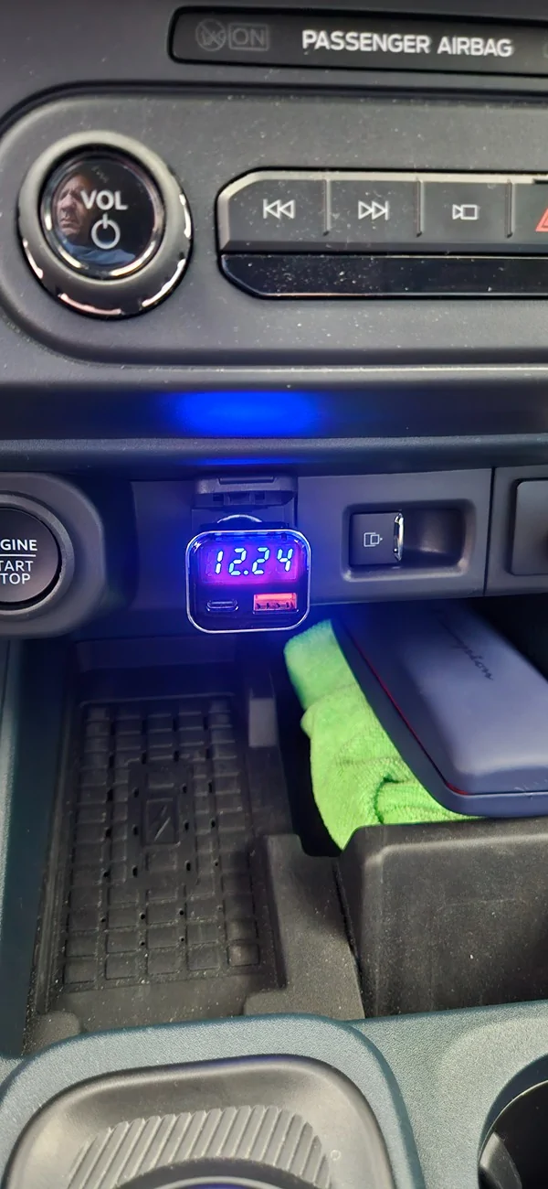

2nd image shows the battery voltage just after turning off trucks ignition switch. Power is still on and only shows your 12 volt battery charge level (also keep in mind that this indication is usually about 0.2 volts low due to line resistance) now that the hi voltage battery is disconnected.

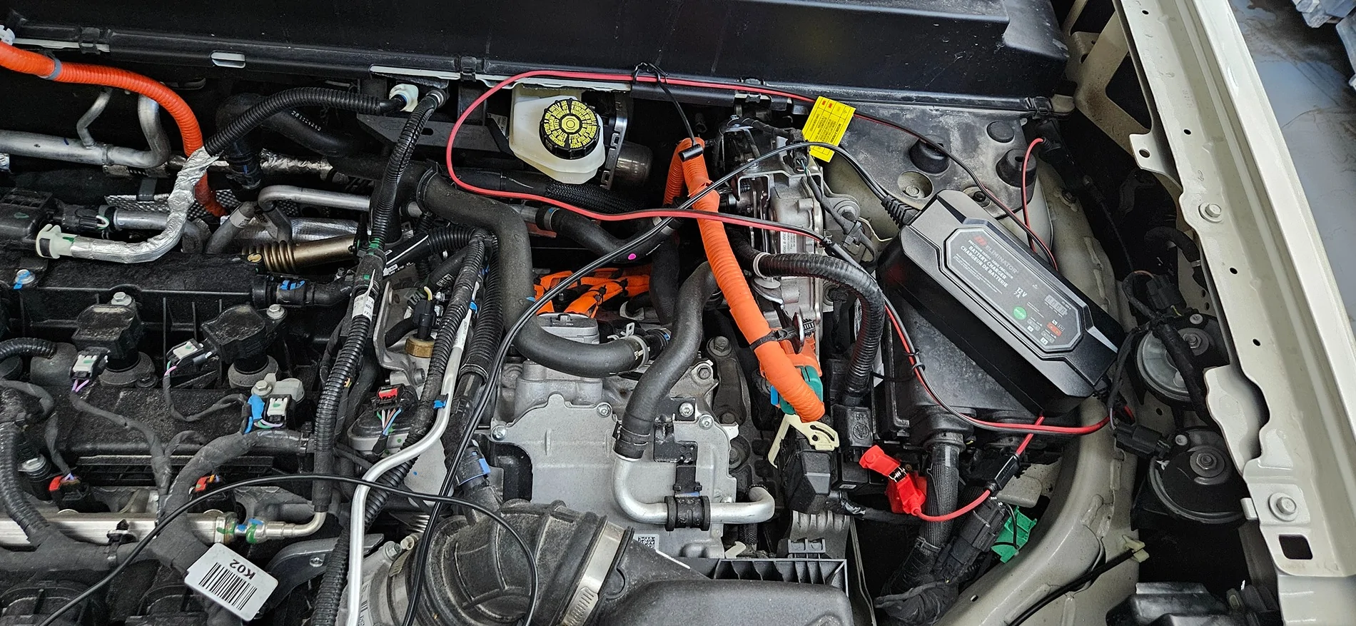

3rd image is showing where the remote battery access terminals are for charging. The red post is easily seen once the red cap is flipped off and for the ground post, just look for a grey coloured post attached to the side where the black clip is located.

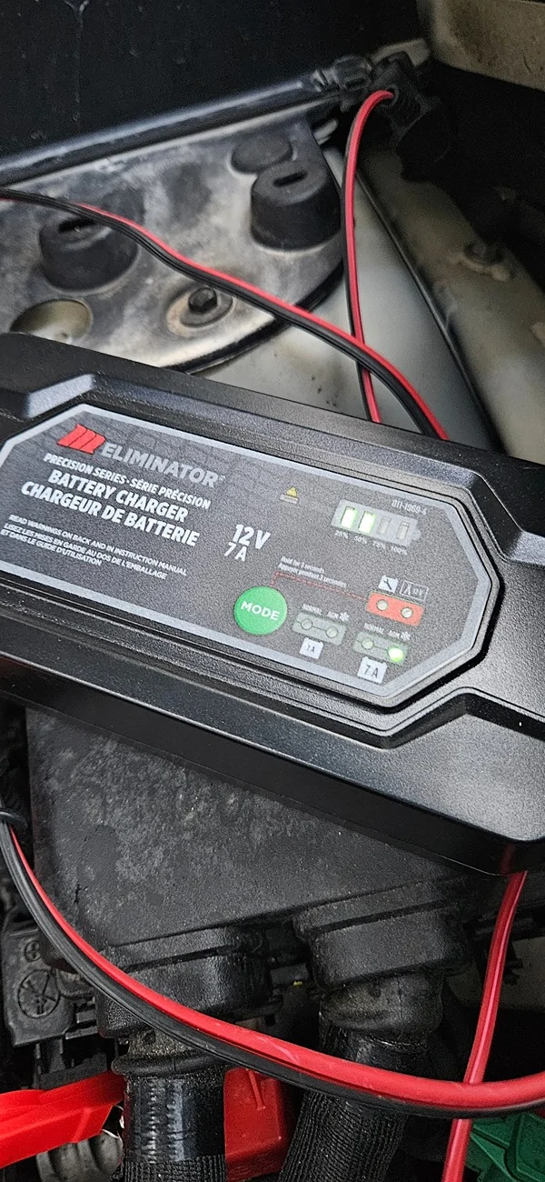

4th is just a close up of my not very expensive battery charger from Canadian Tire. It is set to 7 amps and to AGM battery.

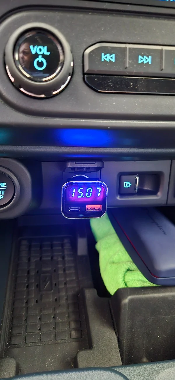

5th image just shows me peeking through the driver window to check what the charge level is now that my charger is connected and charging. It is at an appropriate charge level for AGM. Only can be seen for the 90 minutes mentioned earlier.
Ford Maverick Low battery warning message received in app! 20260331_114528
I will charge all of today, and will go out and open a door once or twice, just to cycle the charger. Then this evening I will disconnect the charger and lock the truck up for the night (9 or 10 hours) for a battery relearn.
