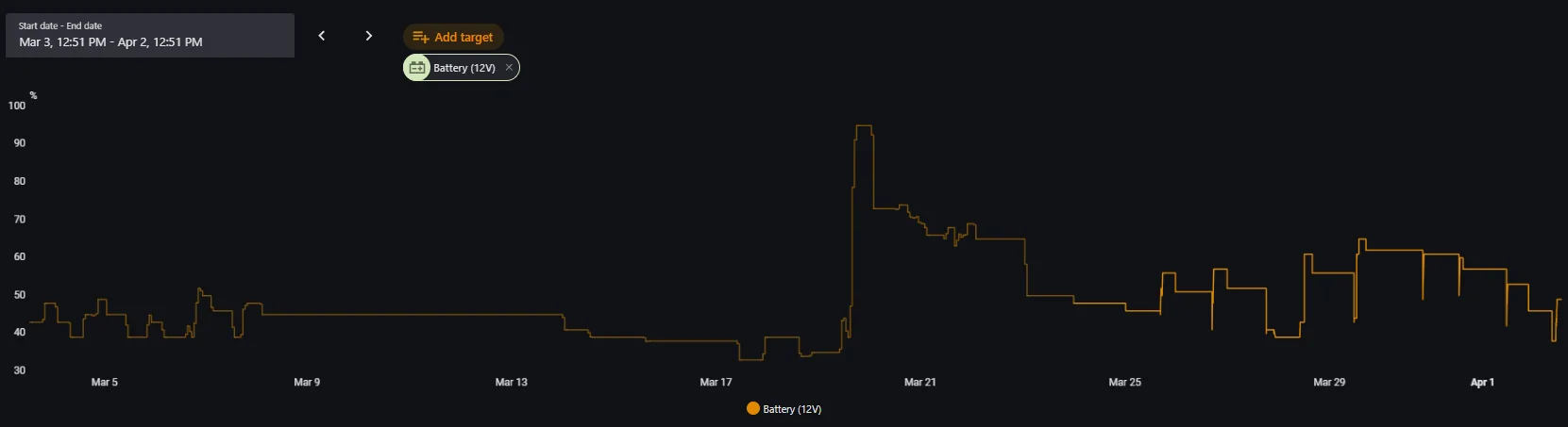

I use Auto climate almost exclusively, and sometimes the AC turns on during the winter. I'm not sure what drives that or not, but AC helps with fogging windows so maybe there's some intelligence there. Definitely not on all the time, though. Are you saying the ACCM module draws power even when not in use or when the truck is off?
In case you're curious, this is the graph from the last month. That long stretch is a vacation so obviously it was going to sit, but curious how it didn't drop at all during that time, though. Also not sure what those weird spike drops are in the last week, either.
Either the ACCM draws power, or it's requesting cooling fans on (some posters observed hours after shutdown). Fans is a fast drain, even if only during the 60 min before sleep.

I did a little farting around and I'm sad to say, I actually think it might be the camera. I don't know if there was a weird setting or what, but those valley spikes had me concerned so I factory reset the cam and did some reconfigurations and I haven't seen any drain over the last few days.
You can basically see in the graph when I reset.
Do you think I need to do the relearn process given the whacky nature recently?
No - unless you need to unplug something.
It'll happen every so often anyway when you lock the doors and it has 9 hrs.
Great find though.
