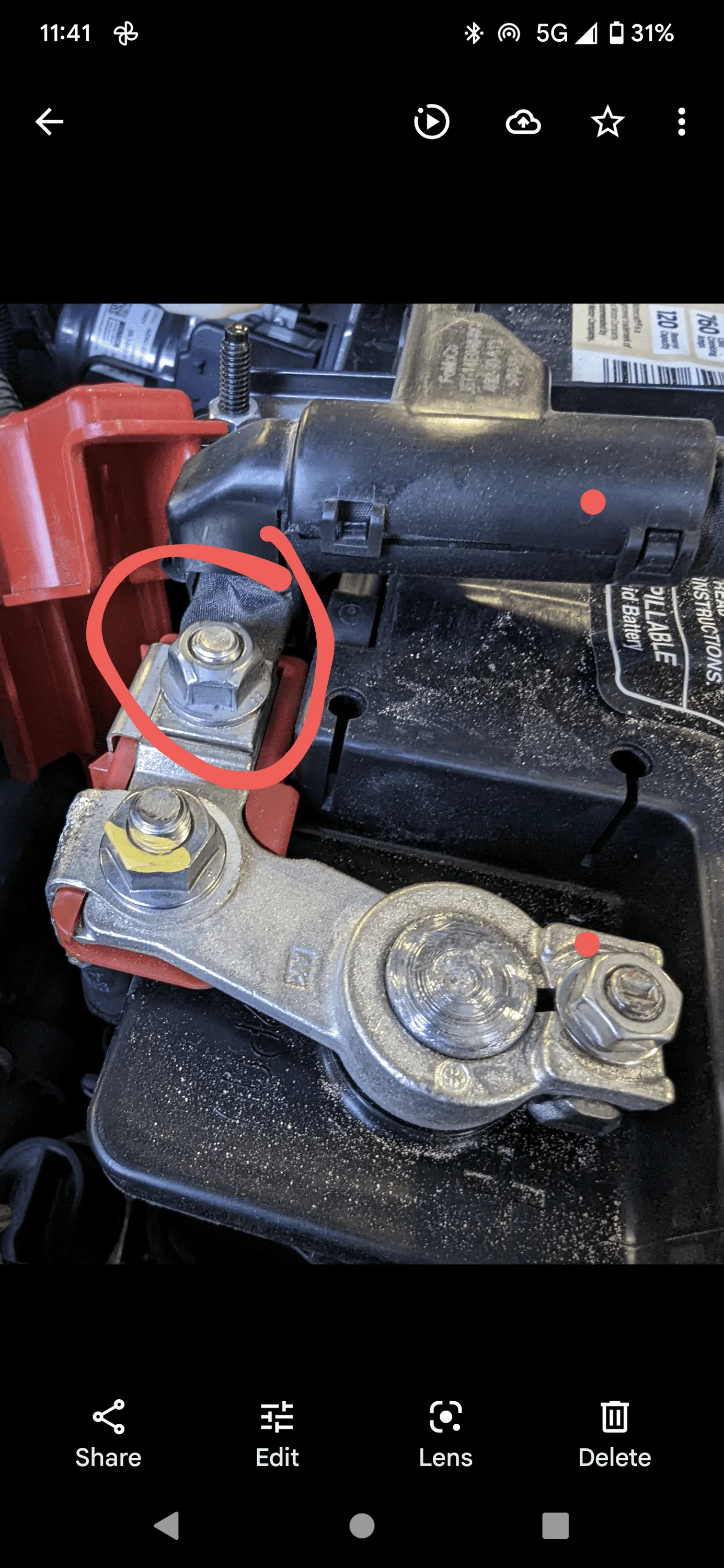

Nw_adventure
Aug 3, 2021
102
3,218
3,056
Salt Lake city
Make sure this lug connector is tight. Caused a bunch of issues for us and destroyed the battery from the factory -
Ford Maverick Low battery warning ! Screenshot_20221208-065623
