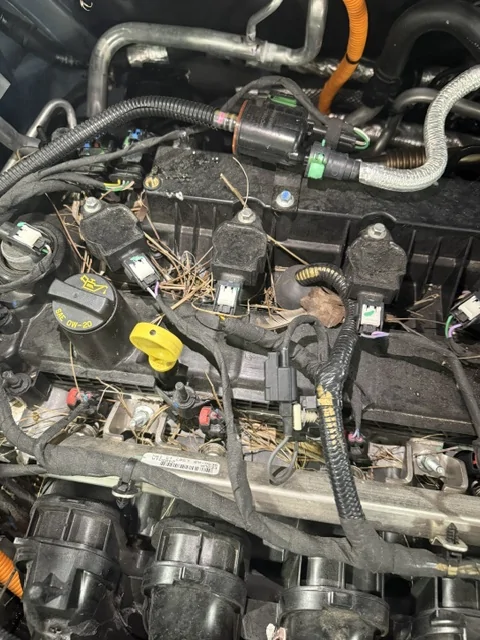

I have a 2024 Maverick, XL Hybrid, bought new (7/13/24) with just under 1 year of warranty left. A few months ago I Suddenly had start, and running problems. I see from this owners groups this is a known problem with battery issues. Mine got to the point it would hardly start, and most of the time it did start, it would then just shut off. I worried if I could drive it to the dealer to see about service, well I was scared I may loose power on the freeway, so I had it towed to the dealer I bought it from. I told them the problem. and that I had read the battery was a likely problem. My dealer, name withheld at this time, instead tried to tell me I needed a $9.000.00 wiring harness replacement due to "rodent damage" they gave me pictures to show this damage, however they were from so far away you couldn't see anything, and I do believe this was part of their scam. Anyhow there is no rodent damage to be found. I did have a bird trying to nest under the hood, and she kept dragging in straw to make her nest, but even me doing an inspection could see none of these rodent chewed wires.
Fearing a scam I had my truck towed to my personal mechanic who I do trust. He spent some time looking for "rodent damage", and all he could find was a battery that would not hold a charge, or start the truck. The battery was replaced, and viola the "rodent damage" went away. So now I am out of pocket for over $700.00 to replace a battery still under warranty, and a lot of man hours LOOKING for rodent damage that did NOT exist. The battery was used with a jumper station, and taken out and tested by them, and their battery company, and it has been found to be dead, and unable to hold a charge. I have kept the battery, and plan to allow the media to do independent testing to verify this. After talking to local news a few of them are pretty interested in a "Can you trust your car dealer" story

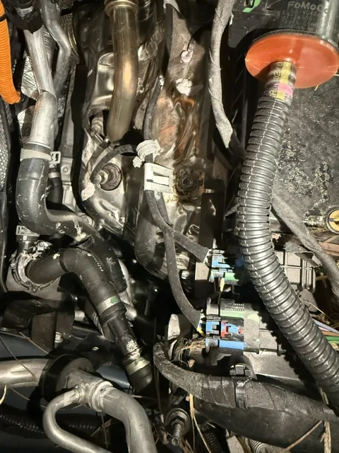

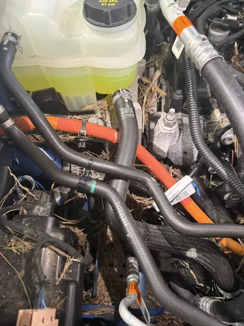

These are pics the Ford dealer gave me of the "RODENT DAMAGE" there are several, at least you can see wiring in the 3 that I am posting here, most of them there are no wires in the shot at all. What there is are pieces of straw from the bird.
Ford Maverick Loved it at first, hate it now. Ford dealer pics (9)
Ford Maverick Loved it at first, hate it now. Ford dealer pics (18)
Ford Maverick Loved it at first, hate it now. Ford dealer pics (21)

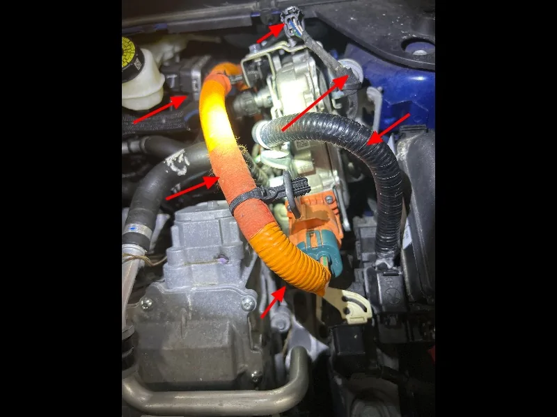

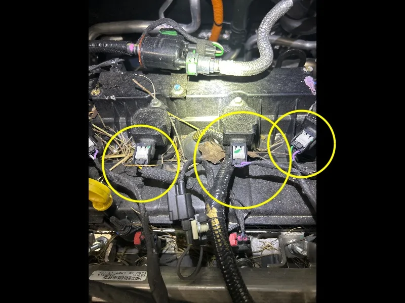

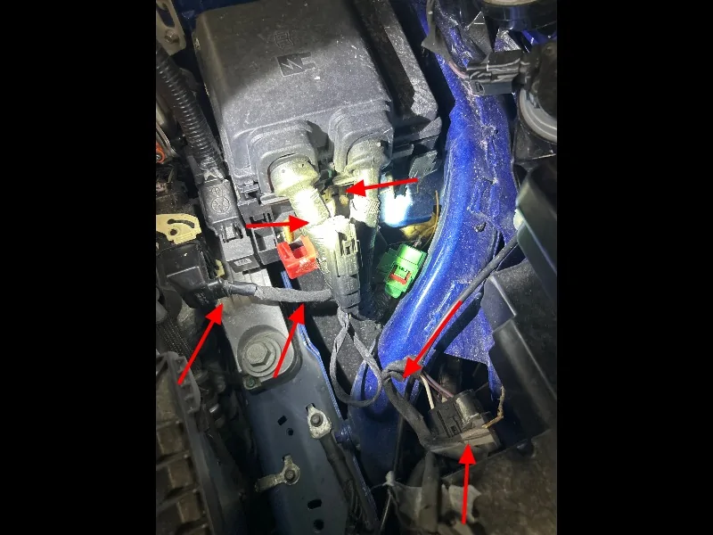

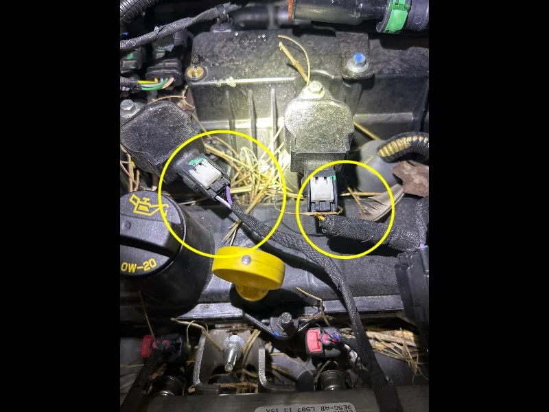

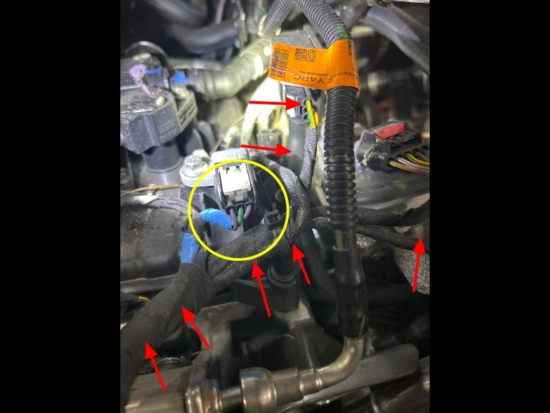

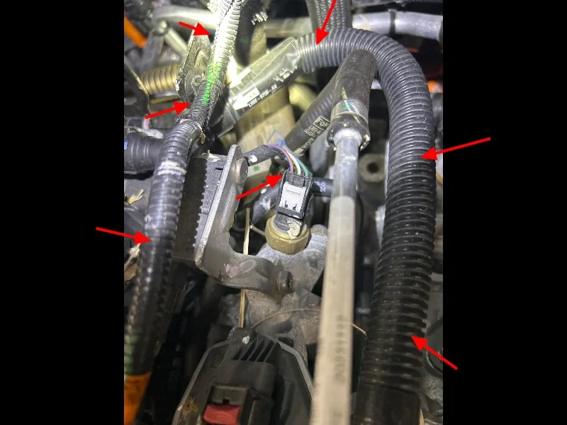

The following pics are from my mechanic, he either circled, or put an arrow to any wiring in the shot. There are several of them, and you cannot see any "rodent damage" in any of them, plus with detailed visual inspection by 2 of his best guys, they saw no damage, but after testing the battery they did find it to be dead, and it wouldn't hold a charge. New AGM battery made the rodent damage go away, amazing. Not sure what you call that where you live, but here in Ohio we call that fraud. Invented problem to sell a big money repair.
Ford Maverick Loved it at first, hate it now. My mechanics pics (3)
Ford Maverick Loved it at first, hate it now. My mechanics pics (4)
Ford Maverick Loved it at first, hate it now. My mechanics pics (5)
Ford Maverick Loved it at first, hate it now. My mechanics pics (7)
Ford Maverick Loved it at first, hate it now. My mechanics pics (8)
Ford Maverick Loved it at first, hate it now. My mechanics pics (14)
I loved this truck, then it had a problem. Had it been addressed properly, and professionally all would have been fine. After this fraud attempt I'm not real keen on the truck, even though it appears ok for now. My issue with the truck is how many $350.00 batteries do I need to buy, how often. Seems anything you may have saved in gas with the hybrid goes up in smoke with battery cost. I know one thing FORD isn't on my Christmas card list anymore, and that dealer could fall into a fiery chasm, and I would applaud.
Ford Maverick Loved it at first, hate it now. My mechanics pics (6)

1) A blower would clear all the stuffs for easier inspection if there is any damage or an air compressor w/ blow gun
If I can't start my car:
2) I would have tried jumping my car and if the jump goes through, it would have pointed to the battery
3) I would then check if the car is charging while running too after the jump to rule out the charging issue

Now I would never encourage warranty fraud - but dude, clean the straw & nest debris off your engine before the service visit FCOL. Take some clean engine bay pics before the visit (fraud cough).
All makes of vehicles won’t cover rodent damage if I’m not mistaken?

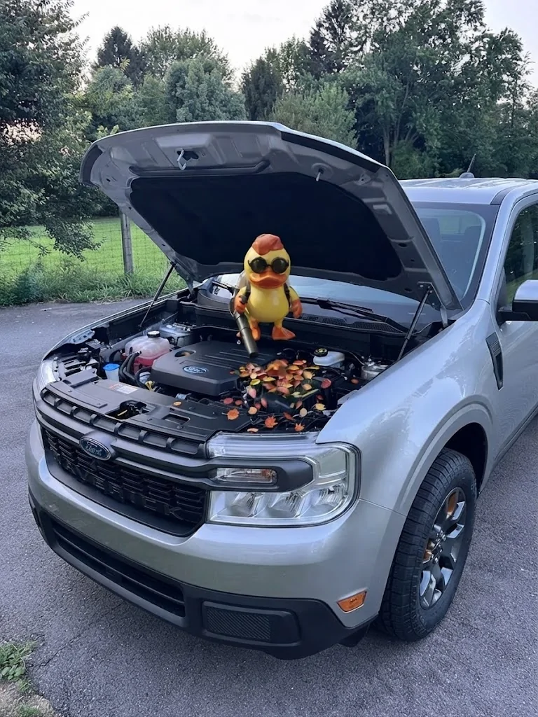

Our Maverick’s use delicious soy based wiring….
I discovered the early construction of a pack rat nest under one of my backyard prickly pears (few weeks earlier my flame coat Siamese pranced into the house with a pack rat in its jaws - I chased them both back outside). Also, the mice in my garage went next door soon after I gave my kitties full access to garage.

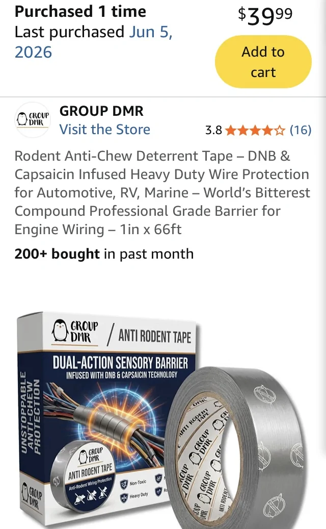

Anyway, I recently purchased some automotive anti-rodent tape to reinforce my harnesses etc. Still procrastinating - but if a had a Hybrid my Maverick would be smothered in this stuff. Expensive for tape - but cheap insurance!
Ford Maverick Loved it at first, hate it now. IMG_0684
Ford Maverick Loved it at first, hate it now. IMG_0685
