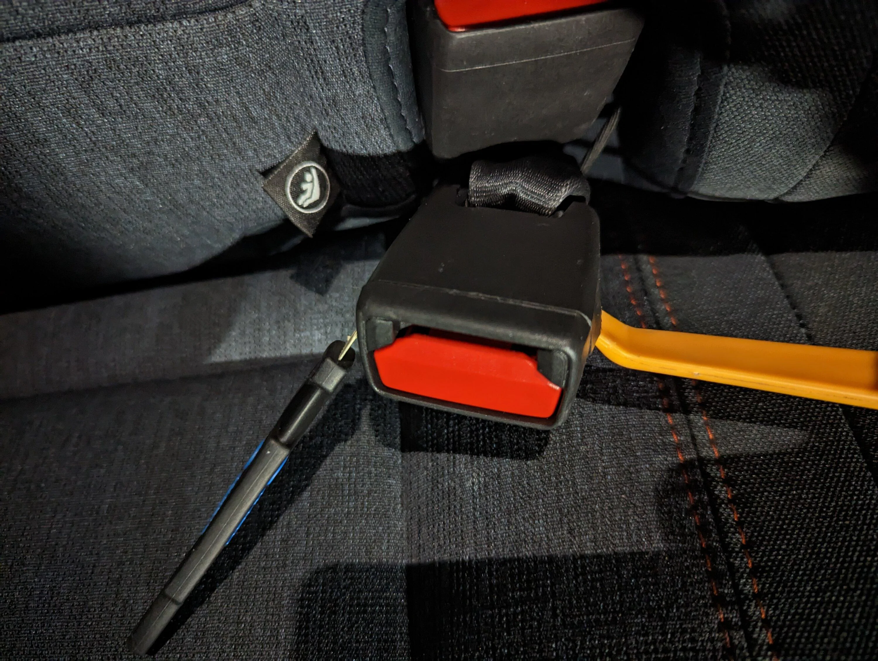

Warning, it can be a destructive process, if you do attempt this, it is recommended to attempt on the rear seats first because they're harder to remove but easier to replace. So here it is:
Step 1: Open the seatbelt buckle
- The seatbelt is held together by sliding into place at the top of the buckle (red button side) and has 2 permanent plastic pins at the bottom. So the only way I figured to get it open was to pry at the seams perpendicular to the buckle on both sides till the plastic was forced out of the top.
Ford Maverick Love my Maverick, but it's annoying to use for Uber PXL_20230401_161539506
- Once the top is out, you can try to save the white tabs by gently wiggling the bottom upwards, however you most likely will break the white plastic tabs. That's fine, I just glued them together, but if you can save one, it helps put it back more securely.

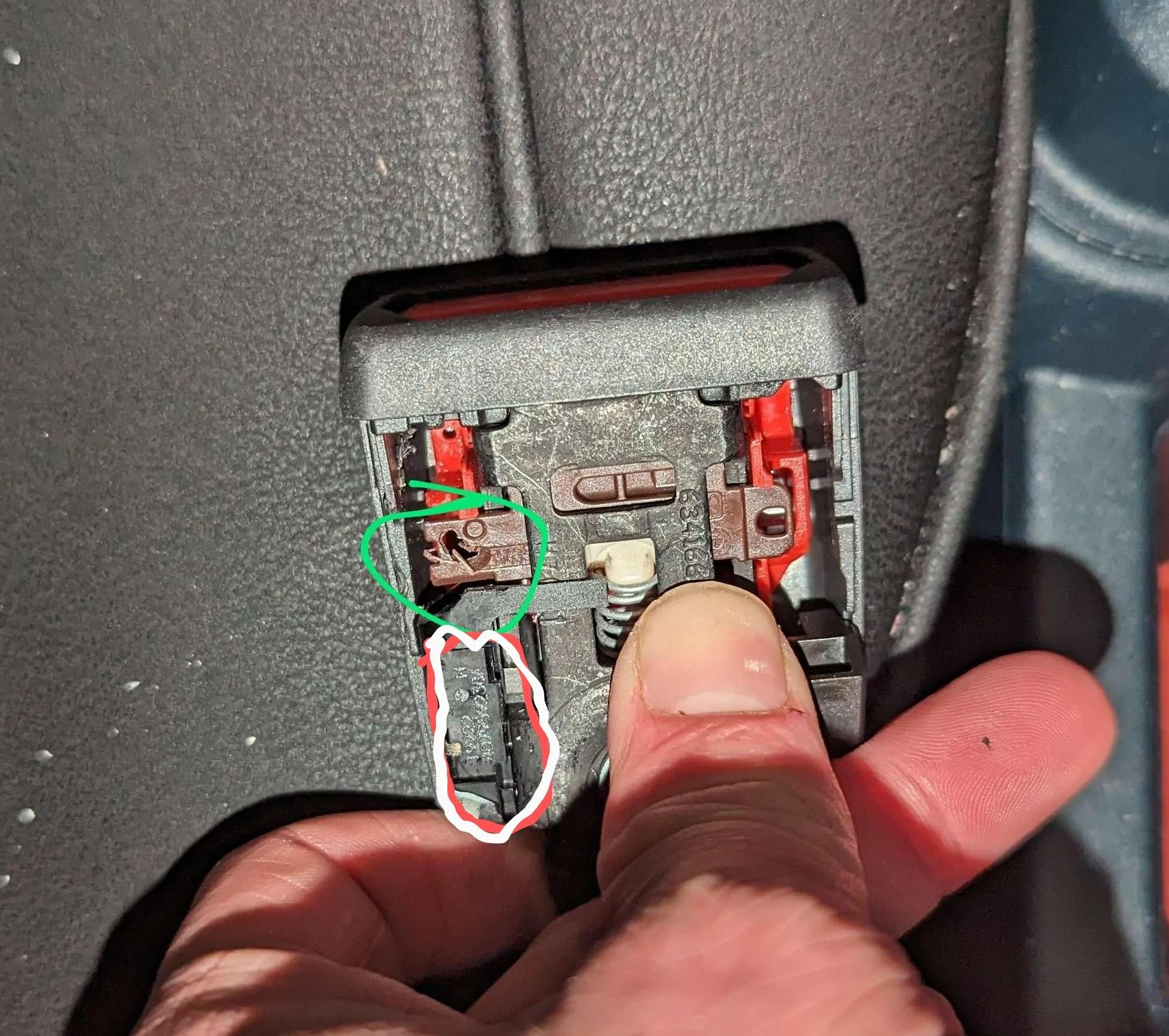

Step 2: Making the seatbelt permanently "buckled"
- How the system works, is there's a metal plunger on one side that dips into a contact, when it makes contact, the seatbelt is buckled! So all you have to do is drill out the rivet to drop the metal plunger into it's contact.
Ford Maverick Love my Maverick, but it's annoying to use for Uber PXL_20230327_2337437072~3
- The green is where the plunger is riveted in, and the white/red is where it drops into to activate.

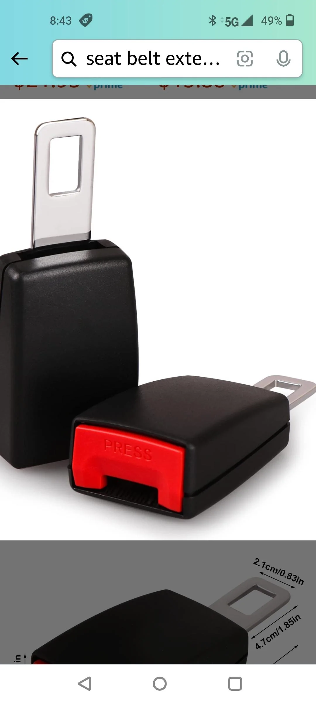

Back in post #24. How is this not simply the best of all worlds? I feel with this you can deactivate all reminders and use your seatbelt and it does not modify your truck.
I've had them before, they broke within a year (not quite what you want from a safety device). They also don't feel sturdy when in the OEM buckle, and whenever I had passengers they would more often then not just unplug the OEM buckle anyways so this would come out with the belt. They're fine for if they're seldom used, but I personally wouldn't use them again.
I was poster 24.
I've had these for 3 years now in both my car and my F-150. They are used every single day and not one has ever failed. Only twice has someone unbuckled the oem buckle.
These are solid and I'll use them in every vehicle I'll ever own, including my Maverick if it's ever built
