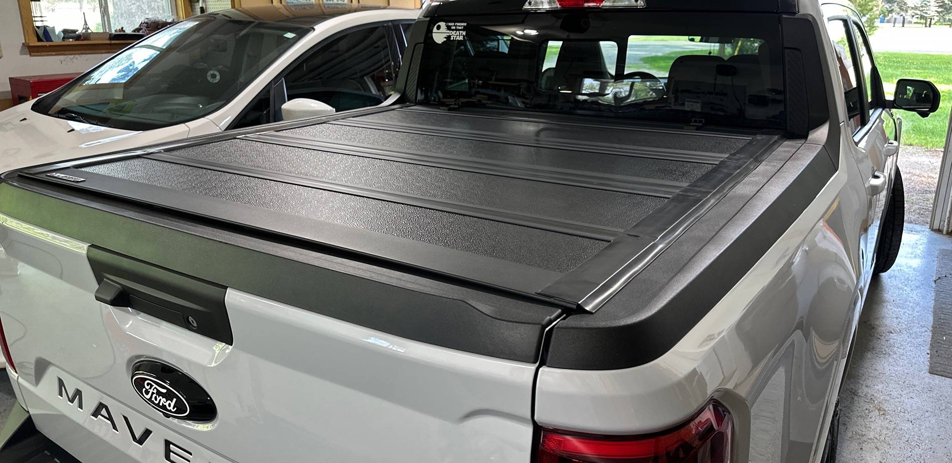

Got mine today and installed in high heat and humidity. Don’t care if I have heatstroke - it’s awesome!

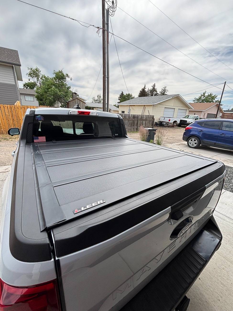

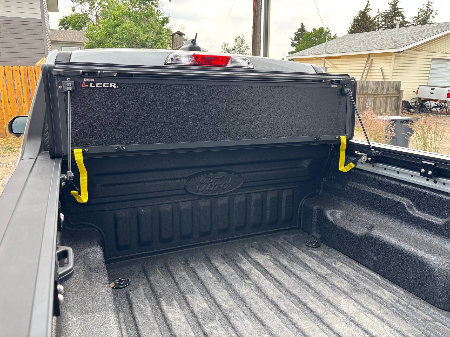

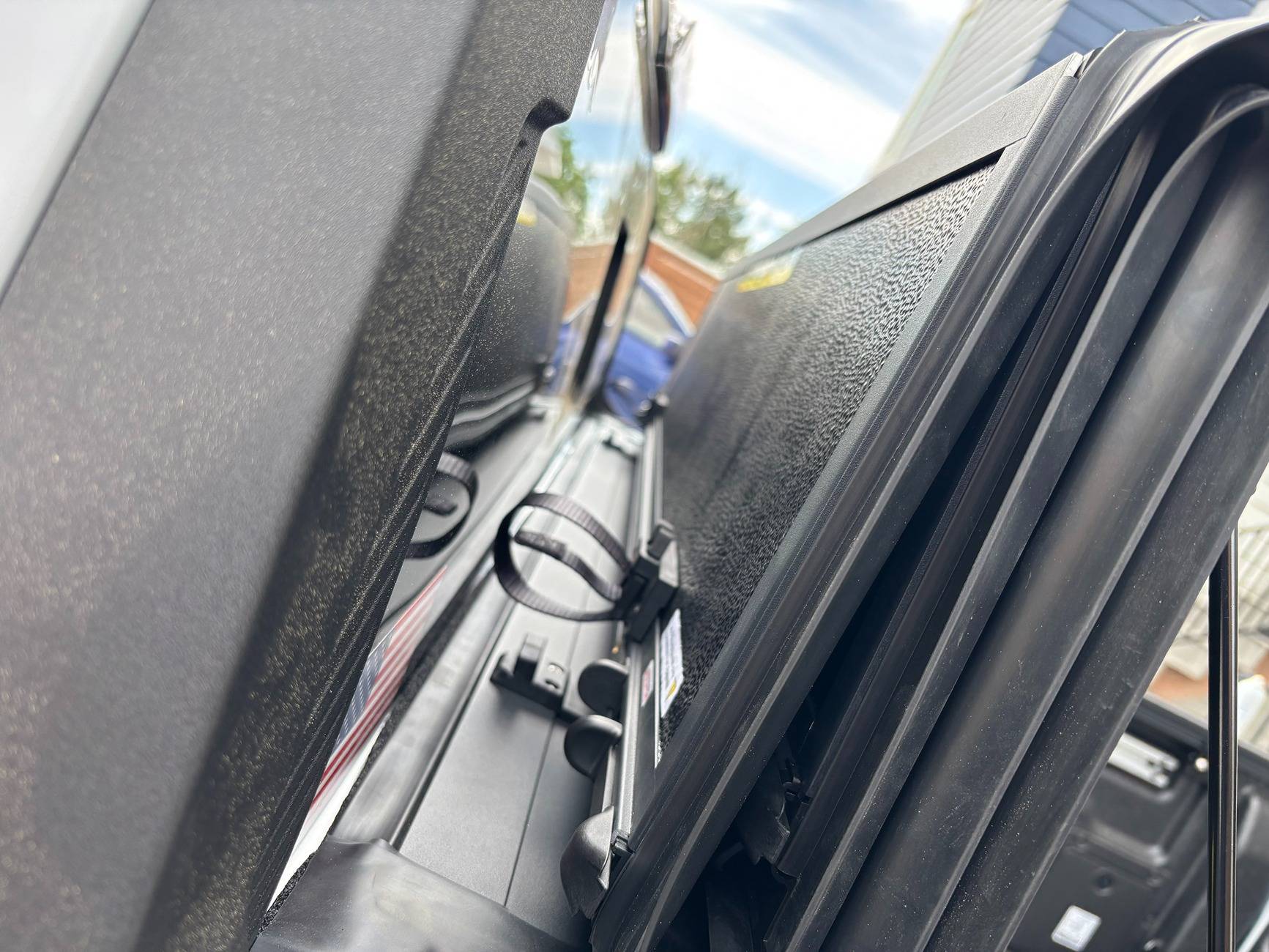

Installed mine today... What a pain in the butt to align it so the latches lock on each side.
Maybe it's just my first time ever installing one of these, it took me maybe 20 minutes to get the cover onto the rails, and then an hour of fiddling with the latches and centering the cover.
It seems each side of the latches that lock the sections to the side of the bed, have almost no wiggle room on each side and must be PERFECTLY centered to within an atom or two.
Just ever so slightly off center? only 1 side latches, breathe on opposite side ... now both sides latch, tighten the knobs to lock the back of the cover to the bed... 2 out of 3 panels lock on both sides... rinse and repeat.

I hear ya on the alignment thing. I think I cheated a bit as I didn’t align the cover off of the front of the bed (bulkhead). After getting it unfolded, I let the tailgate push the seal and hard plastic clips to align the cover. That seemed to work good for me….

Eventually I was able to get it. I pushed it far enough back that that the corner seals just touched the vertical plastic pieces on the side of the back window, tightened the knobs enough that they would hold the cover firmly enough to the rails, unfolded and shifted it it slightly panel by panel until all the latches locked on each side then folded it back up, and tightened the knobs little by little on each side - everything locks now and I can open and close the tailgate while the cover is closed and locked with no issues.
then i doused it with 303 and called it a day.
