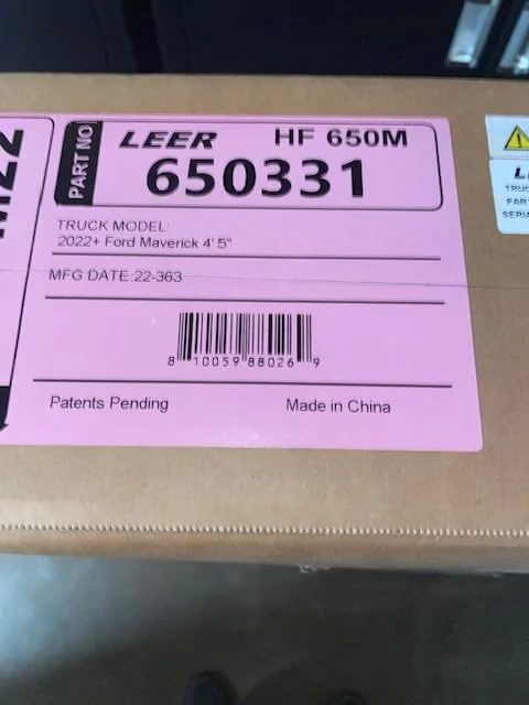

FYI the box mine came in had tag on multiple sides that had the model number HF650M Made in China on the tag

You might want to check out the reviews on Amazon's site, as one shows a photo of the package saying "Made in China". Wondering if that's how they were able to come down about half their previous price???? Still shows in the description that it's made in USA, is it really?

Leer has just expanded and is moving stuff around. Some versions of covers for some trucks are half price. It's possible that those that are on sale may be overstock or possibly were made in China prior to USA production. NOTE production date on pink tag shows 22-363 so must have been made on the 363rd day of 2022.

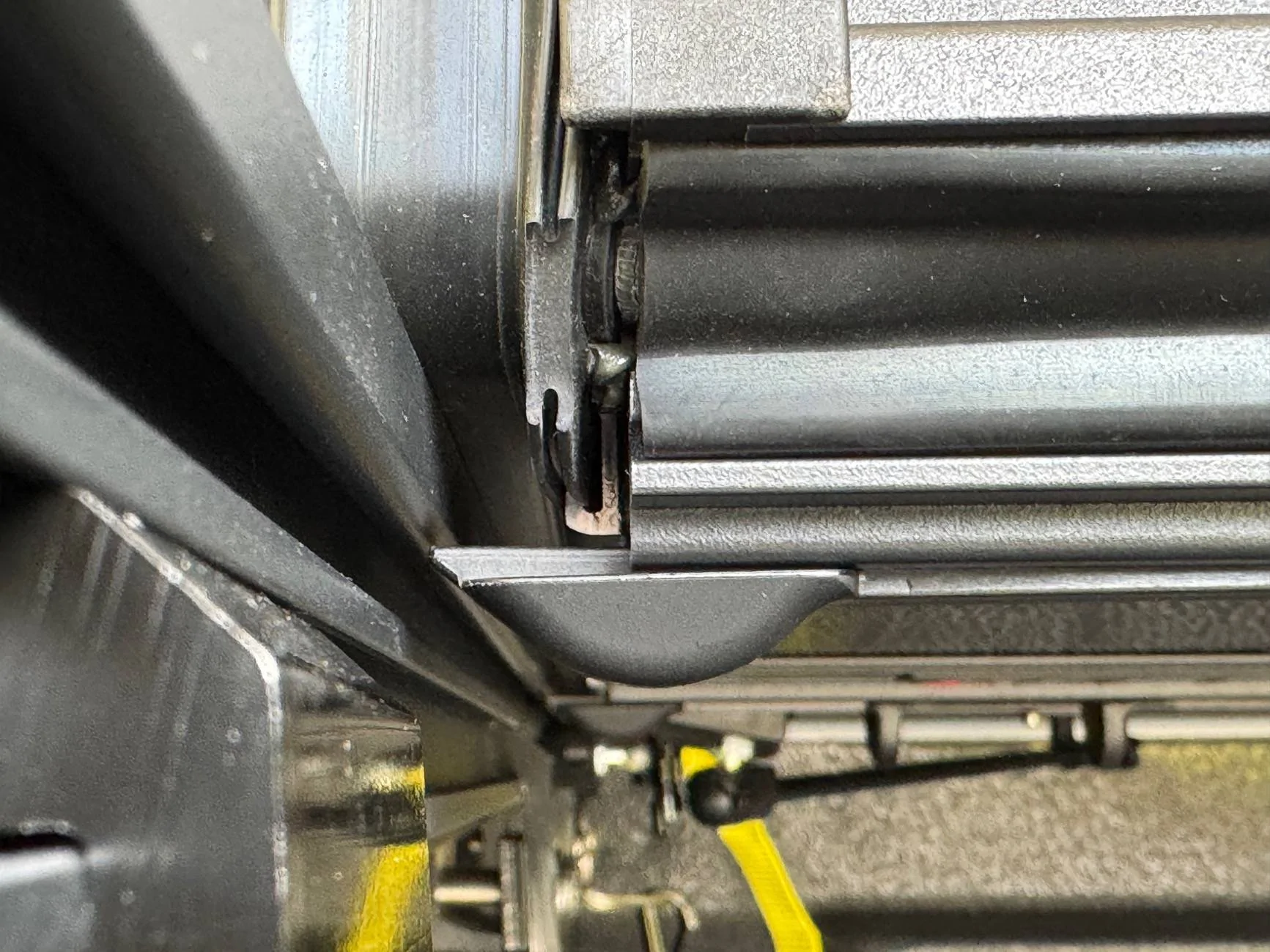

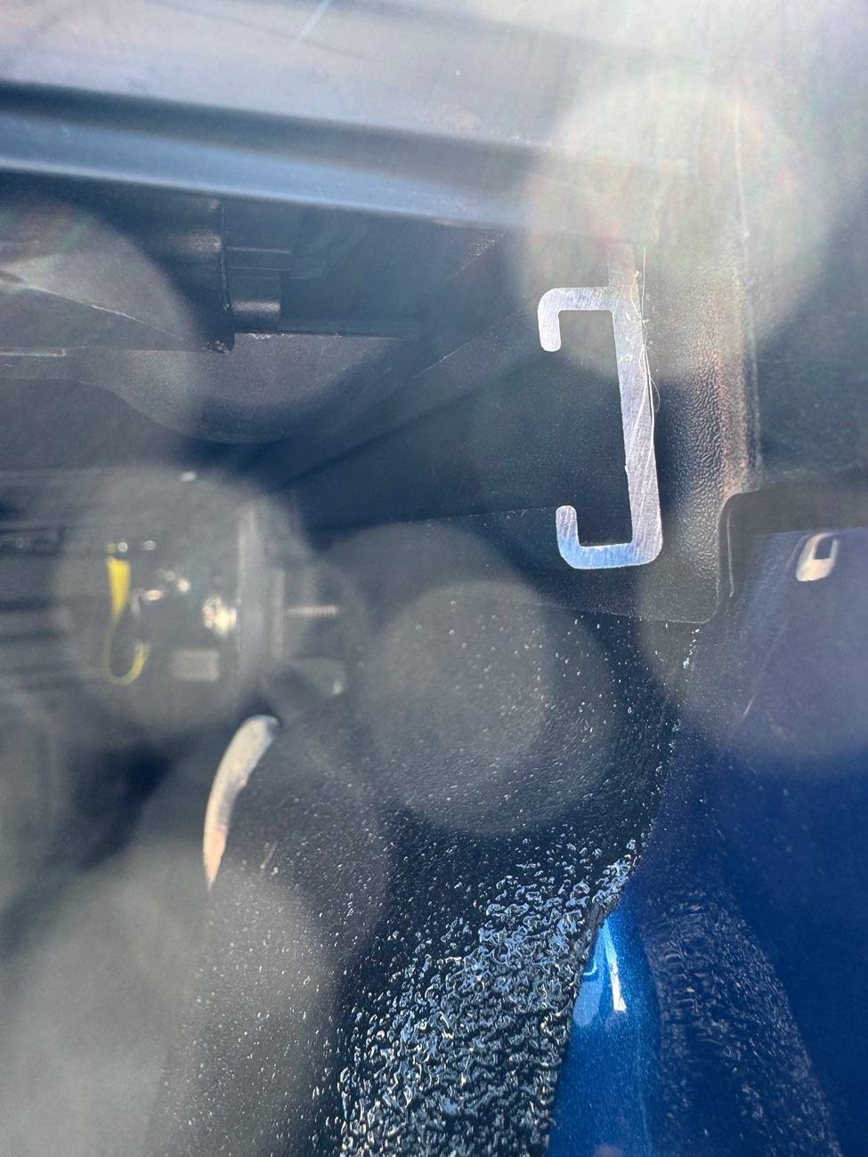

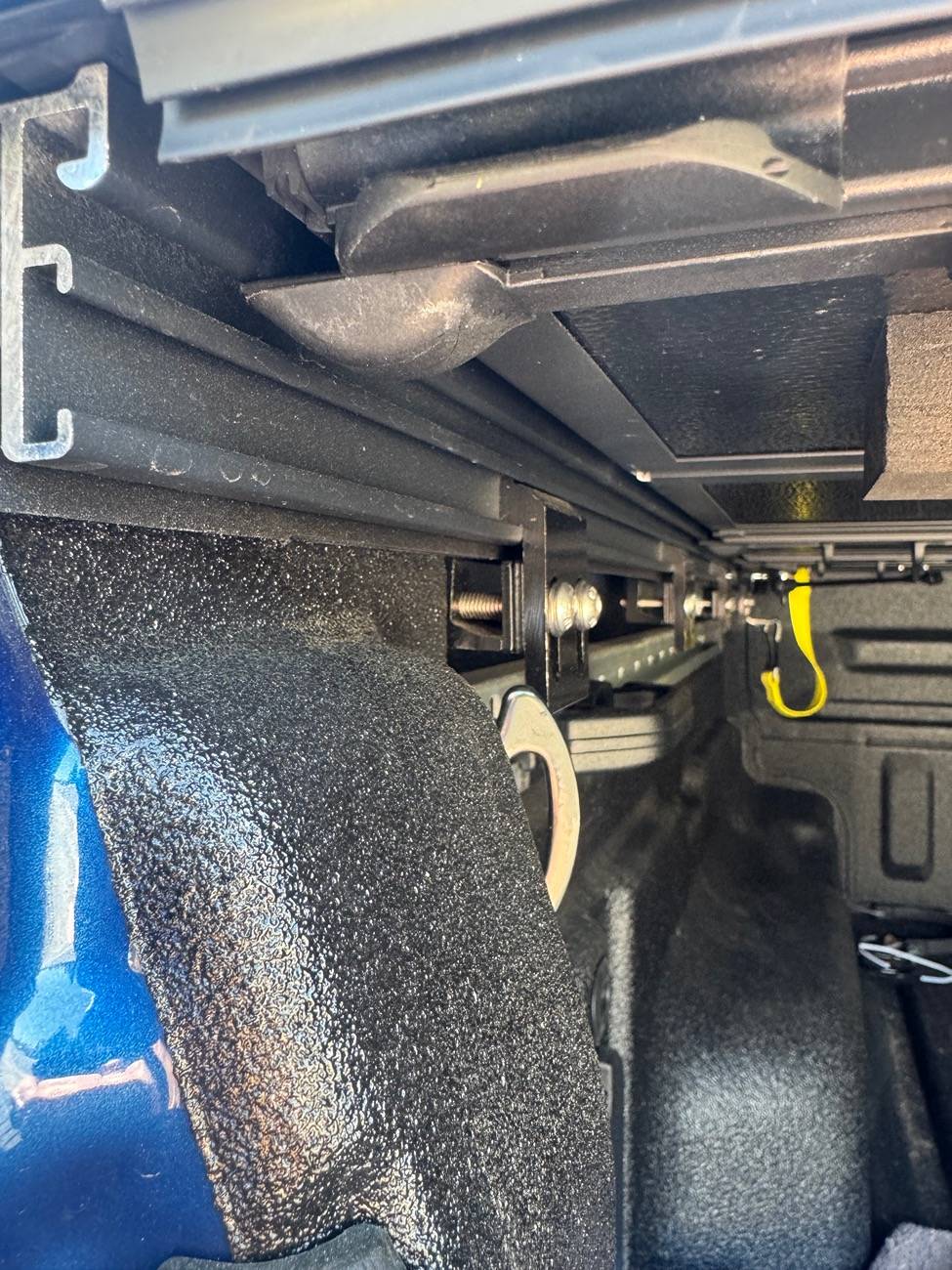

I have installed the Leer cover and it is pretty easy. The problem I am having is that the cover does not latch to the rails because the rails are too far apart. This is the same for all sets of latches no matter how I have squared it. Is anyone else having this issue and if not, could you do me a favor and post a picture of a latch and how far it goes under the rail?
The attached photo shows how far the latch extends under the rail and it’s like this for all the latches. The latch is fully extended. It is as if I will need a 1/16”- 1/8” spacer to push the rails inward into the bed so that the latches can slide under the rail.
Thank you in advance!

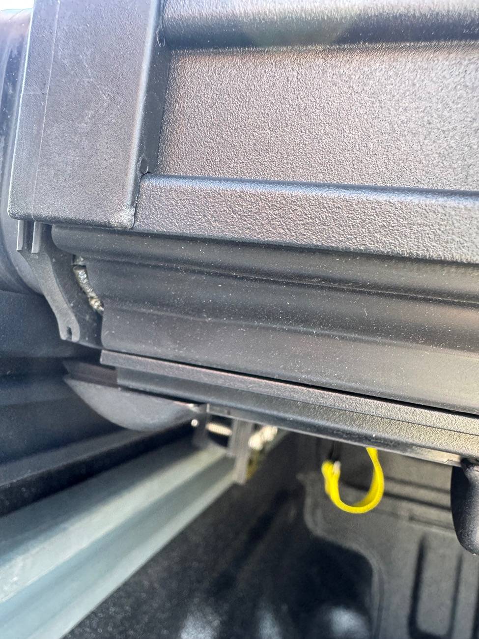

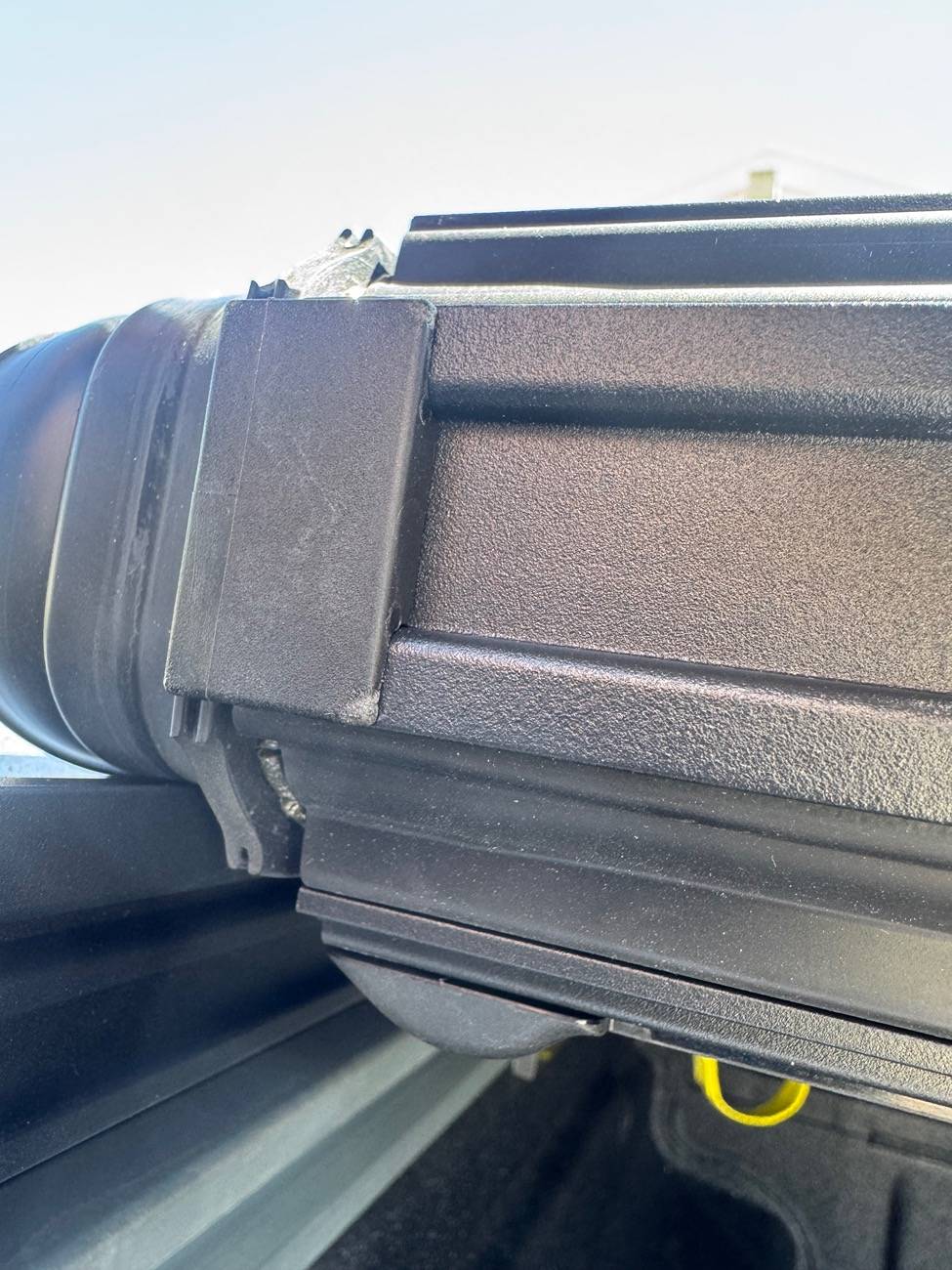

Took a couple of pics & verified my cover latches on both sides at multiple folds. On original installation one side didn’t, but I just squared it up 1/8”.

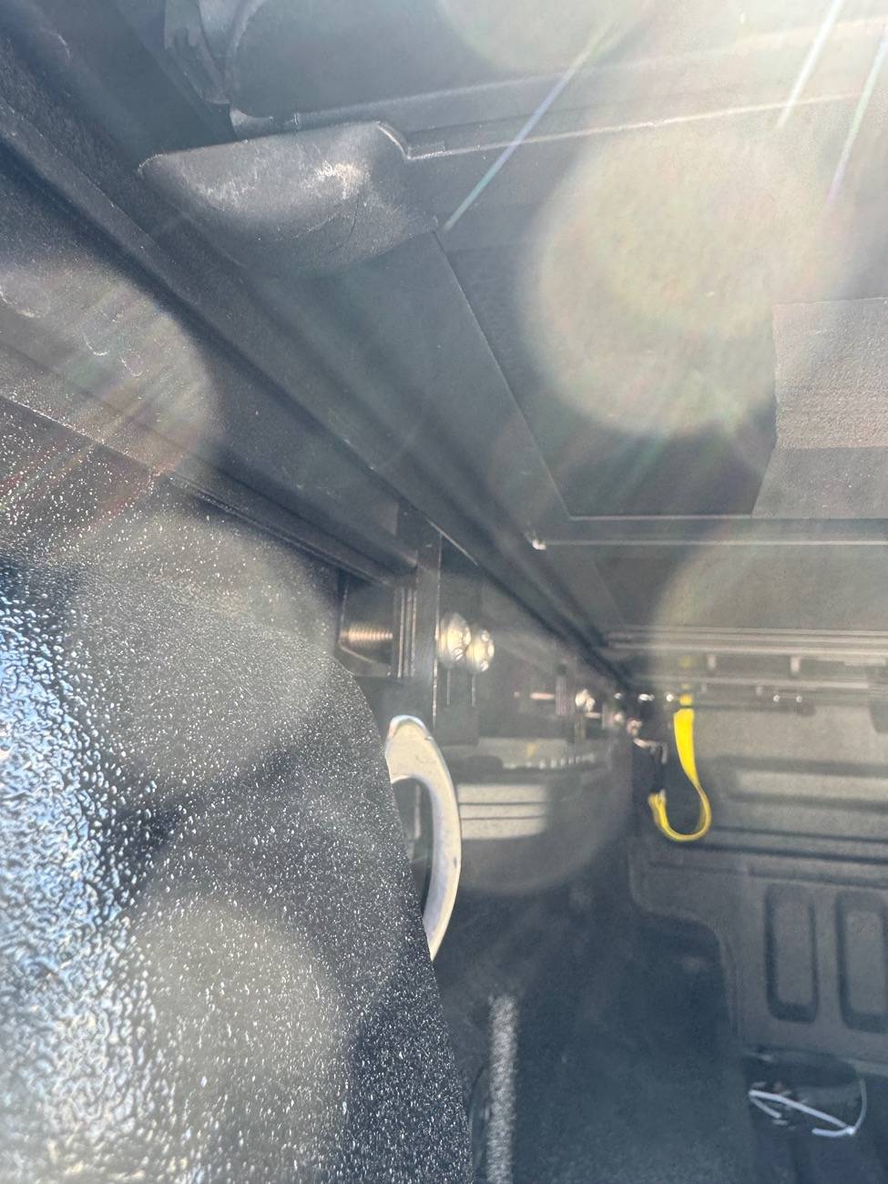

Thanks @Rcrew . None of the latches engage so I slightly adjusted it so that at least one of the rear ones engage. From your picture, it looks like the rail does not sit flush against the black plastic cap on the bed. Did you use a spacer? How did you get it to stay square?
Mine is currently installed flush (see attached), but that the top of the rail really needs to move inwards more.
