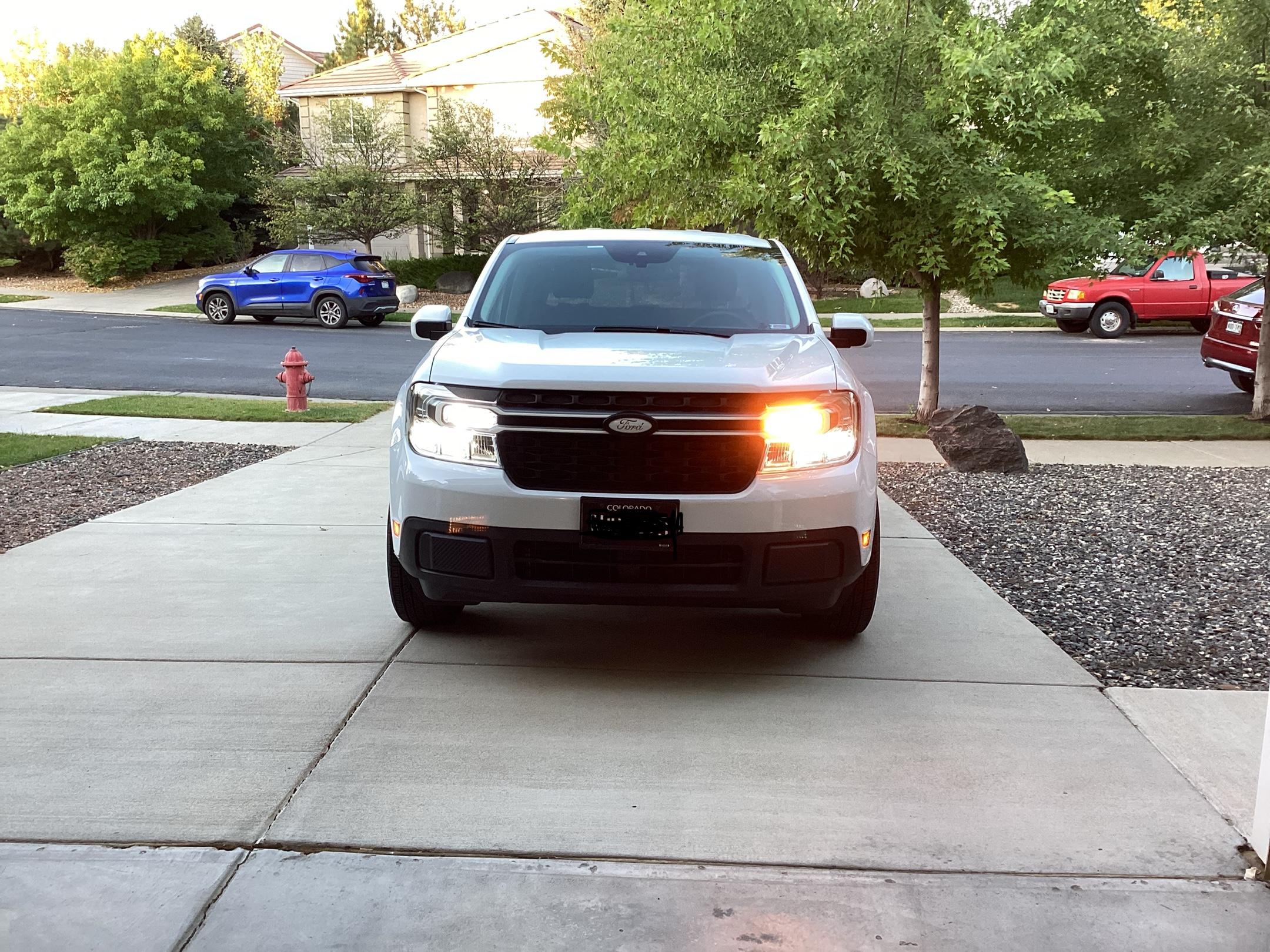

Update:
I purchased the new, improved front turn signal units.
They are supposed to be much improved in solving overheating/ hyperflashing.
So far, so good.
My old ones started hyperflashing after 2 - 3 minutes.
I tested the new versions using my flashers.
They went 5 minutes without hyperflashing. I didn’t test them longer than that. I haven’t had them hyperflash during regular usage during the last month of changing them out.
I can’t see any brightness difference between the old and newer versions, they look the same to me.

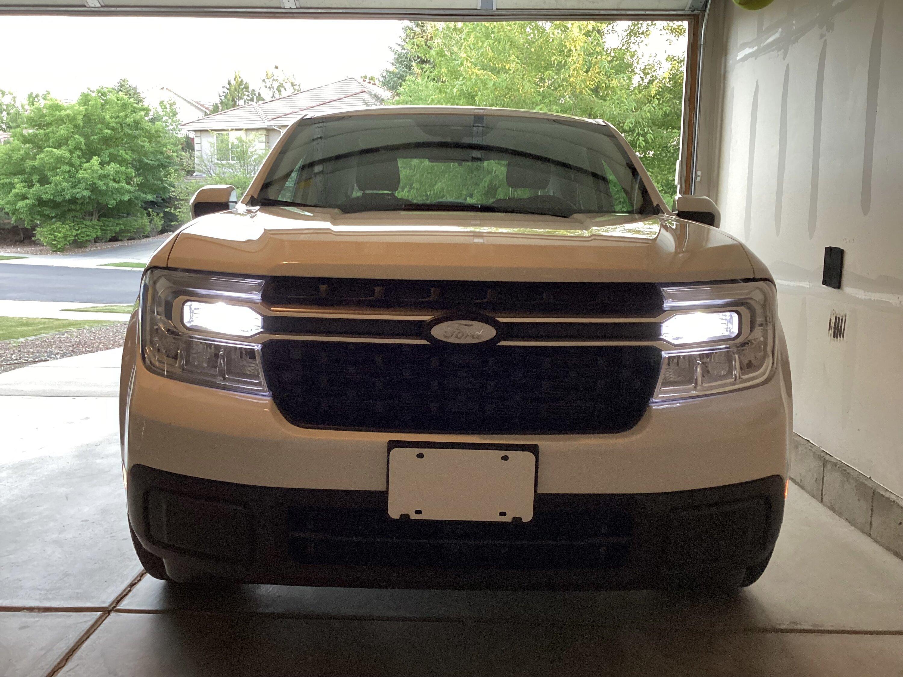

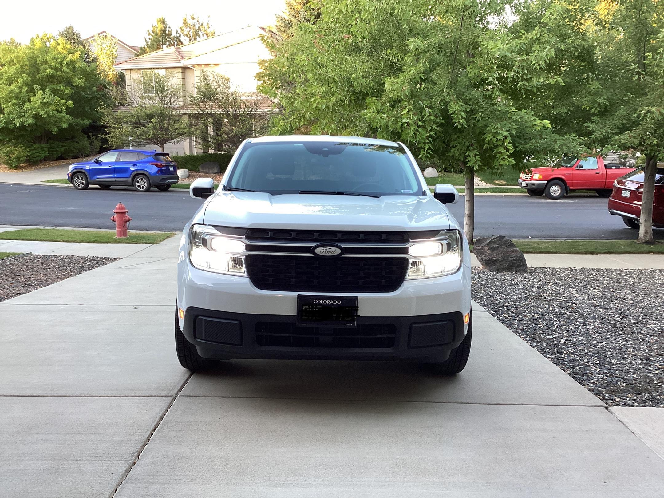

They are white when not blinking, and a lower lumen as well, so I don’t think heat is an issue when running at night.
I hardly drive at night much, maybe more as it gets darker this winter.
I have had several occasions lately where I had my turn signal on for well over the length of time that my old versions started to hyperflash. Looks like they solved that problem.
The running lights, headlights/ running lights, and turn signal flashing
