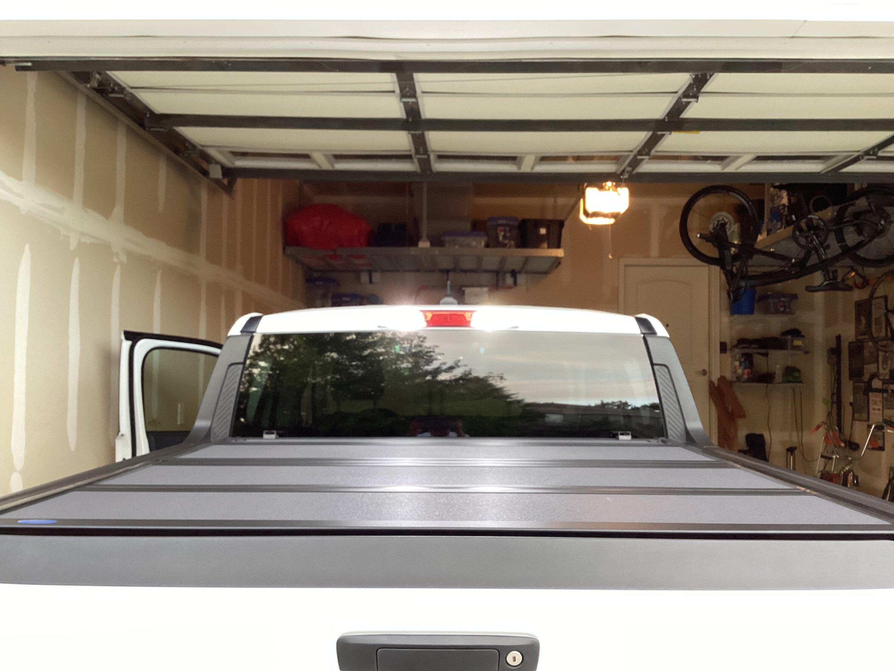

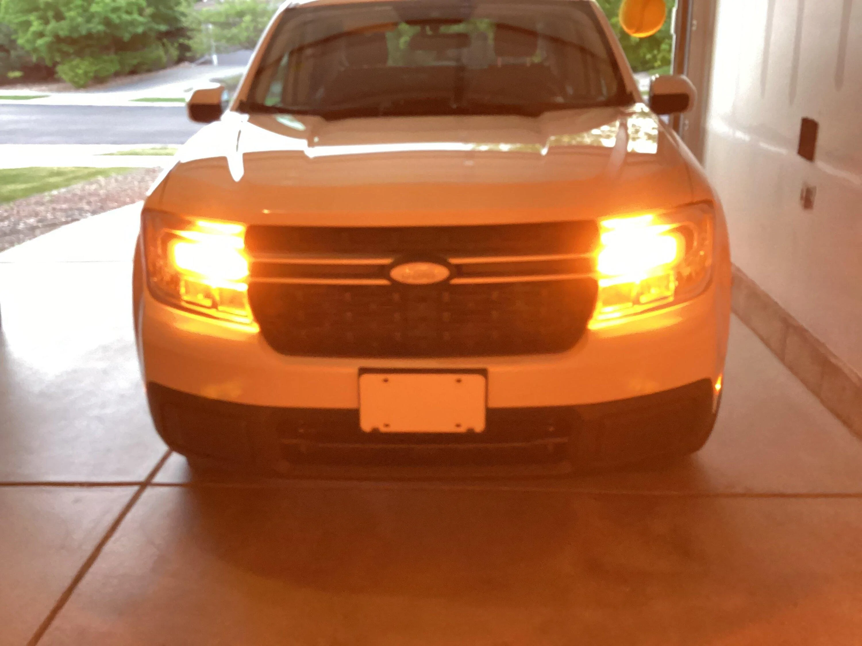

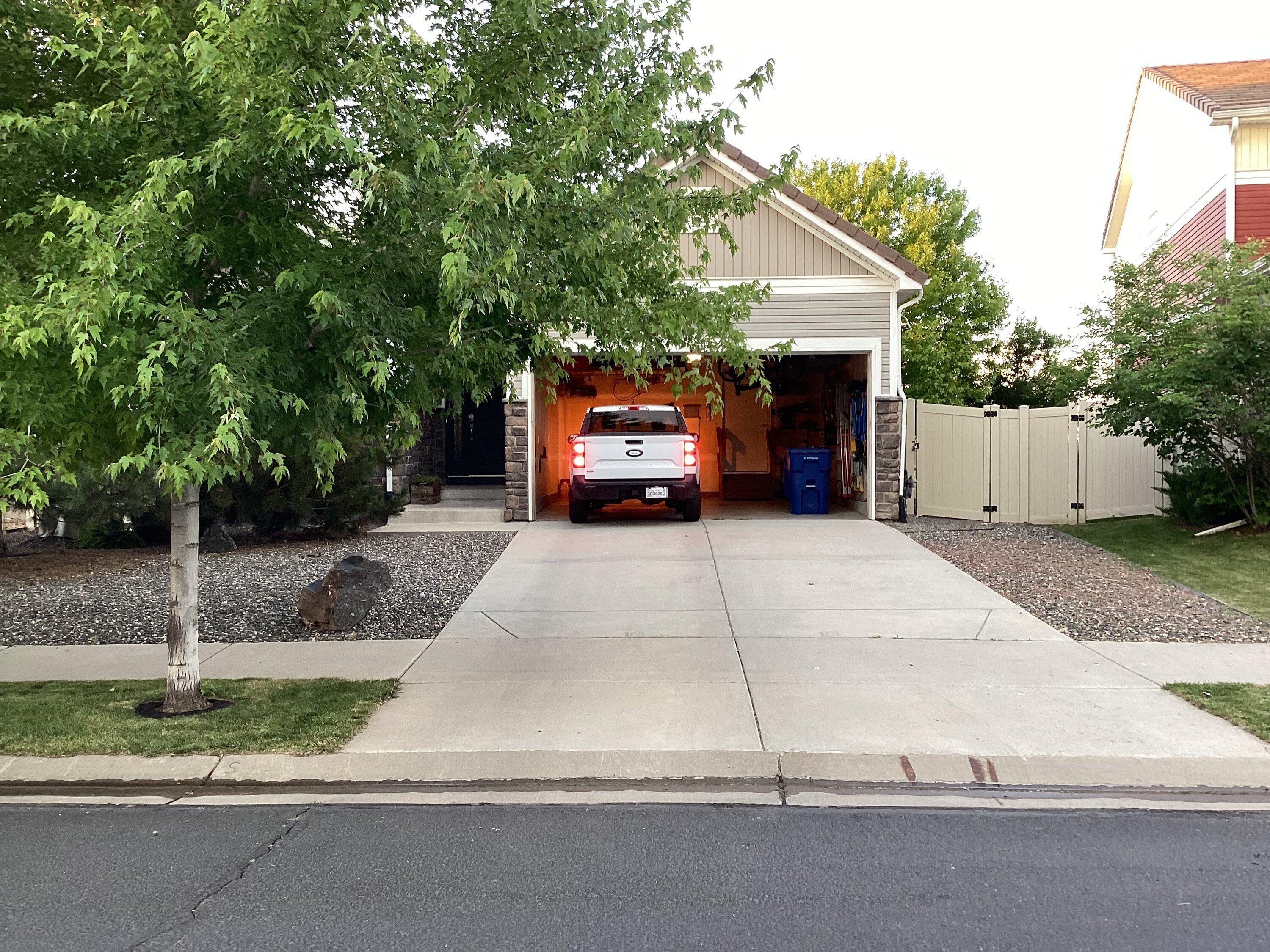

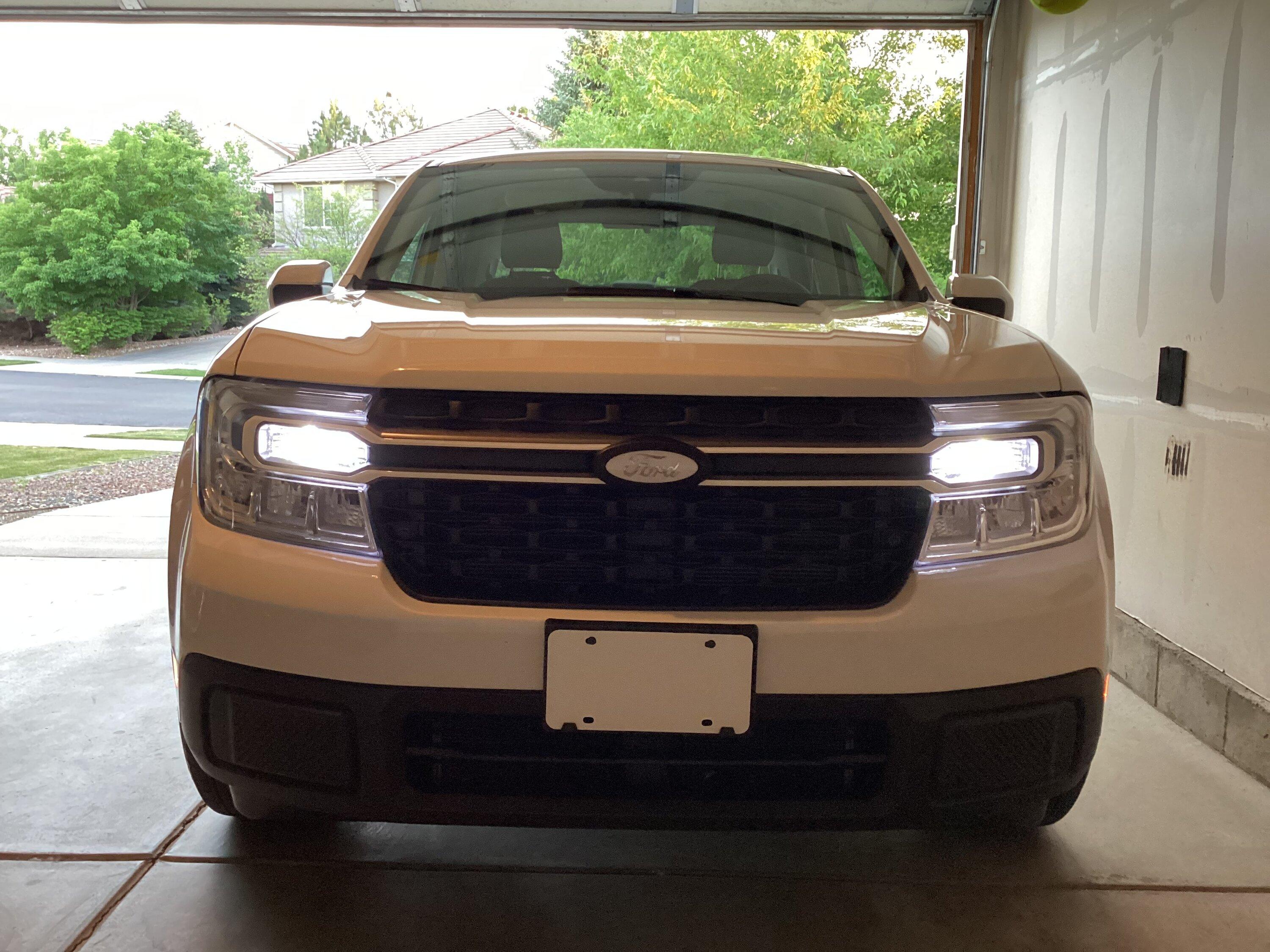

People will definitely see my front turn signals during the day. I always signal, and I hate it when other peoples turn signals are so dim that you can’t even see them. (At least they’re trying though)
The change to a white running light instead of the yellow is an improvement IMO.
The tails wont melt your rods and cones but can be seen much better during the day compared to the halogens. The camera overexposes the brake lights, they aren’t white/red like the photo shows, just bright red, without the halo.
The backup and cargo lights are much better, I can see what’s behind me now.

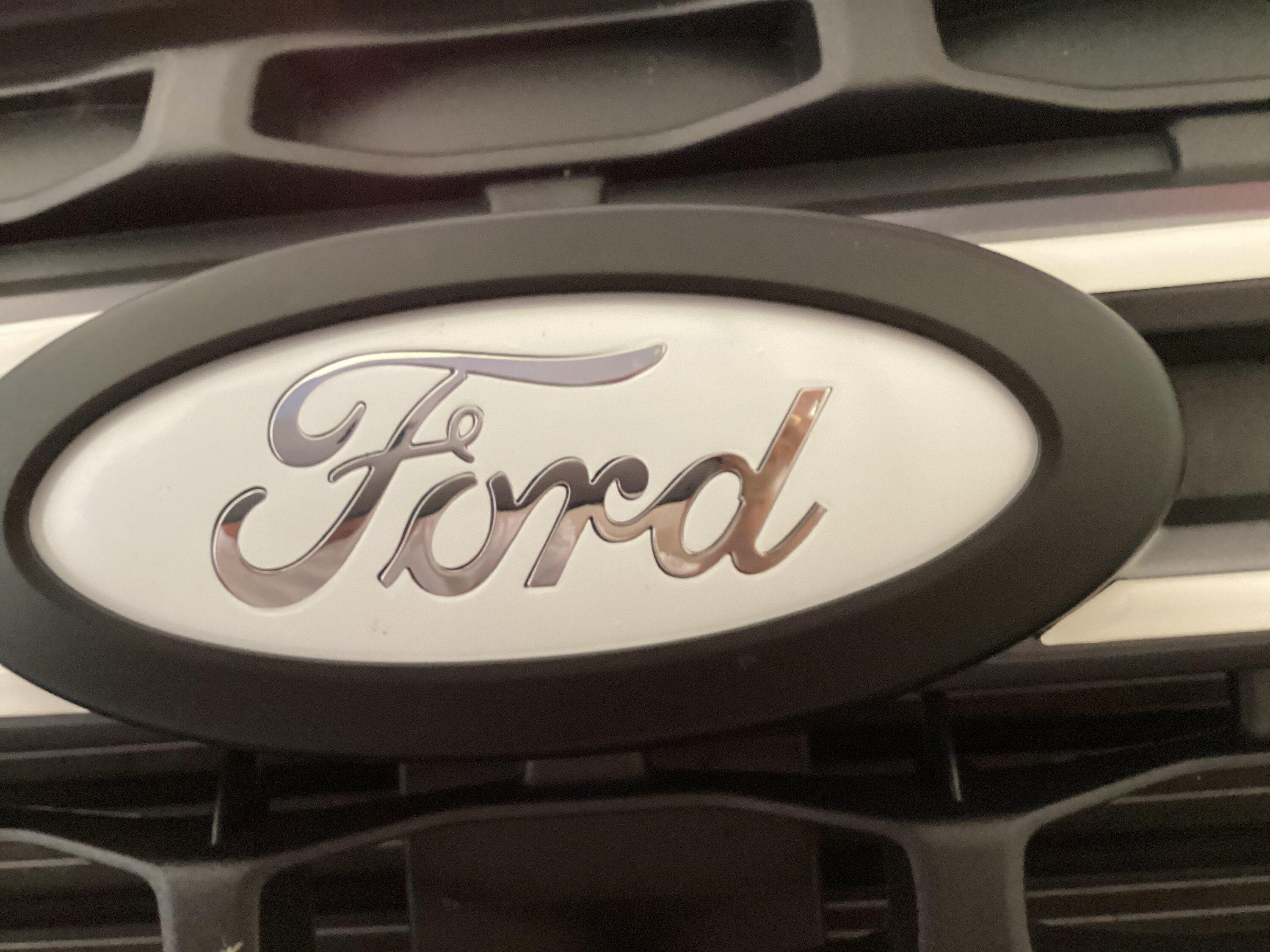

A few have mentioned the silver ford emblem.
It just the stock silver script on the Blue Oval with a white overlay decal and
Ford Maverick Lasfit LED upgrade with pictures IMG_0212
a black cap over that.

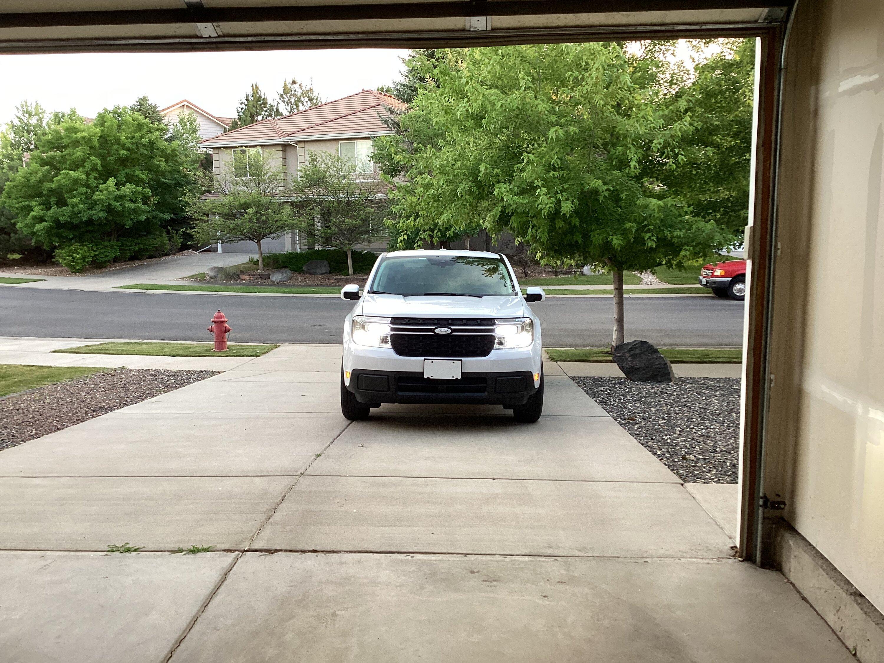

Just observed my lights in the daytime.
Looked at them from about an intersection away, offset about the same as the opposite lane would be.
Did the same from the distance and angle a stop sign would be.
Definitely not too bright and definitely more noticeable than the stock halogens.

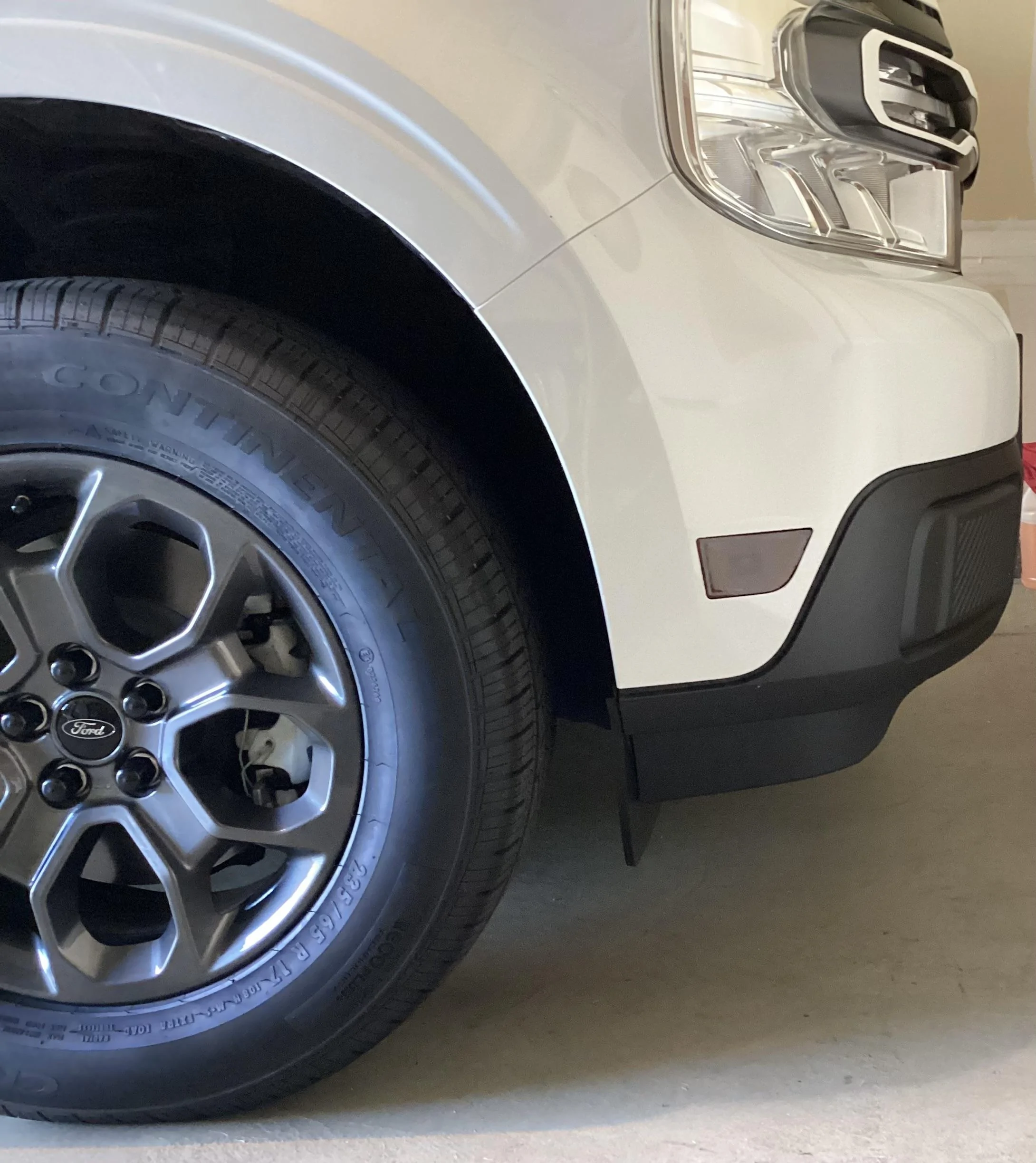

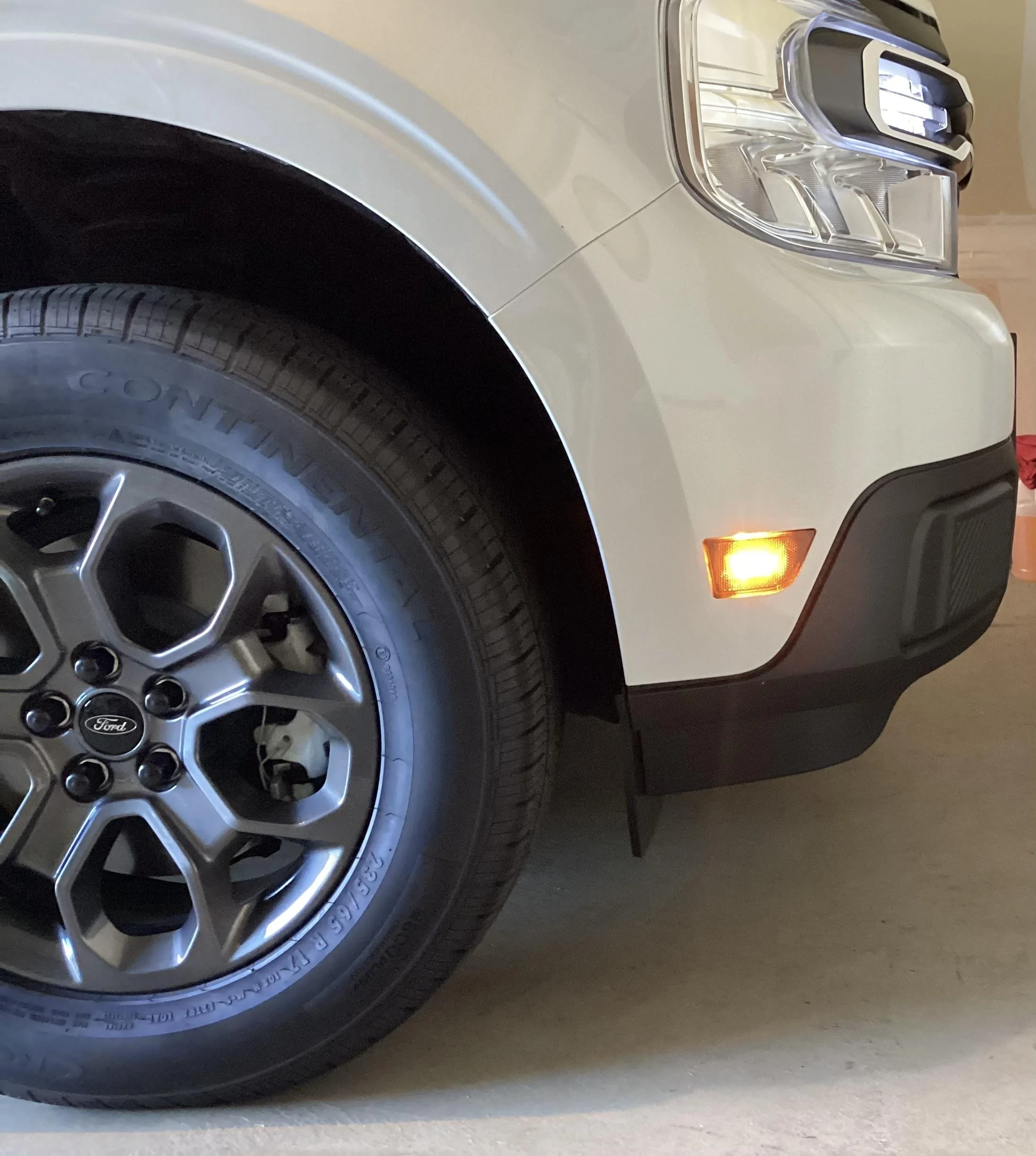

Bought some of the newer front turn signals and some side marker leds.
I don’t think the new turn signals are any dimmer or not. I was going to take a comparison picture with the old and new ones but I honestly couldn’t see any difference in brightness.
I bought them to avoid the hyperflashing. Haven’t used them much yet but I will report on them later.
Since I found out that you don’t have to take apart the under body panel, or fender well liner, to replace the side marker bulbs like one of the members here told us we had to do, (I don’t listen to him any more), I bought some led side markers.
Popping out the marker was easy. These are much brighter than the incandescent bulbs.
The smoke tint I have is pretty dark. These led bulbs light them up very brightly now.
