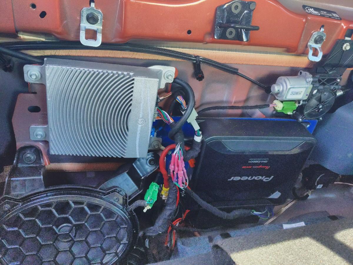

With or without Luxury Package? If without you can cut out the vestigial B&O amp bracket and it'll fit there easily as others have done.
Probably could also fit below the motor/regulator but would require moving some items. The proximity key sensor that mounts to the triangular bracket below the sliding window motor/regulator can be relocated to the reverse side to give some extra room and remove the extra sound insulation pad in the rear seat pouch (I stuffed it behind my amp plate against the vent it's designed to be muffling in the first place). I also needed to shift my roadside assistance kit, but that was mostly just due to poor planning ahead on my part.

Point being those installs are located with plenty of room for the regulator which is much closer to the center seatbelt cover.
Not a Hideaway but here's my amps fitting even with the B&O and OE subwoofer.

I know we're off topic, but are you running your B&O sub at the same time you've split the speaker input into your pioneer sub amp? I was going to disconnect my B&O 6x9 but curious what you think of how this sounds. I guess I could tap into it rather than cut the connector off, and then try it with and without the 6x9...

Yes. My figuring was even if it doesn't deliver a lot of output the OE 6x9 can still do work filling response between the door 6" speakers and my 10" subwoofer.
