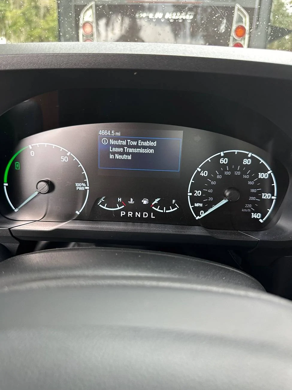

We have flat towed our Maverick several times behind our RV with no issues. Recently, after driving our Maverick normally, when we turn the ignition off we are getting the message “Neutral tow enabled. Leave transmission in neutral.” This is after normal driving of the Maverick when we put the transmission in park and turn the vehicle off. The Maverick drives fine, but receiving this message does not allow me to put it in actual tow mode. Has anyone else run across this or know what may be triggering this?

Yes, been covered in several threads, just have to search for them. The search function can be iffy. I had that happen once because I did not follow the proper sequence to take it out of tow mode. I fixed it by disconnecting battery cable, drank a beer, then reconnected battery cable. It was my fault and to prevent this from happening again, I printed out the tow mode procedure on a 5X8 card, laminated it and put in glove box. I also printed the procedure for starting and running the vehicle at the appropriate times. No issues in last year and a half! Good luck!

I had the exact same thing happen to me on our last RV trip. As Dave said, disconnecting the battery for 10 or so minutes apparently resets the computer controller for the neutral tow setting. No problem since then. I have flat towed the Maverick close to 15k without anyother problems.
