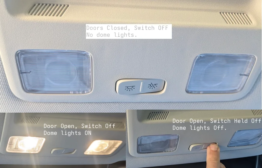

Thanks, I found that, and made sure I was reading/seeing it right.
I have mine pressed into Off, like I marked below.
But the lights do not stay off.
If I push it slightly further into 'Off', they do turn off, but requires that I hold that bit of pressure on the switch. Which doesn't seem right at all.
Ford Maverick Issue: 2025 front dome light switch doesn't seem to work quite right?? 1752593828220-fs
I could probably remove the overhead lighting pod and figure something out, but I think this is a Ford [warranty] thing to fix, and hopefully they won't make it worse?

Edit: adding pics to try to explain.
To add another variable, this is Only while the Ignition switch is ON.
If you first enter the vehicle (Ignition OFF), with the door open, the lights are Off.
Once you turn On the ignition, with door open, the lights turn On.
IMO, if switch is OFF, dome lights should NOT ever, turn On...unless I change this switch.

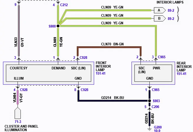

Overhead Map Light reads in the Ford manuals like it's a Demand Light/Lamp.
If it's only the Map Light acting up, I'd guess the console's switch or circuit board.
If it's the problem, appears the entire console has to be replaced since it's one circuit board assy.
The interior lighting system consists of:
• Courtesy lamps
• Demand lamps
• Ambient lighting
The demand lamps subsystem consists of:
• Interior lamps (Map lamp)
• Vanity mirror lamps
• Cargo lamp
• Truck bed lamp
• Truck bed lamp switch
• Trailer assist lamp
• BCM
The demand lamps provide illumination to specific areas within the vehicle when needed.
The front interior lamp sends a message to the rear interior lamp to activate/deactivate it through a LIN circuit.

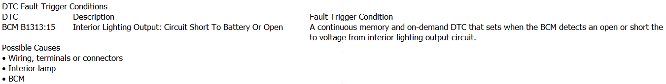

PINPOINT TEST D: THE INTERIOR COURTESY LAMPS STAY ON CONTINUOUSLY
Ford Maverick Issue: 2025 front dome light switch doesn't seem to work quite right?? 1761339115184-u3
D1 CHECK THE DOOR AJAR SWITCH PARAMETER IDENTIFICATIONS (PIDS)
• Ignition ON.
• Using a scan tool, monitor the BCM Parameter Identifications (PIDs).
Monitor the following BCM Parameter Identifications (PIDs) while opening and closing all the doors.
• Access the BCM and monitor the DOOR_SW_DRVR PID
• Access the BCM and monitor the DOOR_SW_PSGR PID
• Access the BCM and monitor the DOOR_SW_LR PID
• Access the BCM and monitor the DOOR_SW_RR PID
Do all the door ajar switch PID values agree with the door positions?
Yes GO to D2
No GO to Pinpoint Test C
D2 ISOLATE THE BCM (BODY CONTROL MODULE)
• Ignition OFF.
• Disconnect BCM C2280F.
• Ignition ON.
Do the interior courtesy lamps continue to illuminate?
Yes REPAIR the circuit for a short to voltage.
For front interior lamp only, INSTALL a new overhead console.
For rear interior lamp only, GO to D3
No GO to D7
D3 ISOLATE THE FRONT INTERIOR LAMP
• Ignition OFF.
• Connect BCM C2280F.
• Disconnect Front interior lamp C928.
• Ignition ON.
Does the rear interior lamp continue to illuminate?
Yes GO to D4
No INSTALL a new overhead console.
D4 CHECK THE REAR LAMP CONTROL CIRCUIT FOR A SHORT TO VOLTAGE
• Ignition OFF.
• Disconnect Rear interior lamp C965.
• Ignition ON.
• Measure: C928 Pin 2 to Ground
Is any voltage present?
Yes REPAIR the circuit.
No GO to D5
D5 CHECK THE REAR LAMP CONTROL CIRCUIT FOR AN OPEN
Rear interior lamp
• Measure: C965 Pin 2 to C928 Pin 2
Is the resistance less than 3 ohms?
Yes GO to D6
No REPAIR the circuit.
D6 CHECK THE REAR LAMP CONTROL CIRCUIT FOR A SHORT TO GROUND
• Ignition OFF.
Is the resistance greater than 10,000 ohms?
Yes INSTALL a new rear interior lamp.

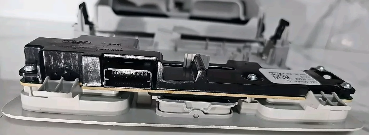

There is definitely something wrong with your dome light.
This light has been used on at least a half-dozen vehicles since 2020. They wouldn't update it to work in such a silly way for 2025. My dome light is always Off when set to "Off". And there is no slop in the switch at all -- I cannot effectively add any more pressure to the switch. I think the problem is probably the switch, not the circuit board.
If you want to investigate further, it is very easy to remove the dome assembly, circuit board, and switch.
This video shows how to pull it down and disassemble:

Thanks, I think I've looked at some of those videos too, didn't seem bad.
I looked and poked and pryed at mine a bit, but didn't get after it too hard and decided to leave it alone.

I never found a fix, and starting to think its 'by design'.
I didn't want to take it to service and have some noobs ripping my roof liner and light switches apart, and messing up my tint and windshield and mirror/interior.
So, i'm just living with it. Off doesn't mean OFF all the time.
Please let me/us know if you are able to get it straightened out.
I'm more likely to 'fix it myself' than have Ford Service try to figure out and have to keep my truck for however long for them to figure it out.
