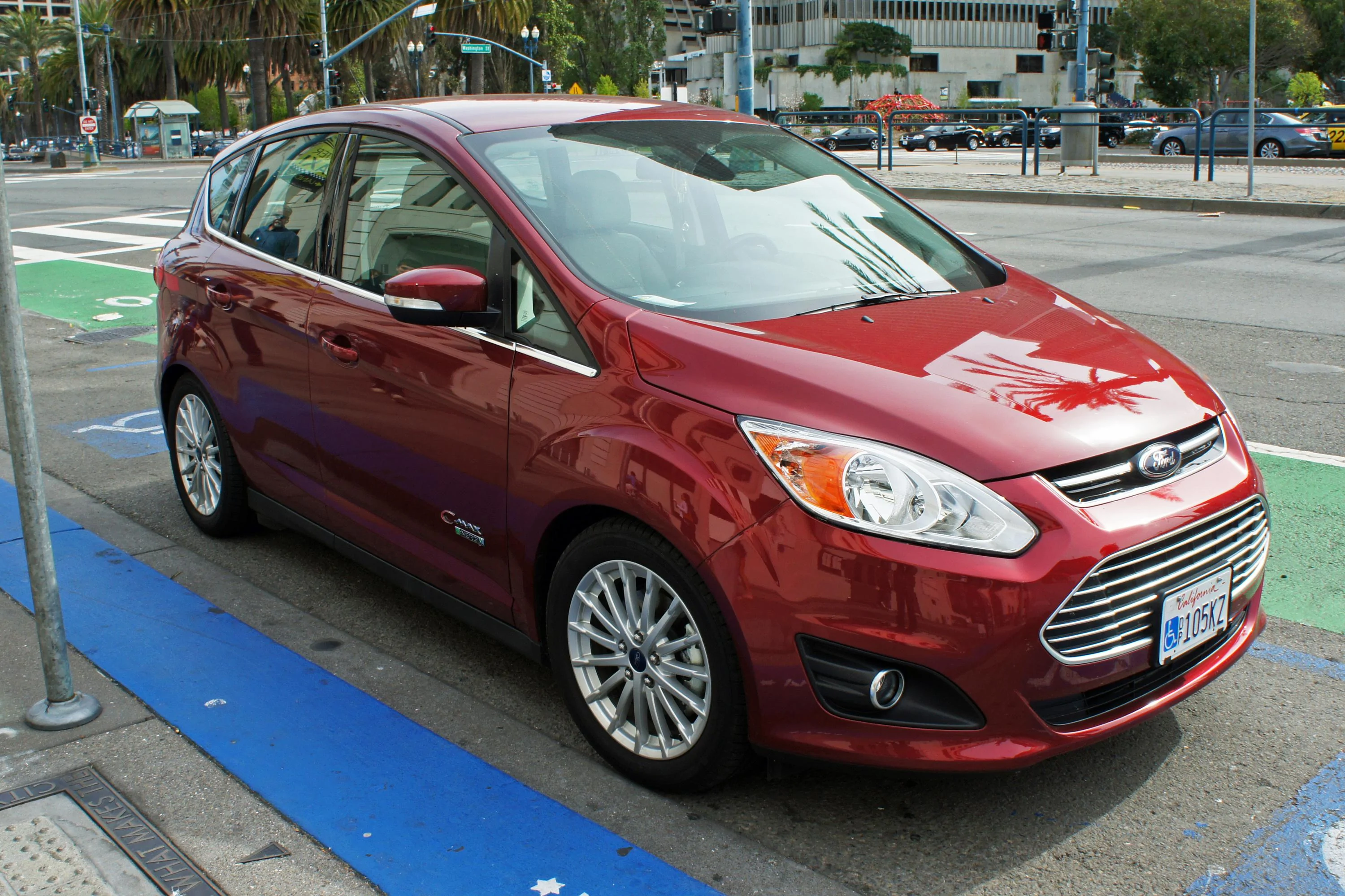

Ummm... I'm new here, what is a C-Max please? Thanks!
It was a 4 door hatchback Ford available in both hybrid and plug in hybrid versions. Last offered in the US at least in 2017 or 2018. Courtesy Wikipedia here is the last generation plug-in variant:
It is kind of like a taller Focus with the same drivetrain as the Fusion hybrid.
Fords answer to the Prius, not as fuel efficient but much more comfortable and with much better performance. Ours has 98,000 now and had the transmission replaced by the "hybrid warranty" at 93,500 miles. Dodged a $7,000 bullet on that one and that's the one and only repair done. We bought it new trading a 2 year old Prius for it, no regrets! It has heated leather seats, nav, all the options with a glass roof. I wish it had a regular steel roof because the lack of insulation does nothing for fuel economy in these hot summers. Still a nice reliable little car.
