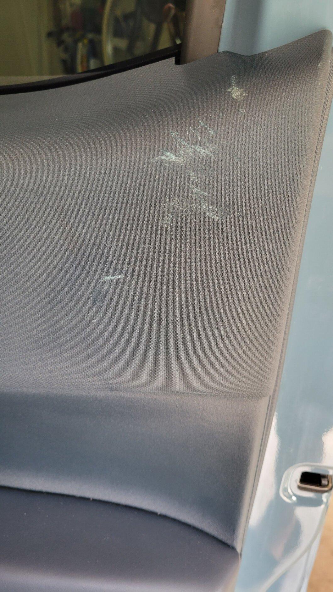

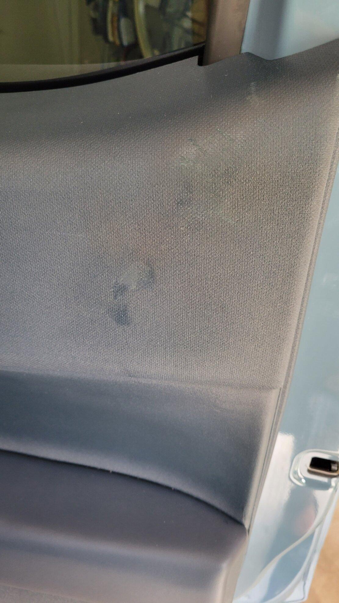

I scratched my door panel mishandling it when I removed it to apply sound deadener. So this method is not for the faint of heart. Heat up the area and dab it as it cools. Just understand you'll lose the texture of the panel but at least it will kind of sort of blend in. Obviously you don't want to hold the flame in one spot for too long -just long enough to start melting the plastic.
Before and after pictures below. From the naked eye, it looks like someone with greasy fingers touched it.
It looks much better than the scuffs and scratches. Wonder if we could find some exact matching paint to resolve the greasy fingerprint problem? Good job and thanks for a solution. :cool:
