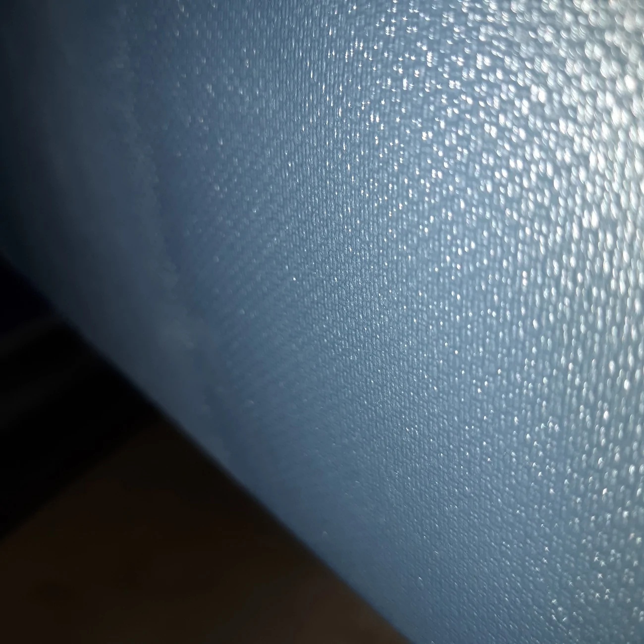

Of course the customers who are complaining probably forgot to mention that they previously sprayed their door with protective spray.
The area you're sticking the pad to is a textured surface.
Ford Maverick Plastic interior scratch removal? 20260630_082547
So the pad does not have 100% of the surface area to adhere to preparation is very important
