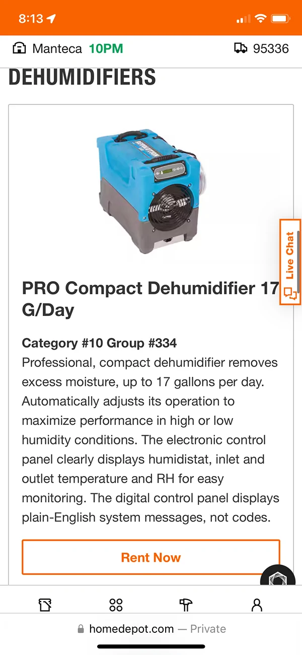

From personal experience. Use a wet vac first. The larger capacity ones seem to pull better. Then if you can rent, borrow or buy a room de-humidifier, set that inside, close up the truck and let it run.
Ford Maverick Interior Drenched IMG_0396
I have used the close it up and run the AC method of dehumidification. That will work. With the temp turned up. Be ware to much heat too long can loosen fabrics that are adhesive-bonded.
Best is to rent the dehumidifier! Dryer results, works faster. Damp rid will not be up to the task of removing that much water.
