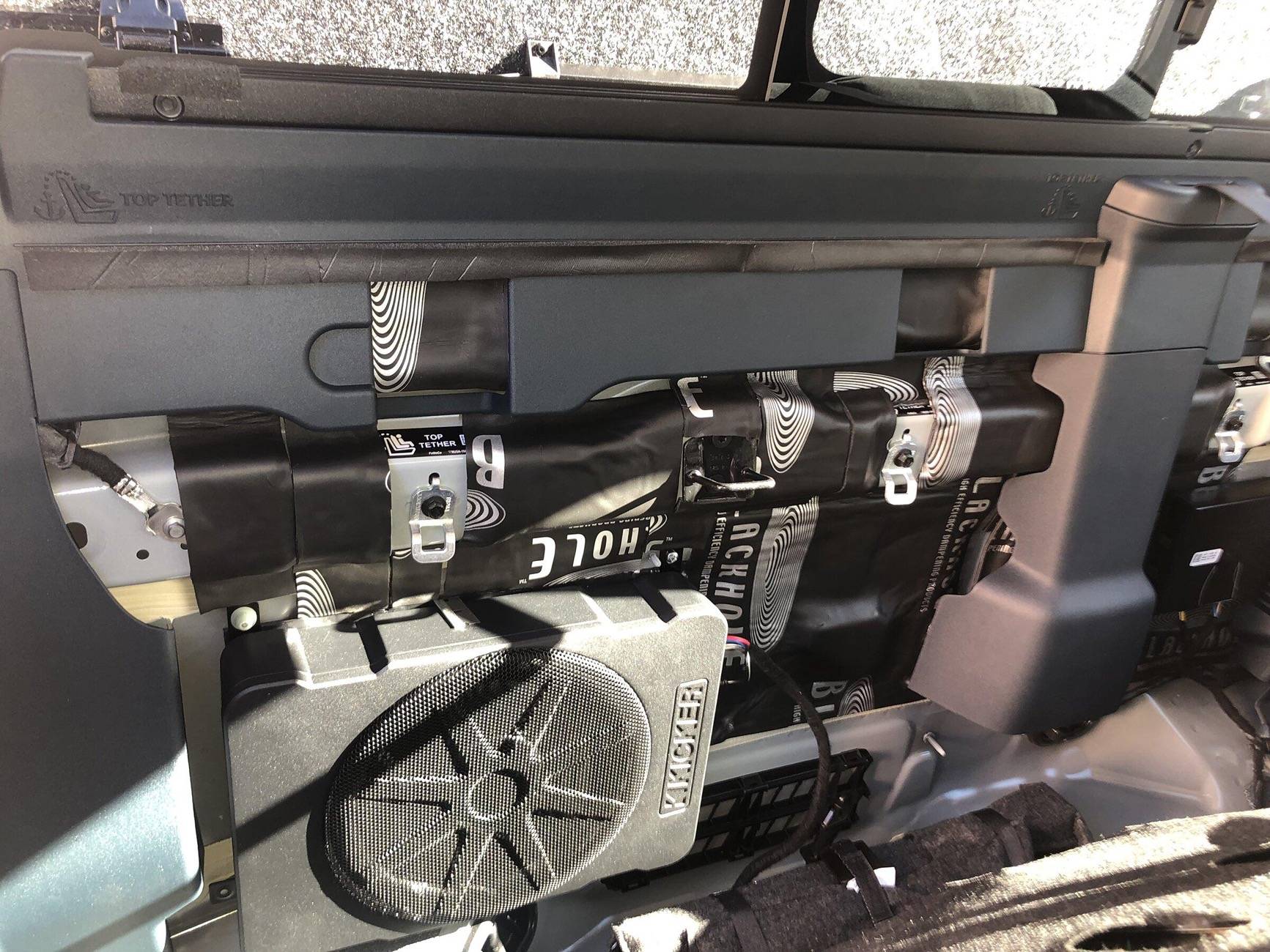

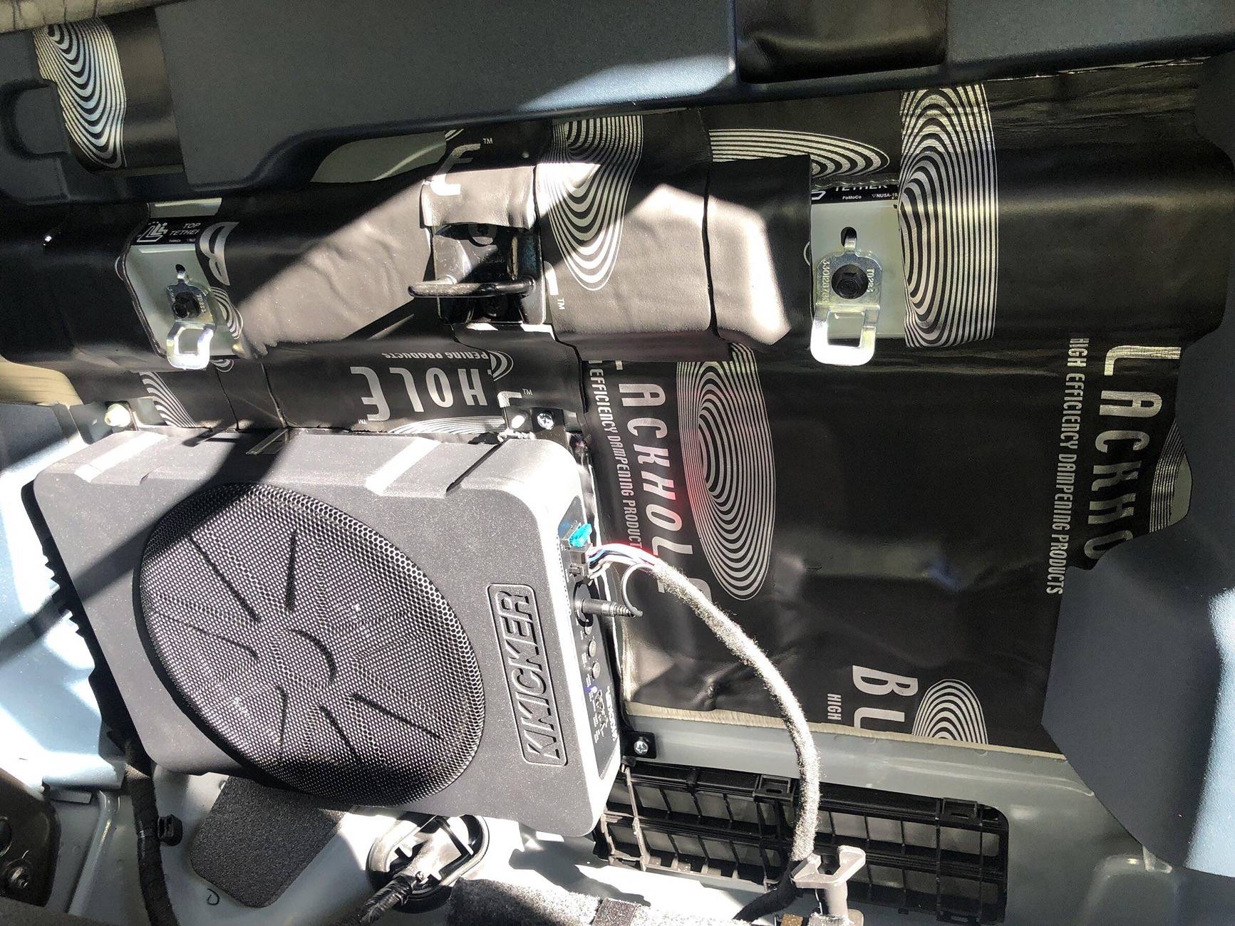

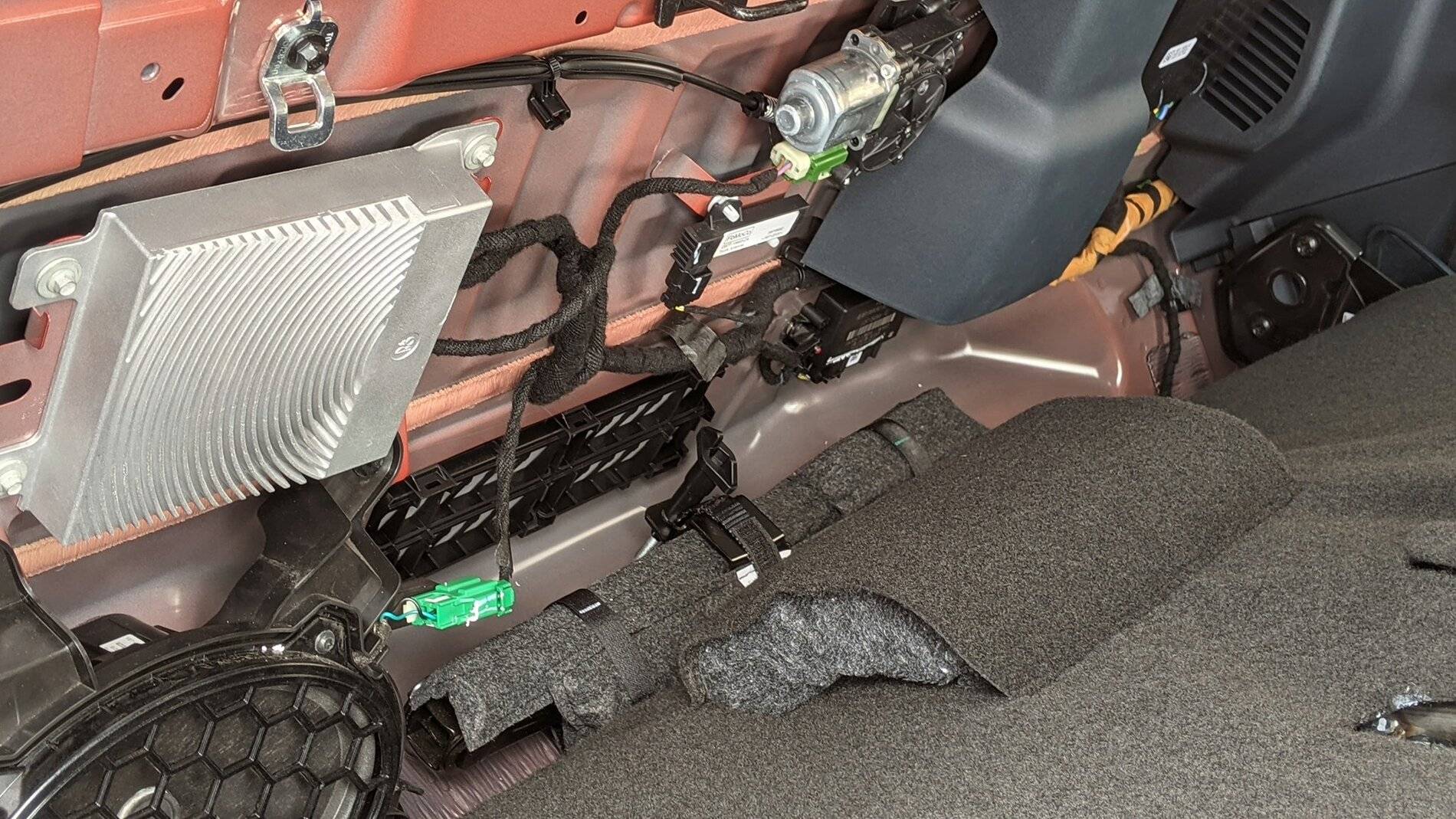

I saw a 25 Maverick yesterday and pulled the rear seat down, and saw this stuff (took off Google) the dsp is for all the system so I need to leave it, but would plop the sub and use its wires for hideaway
but is there enough room to put a hideaway back there w the stock amp? Maybe I can relocate it, pull off the mount and use Velcro stick it somewhere on wall. Make room for a hideaway
and there’s other stuff on the right of it. I’m not seeing any of this in the pics of people w hideaway subs, all they have is a board w sub installed.
Going to go on a limb and say they aren’t hybrids and nor do they have the lariat bo system in all the pics I’ve found
potentially, I could put under passenger front seat, pull the vent thing off I read people do but I’d rather leave that incase I get guest but if I had to I would if can’t make room on the wall

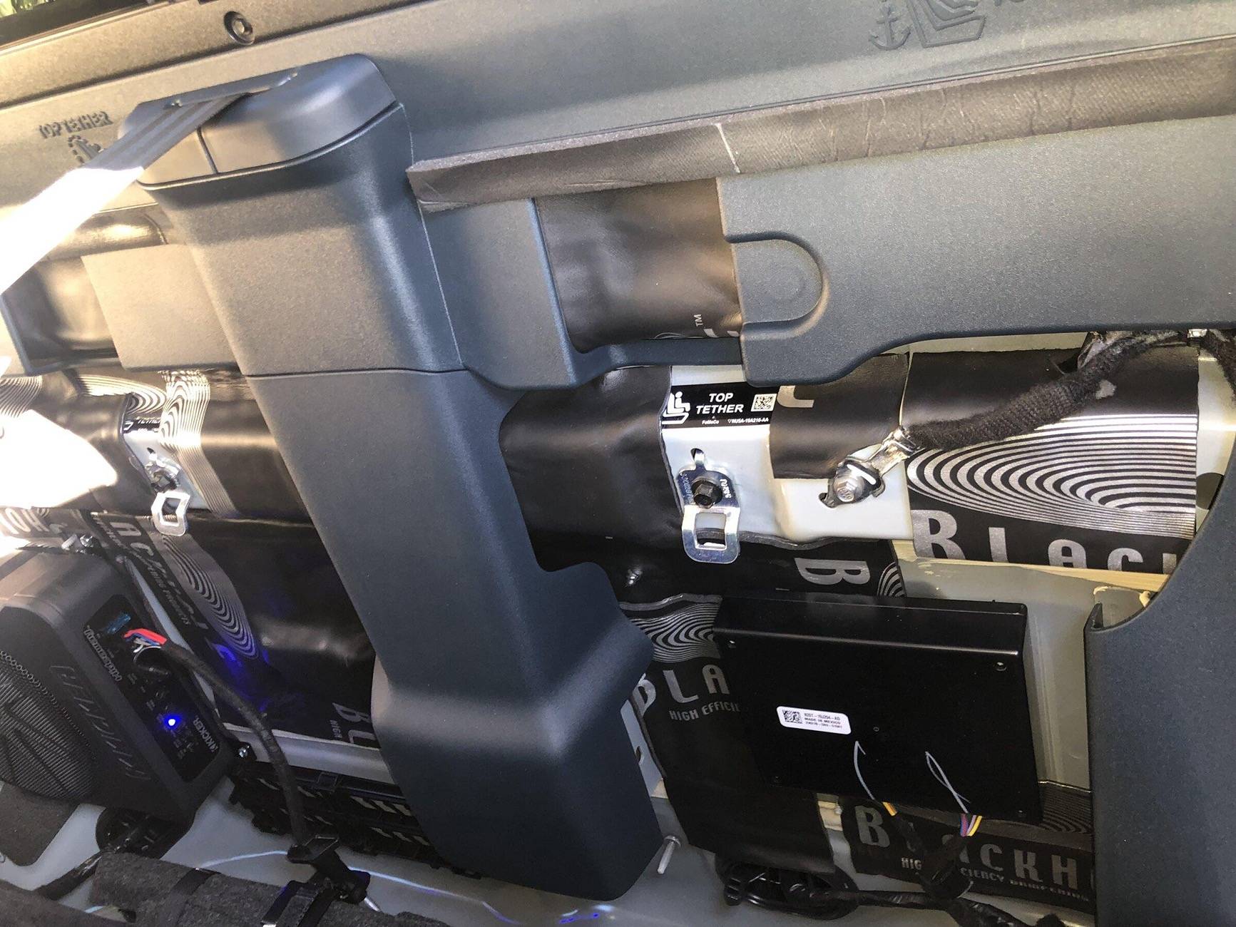

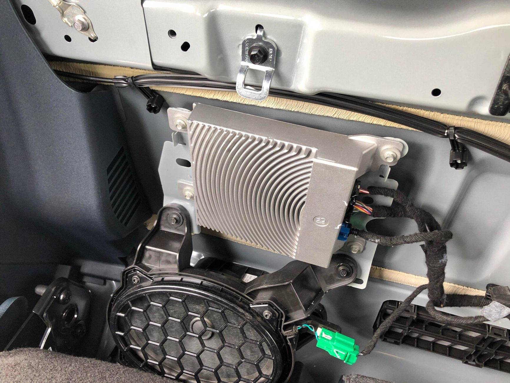

I can't make heads or tails of the different trucks you've included photos of, but the silver thing with the B&O logo is the amp. Some of the pics show a motor for the power sliding rear window.

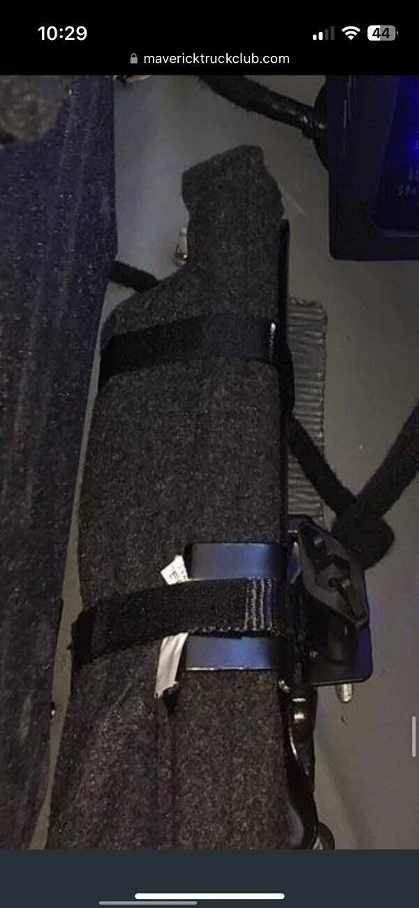

what’s this thing that looks to be tied up? Maybe remove that and move the stock amp down there, opens wall up for sub
That's the jack, lug nut wrench, etc. You're gonna wanna keep that. ;)

they are all mavericks, but all the photos I see have nothing on their walls.
Since I have lariat, I will have that extra harness and amp. Ha yeah, I will figure it out. More than likely put under passenger seat however, not like i will have people back there often.
Rather not disrupt everything back there since it’s more complicated than those without
I think most people subs from what I see are more base models with no speakers or upgrades. Makes easier for them space wise or those w lariats don’t feel the need as much to upgrade.

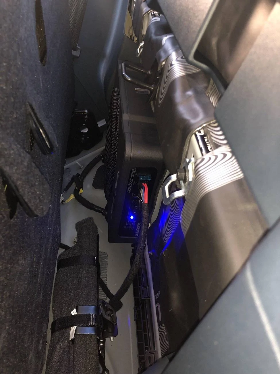

My concern is, that hvac pipe under the passenger front seat. I don’t care about leaving it as long as it fits But if it’s indeed in the way, can I unbolt/remove the vent?

unbolt the factory 6x9 and install the hs10 there. it likely won't fit under the front seat and the rear is better anyway and won't sound any different.

there's no question, people have done it and there is no disadvantage to placing it behind the seat.
conversely if you did get it to fit under the passenger seat - which I highly doubt, by the way - it would interfere with sliding the seat and would stick out the back enough to block the vent (as you're already concerned about) and passengers in that right rear seat will step on it and kick it.

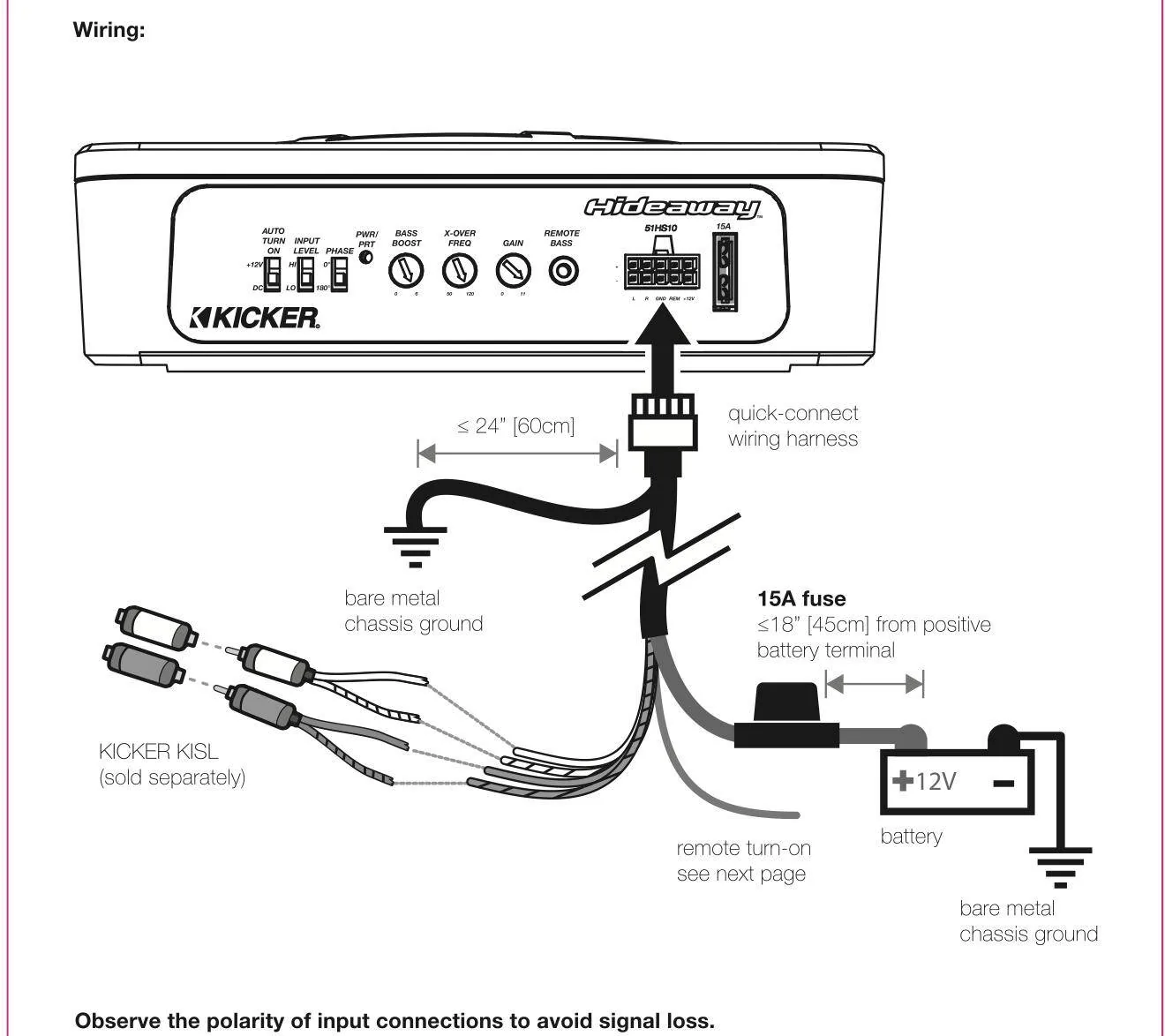

One question. It's Mono sub, technically they want you to use 2 speakers, a positive/negative from both. - because the sub lariat just has 2 wires, 1 positive one neg. do I do the following options
1. hook stock 2 wires into one white, one grey white
2. hook 1 each wires to solid white + solid grey
3. tie the 2 whites together, and connect to one wire from sub and tie 2 grays together and tie to other wire?
because in my mind, 3 is the way to go. that would be pisitive/negative for both sides. mimicking 2 speakers one pos one neg each side.- I say that because in this diagram, it look like the little adapter just turns both wires into 1 anyway.

b&o 6x9 sub is already summed mono by the factory amp. you can connect the line from it to either left or right input on your hs10 without concern or issue.
