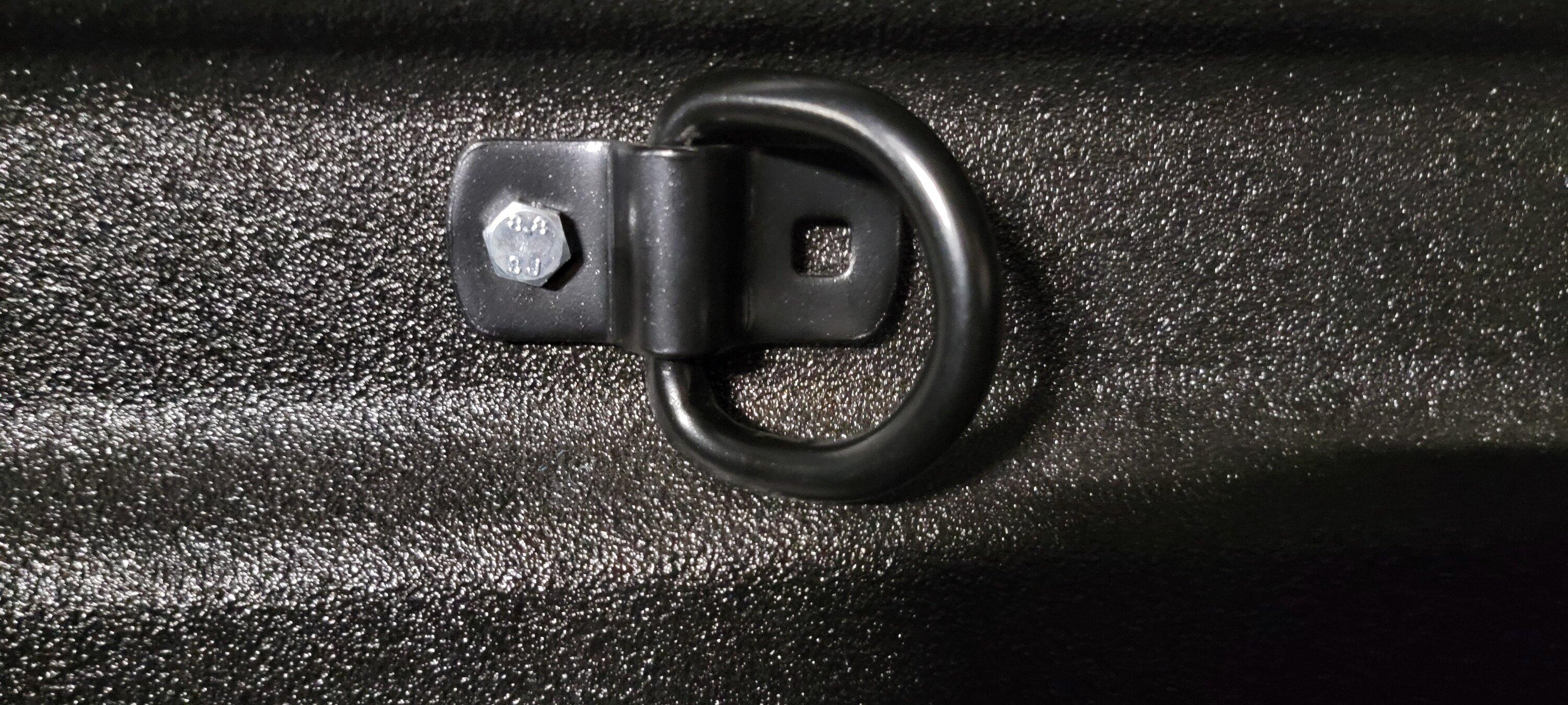

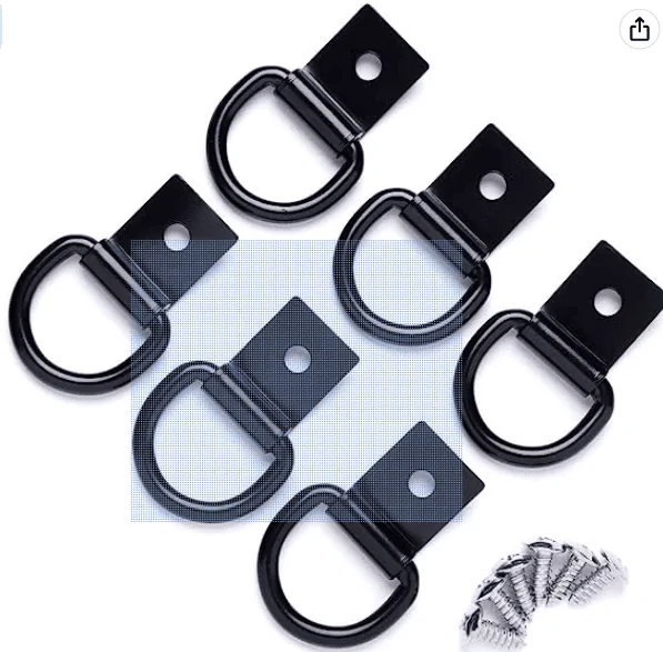

Instead of spending hundreds for the bed rail system that Ford sells, I went to Home Depot and spent less than $14 to put two of these in.
It's an M8 bolt and a medium duty D ring.
Caveat: it's only anchored on one side.
But for what I need, it'll do just fine.

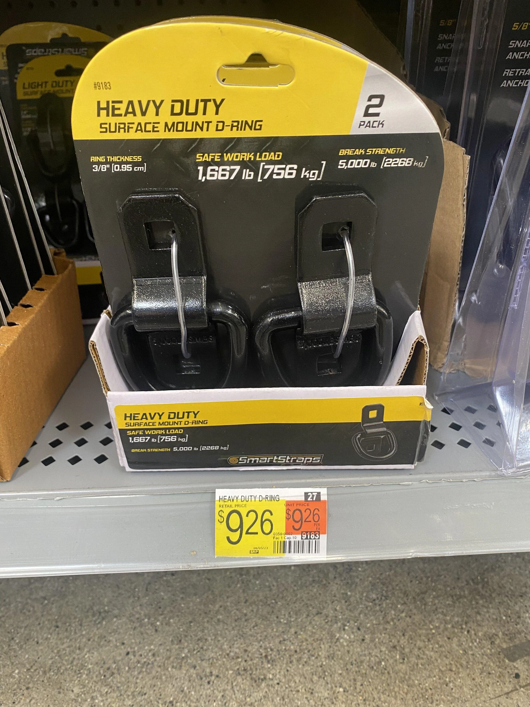

Walmart has these too.

Why didn't you put the second bolt?
Johnkn
Jan 19, 2022
73
2,320
3,520
MD
Because there is only a single threaded hole
Some people have different ideas on doing things the right way...

And you don't want to add a second bolt?
I’m not the OP and I would never install anything that way, but it’s not my truck...

I picked up my Maverick yesterday and put the D rings on this afternoon. The bolt hole in the D rings were 1/4" so I reamed them out with a 5/16" drill bit. The 8mm bolts worked fine after that.

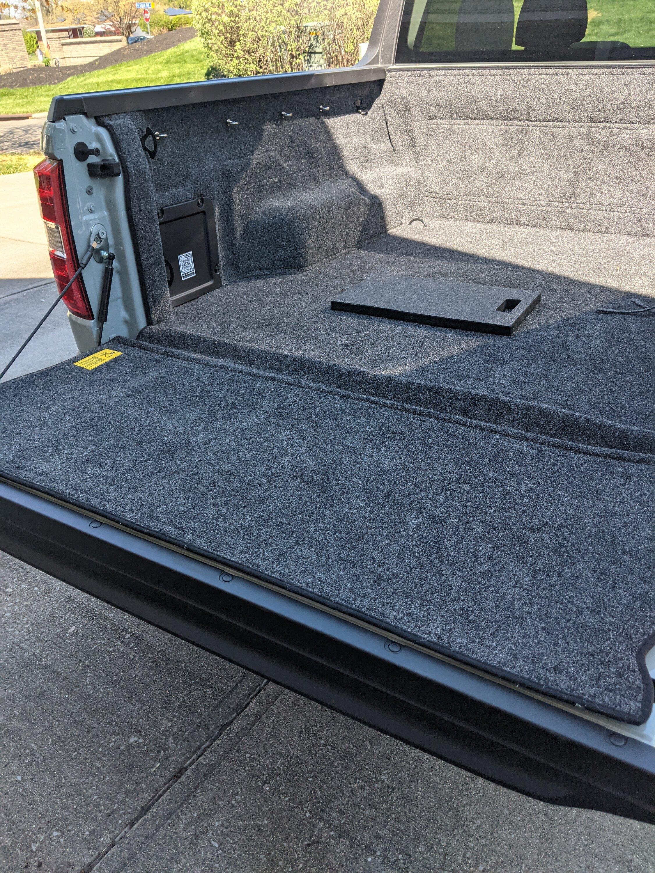

I used these as well and like them.
Your bed looks really good.
I went with the Ford bed mat and tailgate cover. I'm surprised at how "sticky" the rubber mat is. It may be a pain if I do want to slide something around in the bed.
For what I am doing, no.
It's primarily to lock the cooler I use to transport milk and other temperature sensitive items in place. It also keeps the cooler from sliding around when it's empty.
A vagrant sneaked into the garage where the truck is parked and stole the previous cooler out of the bed. The single bolt will allow me to lock it up with a cable lock. And they won't be able to pull it out.
