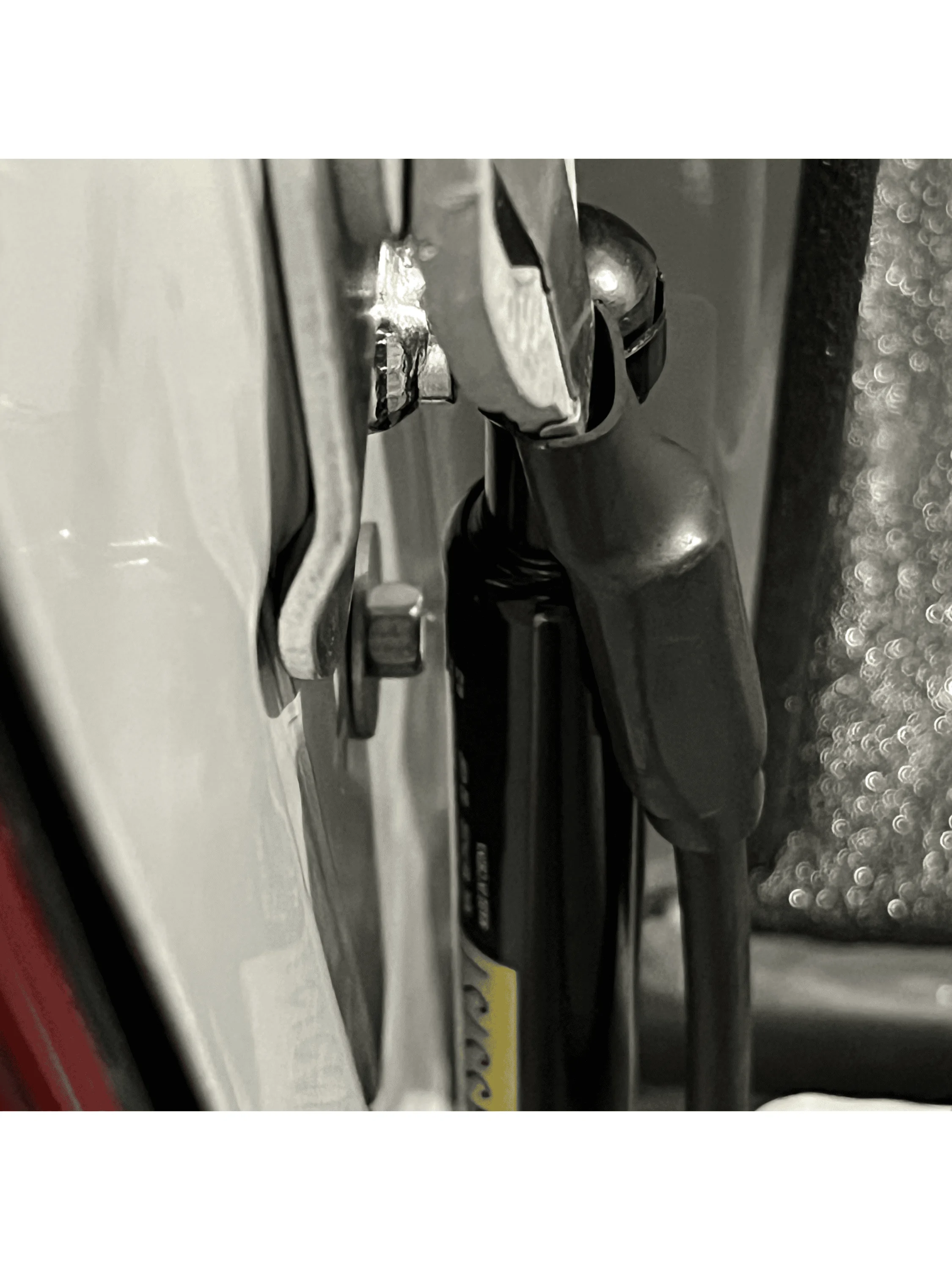

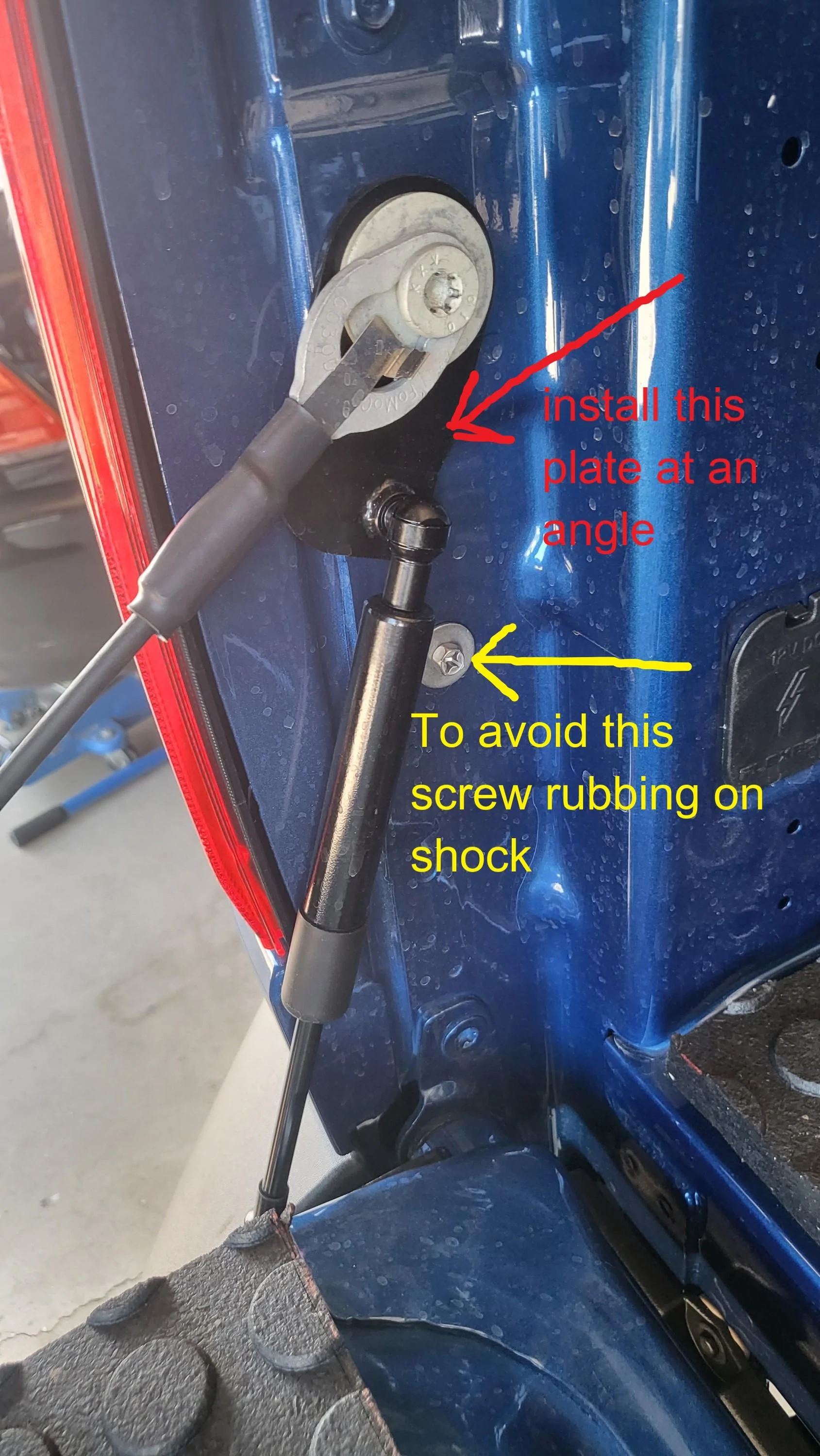

Here is another little tip that may help anyone installing the tail gate assist.
I 100% would not do this. When installed correctly there is plenty of tolerance - close to a 1/4 inch between the screw and damper.
I have a different brand tailgate damper, but also have the same roughly 1/4" clearance to the tail-light screw head. Though, I did discover the damper is in the way of removing that screw when I installed some Lasfit backup LED "bulb"s. I ended up removing the top T50 bolt because I didn't want to over-force anything to pop the damper off of the ball mounts.

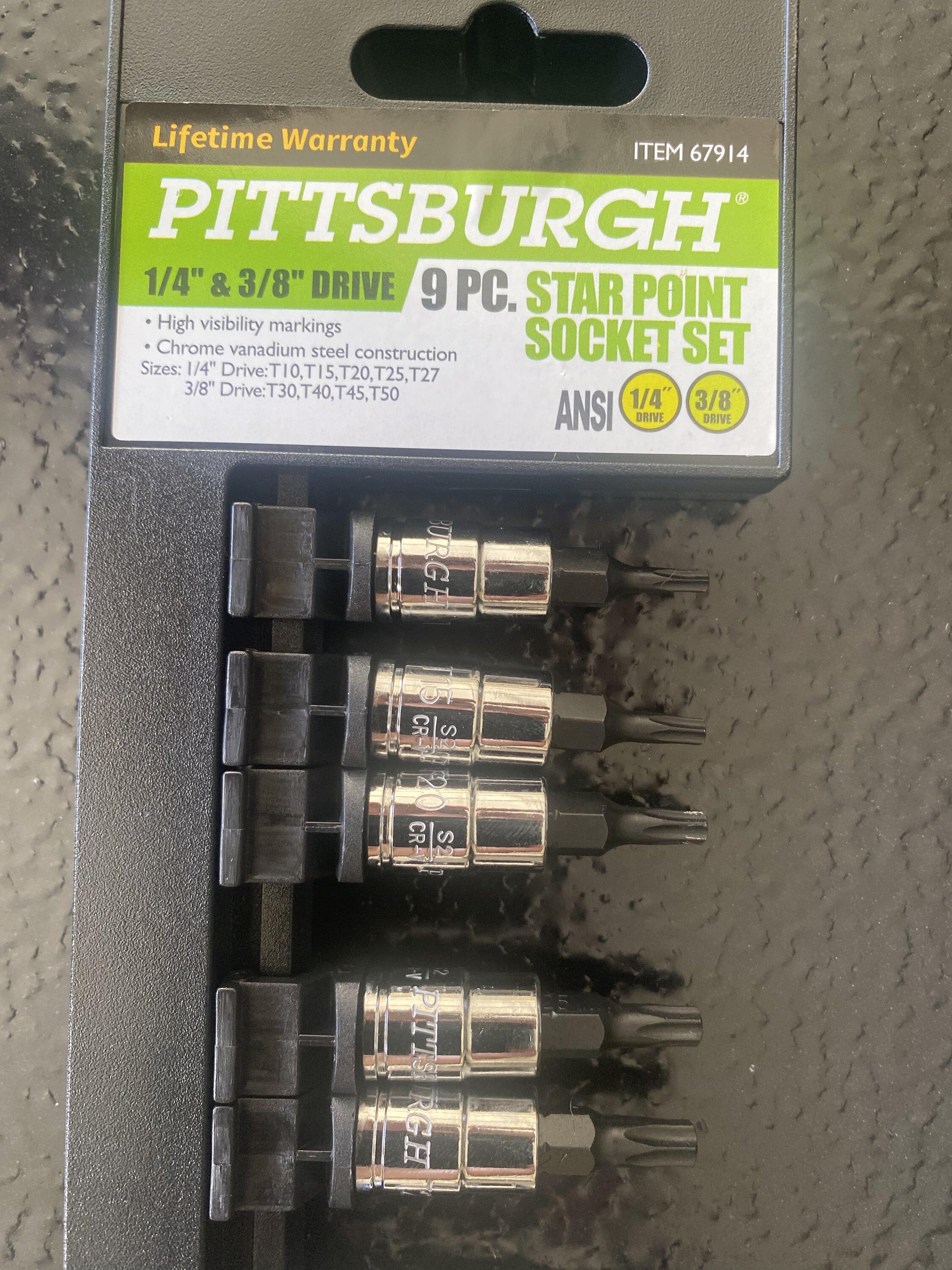

Hmm, well since no one else is having an issue it makes me wonder if somehow my bolt is cross threaded or something.
I did get a harbor freight bit but I dont think that is it. Once I plugged it into the drill and tried that it was stuck enough in that the drill itself was turning instead of the bolt. (if you get what I'm saying), I'm gonna try a third time I guess.

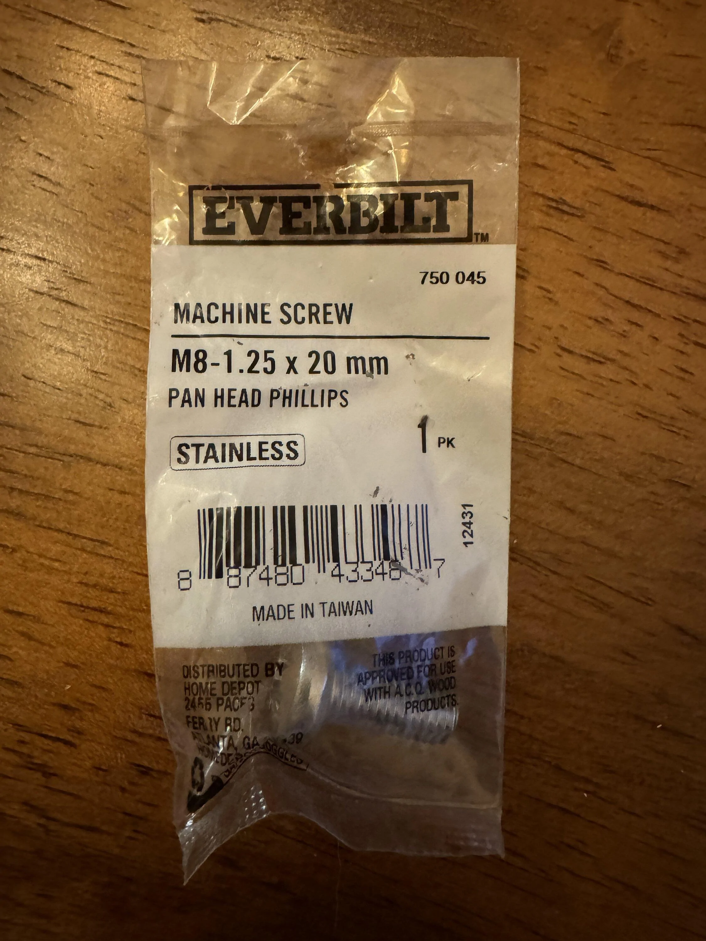

This is a bolt that works with the supplied nut stainless steel #4 Philips screwdriver used. For the deezee tailgate assist.

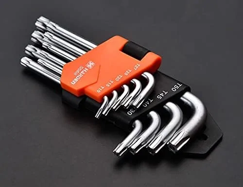

For anyone just finding this and needs help, my biggest problem seemed to be the cheap Torx bits I got from Harbor Freight, in a fit of desperation I ordered another set off of amazon and the bolt came out with little problem. The cheap bits from HF were soft metal and were stripping before it could move the bolt.
These are the ones I bought that worked: LINK
