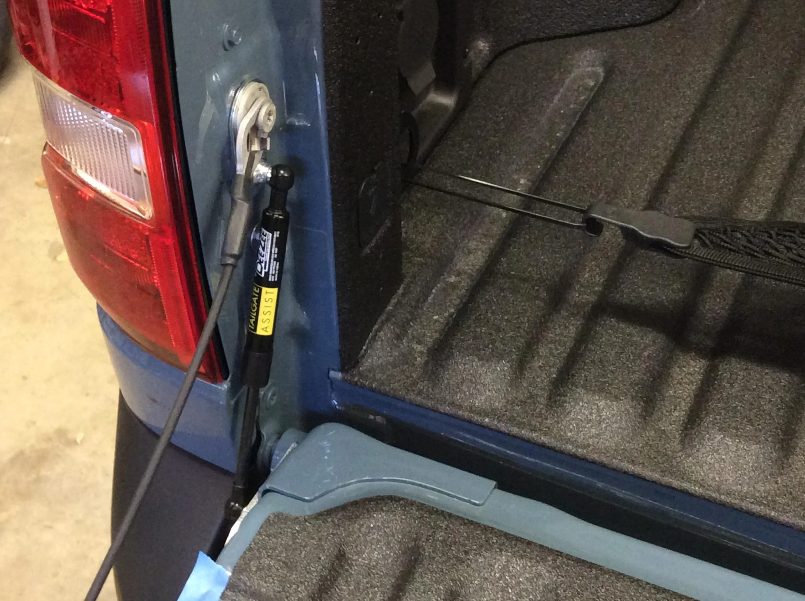

Anyone have any trouble installing the tailgate assist

Thanks, you were exactly right. Unfortunately I stripped the head, so SOL on that piece. Glad it isn't stuck in there or anything. Guess another $50 and another try, right.
You could probably get the assist kit from Amazon for less than 30 bucks. I did. Enemy got the correct Torx bits to get those bolts out.

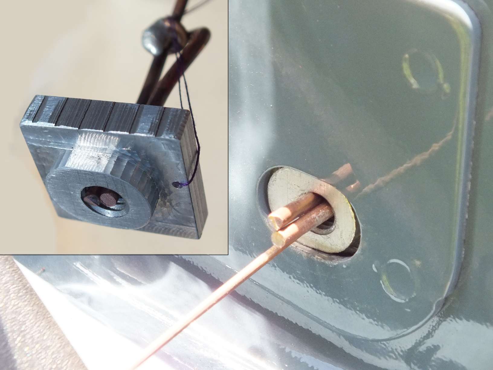

Tip that I used: I realized on first try the nut was not gripping the tailgate enough and the bolt had way too much loctite on it.
First I put the bolt in my wire wheel grinder and buffed off most of the locker. Then I put the nut in my vise and defined the flats a little more with a fine file.
Then I used a clip removal tool to apply pressure outward pulling the nut into the groove. Once it was gripping correctly, I tightened the daylights out of it!
