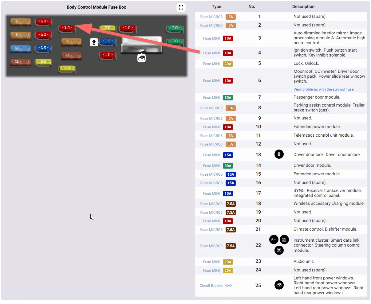

Check this fuse 4. It is located on the panel under the dash in front of the passenger seat.
Ford Maverick Ignition Switch Problem 1784052171554-eh
