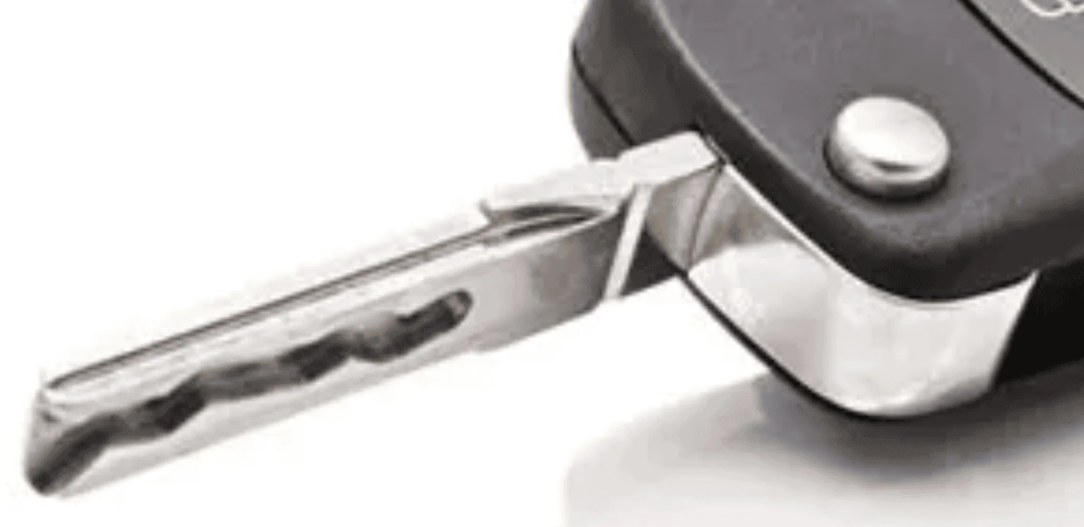

The Maverick key is similar to this don't know if ACE can cut something like that. don't care for the new style. I'm used to 35 years of traditional Ford keys. I remember when you had to use 2 keys 1 to unlock the door and 1 to start the vehicle
Ford Maverick Spare ignition key Screenshot_20220616-203633

You can get a plain key https://store.carkeysexpress.com/ke...MI3Jrf0qyz-AIV4yCtBh1-NwFIEAQYASABEgJoJvD_BwE get it cut somewhere and self program if you have two keys (have not tried this but its been the procedure for years)
1. Insert programmed key 1 and turn to on position (right before start) for 3 to 10 seconds then turn off removing key 1
2. Wait 3 to 10 seconds after removing key 1 and insert programmed key 2 turning to on position, wait 3 to 10 second then turn off removing key 2.
3. Wait 3 to 10 seconds after removing key 2 and insert key to be programmed (after being cut) turning to on position and waiting 7 to 10 seconds, then turn off removing key. Now test your new key.

🔑 Has anyone found out if Ace will cut the Maverick's center cut key - or if there is a good place that will do it?
