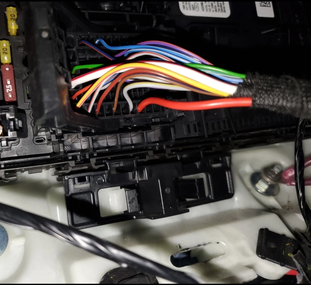

If you are good with Pins, you can add a pin on the output side of the fused circuit you want to use. I did it when I added Adaptive cruise control (power feed for the radar) red wire in the photo is what i added.
