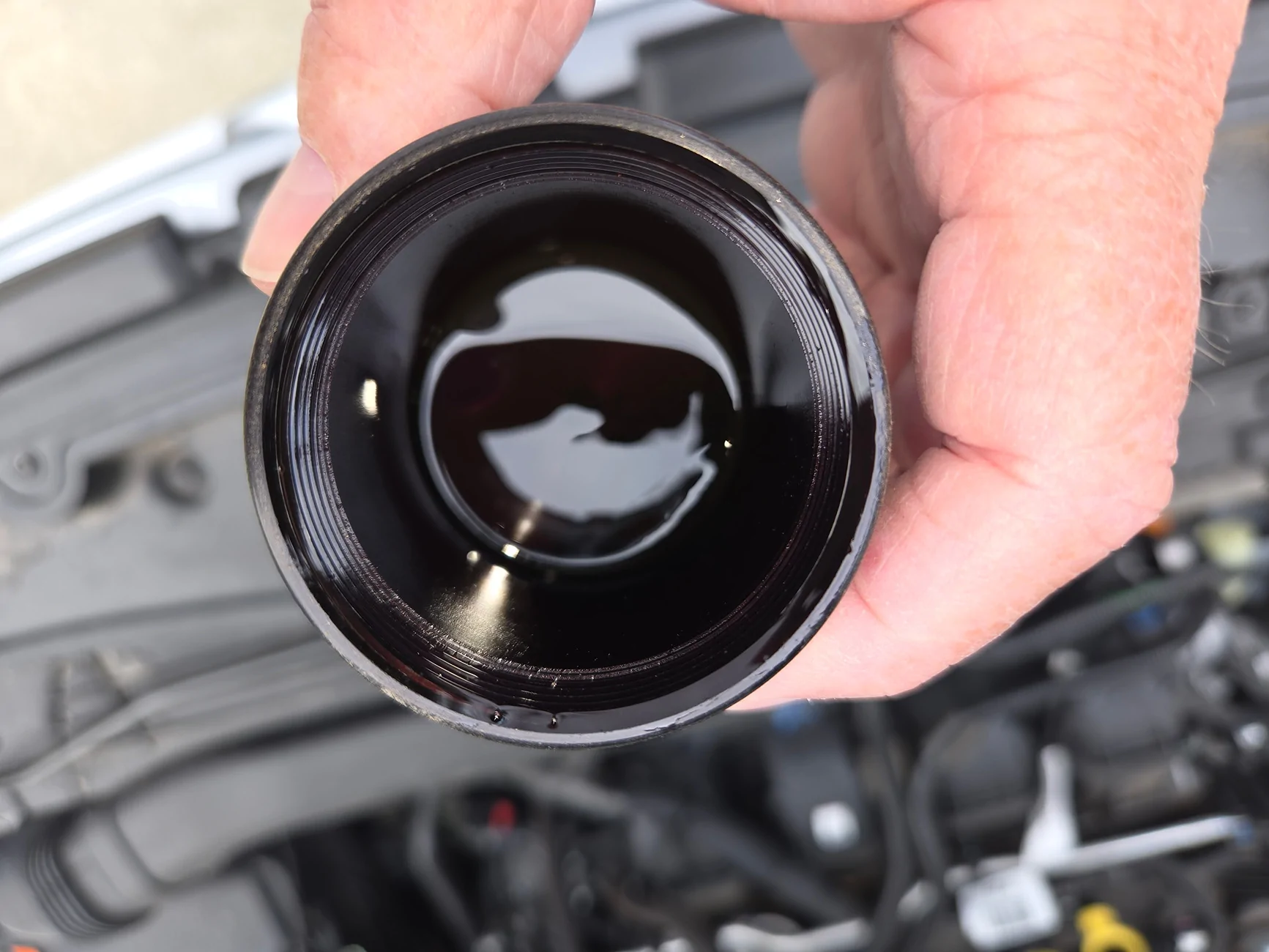

maybe a tablespoon (or less) in the can after the drive of 1.4k miles at highway speeds.
That is a lot! The OP’s latest Gen EB only had nothing. Indicates the redesigned EB focused on oil recovery along with port injection. Screw the battery issues on the hybrids - let’s improve the EB;)
As designed. Still nothing for me though. I expected to see at least that much at this point.
For what it’s worth I could not be more happy that my canister is dry.
That might be true if the OP had the latest gen Ecoboost, however he doesn't. We've discussed why the OP has had nothing, and that isn't it. There are many factors including ambient temperature, engine temperature, humidity, RPM and boost level that affect the amount of vapor present in crankcase vents.
I also mentioned that my 2024 usually doesn't catch anything in the summer months.
Note the early Maverick in the OP's profile photo and see post #30 for a photo of the OP's engine: https://www.mavericktruckclub.com/f...thing-not-a-drop-catch-can.84697/post-1406657.
See post #35 where I promised to keep my mouth shut on this thread. Leave the discussion to those who know what they’re talking about. Ok - this time I mean it.

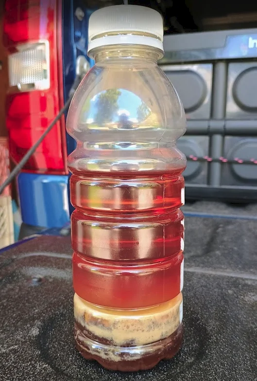

This is what my catch cans produced over the cold months, October 2025 - April 2026 while my Maverick traveled about 6,000 miles. Half of those miles were highway and steep mountain pass miles on my annual trip to CO to close the cabin for the winter months.
This is a 16.9oz bottle, so I'm guessing there's 12-13oz of liquid in there. The majority was from the "dirty" side, and the cans haven't collected much of anything since that timeframe. The tea-colored liquid at the top has a very watery consistency. One might assume that it is mostly water, and the brown liquid at the bottom is oil. However, I don't think that would be the proper conclusion since water is denser than oil and therefore floats on water.
IMO the main thing is just how well your engine was assembled. Some engines have looser piston ring tolerances than others, and will pass more vaporized oil and other junk into the crankcase.
It also depends how often you check it, since if your engine is nice and tight and not passing much oil vapor, the other byproducts usually will evaporate (the catch can gets pretty hot sitting in the engine bay, especially in summer). Thus explains the mystery of empty cans every time one happens to look...
I work on a lot of vehicles, and I don't see much variance in tolerance from one engine to another these days. I haven't owned a Ford that had any noticeable blowby or reduction in oil volume over the course of an oil change interval in 20 years. Yet there are still enough contaminates from the crankcase to cause carbon buildup in all DI engines, regardless of any perceived quality of assembly issues.
Today's PCV systems are closed loop systems, most of any evaporated liquid will remain in the system, not vent into ambient air. There is no mystery. Warm engines don't produce much condensate, especially in dry environments, because the dew point is rarely reached. Rings also don't seal well in a cold engine, leading to increased blow-by.
