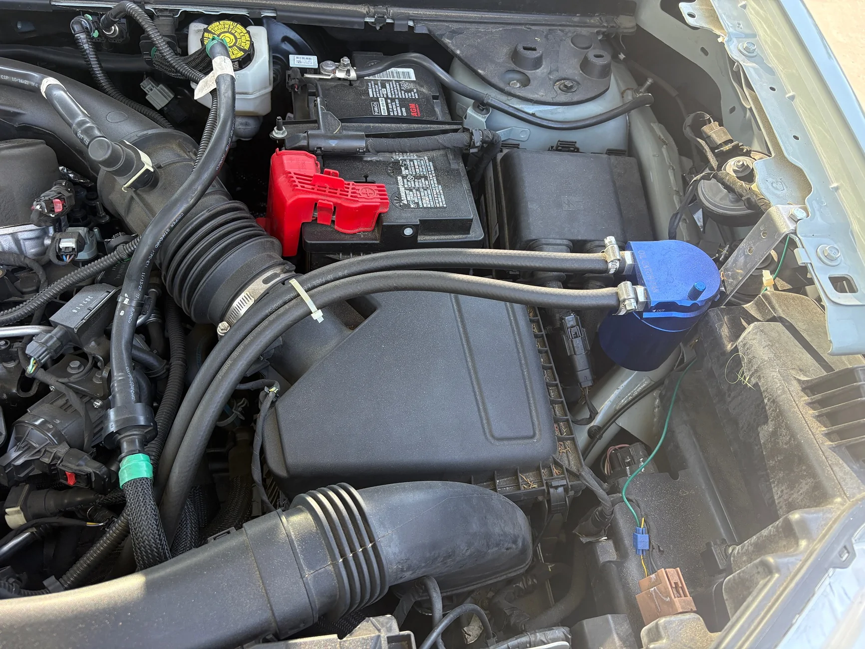

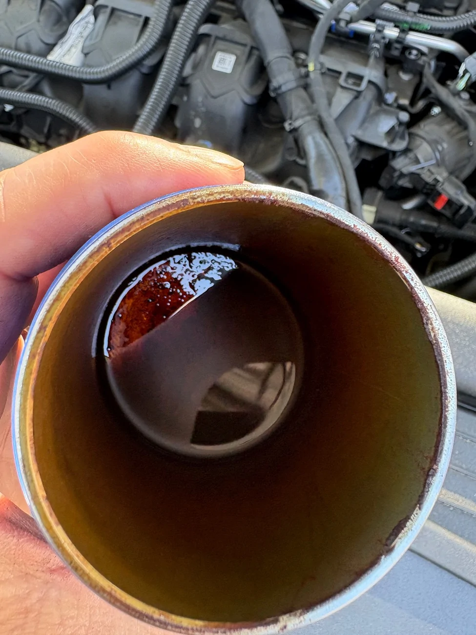

You want to do the other side. I had one on each side and removed the one at the rear of engine after a year of getting nothing. The front of engine side catches a lot of oil. I empty it every oil change. This picture is after 3,500 miles.
Ford Maverick I Haven't caught a thing. Not a drop. Catch Can IMG_3141
Ford Maverick I Haven't caught a thing. Not a drop. Catch Can IMG_3139
That’s the one I’m talking about. Same location as yours. Not a drop.

You have a 2024, right? Not the new engine? I would double check the install just in case. I definitely get oil and water in there. I think this is the install video I followed. Good luck.

Yep. Watched that same video and followed it exactly.

I agree with TBone. I removed my clean side catch can because wasn't getting anything, maybe 1 or 2 drops after several months. On the dirty side, I get oil/water all year.
I see just about zero blow-by/condensate in mine during the summer months. We have a solid four seasons here though, and I definitely catch some in fall through spring. The colder the startups and the shorter the trips the more blow-by/condensate you will experience. Unless you spend a lot of time under boost, I wouldn't recommend you buy a breather (clean) side catch can.

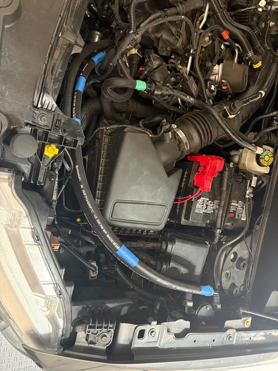

Maybe post a picture in case any members can spot something that looks off.

The factory oil separators, especially the current version, return the liquid oil back into the crankcase. Oil captured on the dirty side catch can would have been put back into the crankcase instead of stuck in the can & associated hoses. Clean side catch can being empty shows the OEM separator is doing a fine job:)
My thoughts too. Maybe the engine separator doing the job.
Your comment shows a fundamental misunderstanding of the PCV system and how the catch cans are routed.
The dirty side catch can works in addition to the factory oil separator, between the PCV valve and the intake manifold. The dirty side (PCV) catch can catches the liquid that the factory oil separator does not fully separate and return to the crankcase under positive crankcase pressure. Without a PCV catch can, the liquid found in it would travel straight from the factory separator into the intake manifold. The dirty side (PCV) catch can and factory oil separator are only functional while the crankcase pressure is positive relative to the intake manifold pressure.
Under boost, the clean side catch can separates liquids that travel from the valve cover through the breather while positive manifold pressure closes the PCV valve. The PCV valve is fully closed due to negative crankcase pressure (relative to the intake manifold), rendering the block-mounted factory oil separator non-functional. Liquid separated by the clean side can would normally travel from the crankcase through the intake, turbocharger and intercooler due to not being separated by the factory setup.
Since catch cans work in addition to, alongside, the factory oil separator, any liquid found either in clean side or dirty side catch cans is liquid that the factory crankcase ventilation system has failed to separate and return to the crankcase. 100% of the liquid found in the catch cans would be routed through the intake valves with the factory PCV/oil separator configuration.
Here is a picture of my installation. I marked the PCV hose with blue tape so you can see it better. This hose is connected to the PCV on the block. It’s the fitting that moves and swivels. The other is connected to the intake manifold. It doesn’t move or swivel
Ford Maverick I Haven't caught a thing. Not a drop. Catch Can IMG_1334
