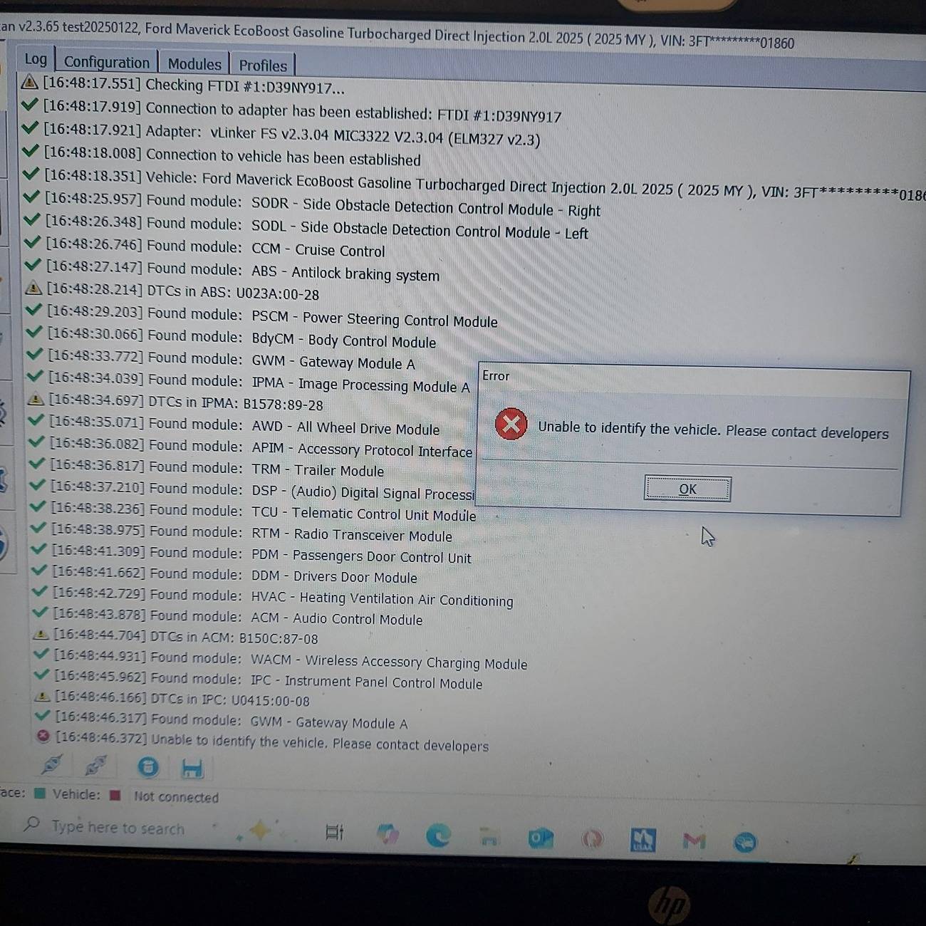

I tried that version on my eco boost. This is what I get.
Install the version I posted. Looks like you’re using the previous beta version.

NEW TEST VERSION!
The ForScan people sent me a NEW test version that they claim corrects the errors I was seeing when trying to mess with the seatbelt screens. This is what they said....
Fixed, here is the test build:
https://forscan.org/download/FORScanSetup2.3.65.test20250122.exe
Important: please remove the vehicle profile before the first connect with this version.
Please also note it is recommended to use "Module Configuration" functions instead of As Built, if they are available.
Here is an article about how/why to delete the vehicle profile before using this new version of the software.
https://forscan.org/forum/viewtopic.php?f=5&t=9196
I was able to download this today and eliminate the annoying seatbelt screen. That screen was markedly worse than the one on the ‘23. Thank you for the link!!
