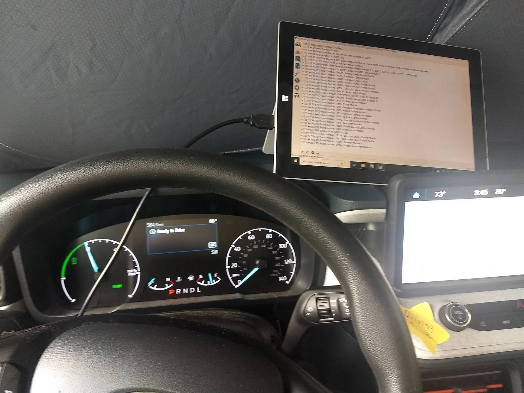

So much nicer with a tablet and bluetooth keyboard.
Found a refurbished Surface 3 (not Pro) Win 10 Pro, Atom 7 processor 4GB of RAM on Amazon for about $100. Already had the bluetooth keyboard. The tablet has a 4 position kick stand so that you can put the full-sized USB port on the left near the OBD-II interface. The power and volume buttons are now on the bottom but no interference was detected.
It's a bit bigger than I might prefer and does not fit nicely on the top of the dash. I might put some anti-skid on the tablet so it's more stable on top of the dash.
Micro USB port on tablet only does charging but worked with USB on center console so it would work even if the tablet battery is dead but my battery is fine.
Minor quibble, my phone has a stylus. The tablet touch screen did not react so I had to do fingers only. Some interactions with forscan I did in portrait mode and had to reach through the steering wheel with my fat fingers against some pretty tiny icons. I have my own issues with what a terrible UI Forscan presents but I will rant about that over there.
