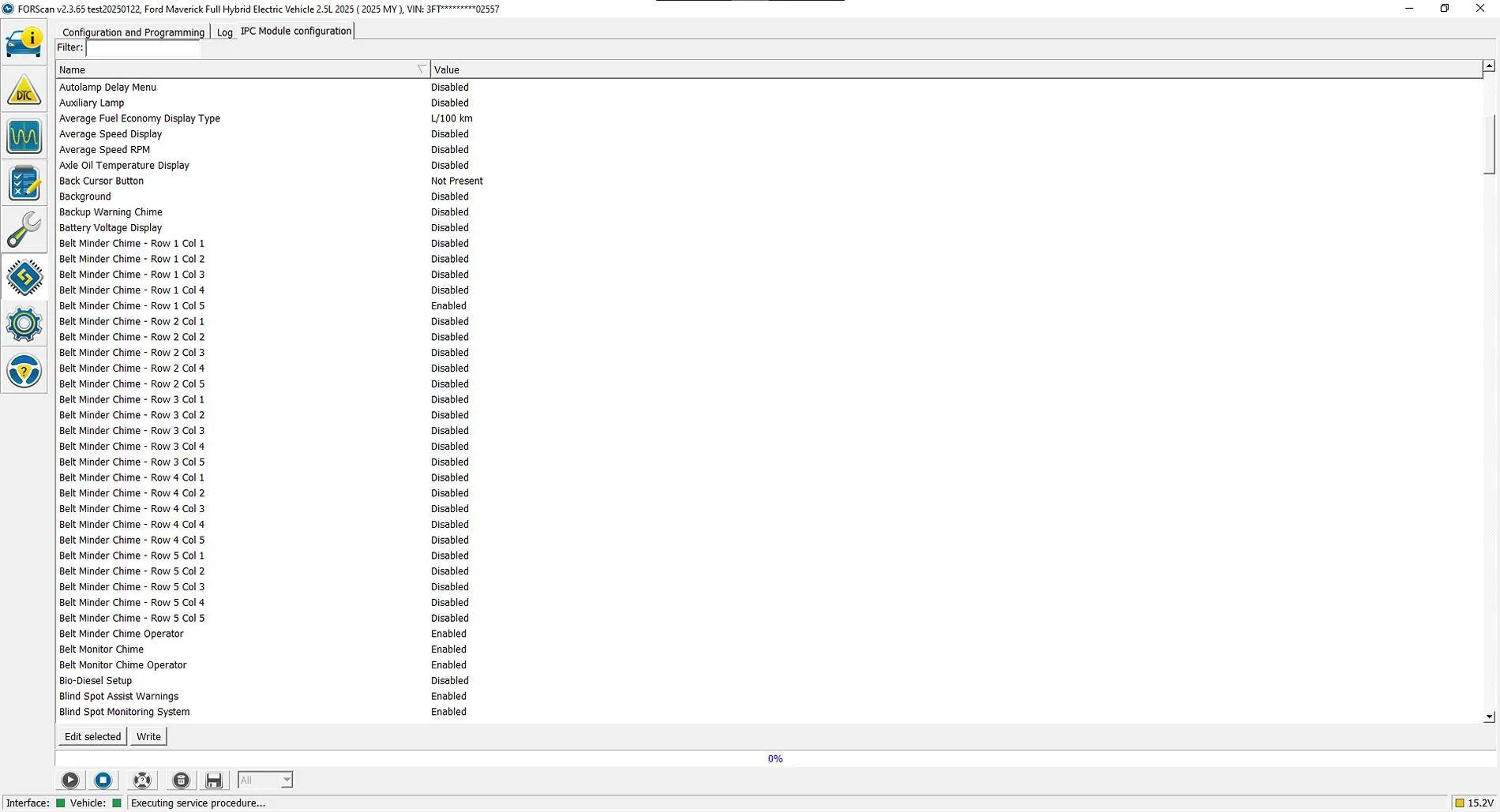

So I noticed there are also options available in the IPC EZ-mode configuration for Belt Minder Chime and Belt Monitor Chime. Are these also available on the previous model years? Just curious is folks have tested them.
Was also looking for the Driver Restriction Menu in ACM EZ-mode (table below from the master spreadsheet) but I only see as-build configuration for ACM. Wondering if that is a change for the 2025s as well.
Driver Restriction Menu Disable (XL,XLT only)ACM(EZ) Disable "Driver Restriction Configuration"
Video Playback enable with NO speed restriction (XL,XLT only)ACM(EZ) Change "Video Playback" to "Enabled without Restrictions"
What do these two settings do exactly?

Alright I'm not super familiar with Forscan. I got the seatbelt chimes to turn off. But haven't been able to get the screen pop up to go away. Also, now when I'm in park and take the seatbelt off, the pop up screen comes on and there's no way to press "ok" to make it go away. Also tried to turn off the door chime but it didn't seem to take after I wrote it on Forscan.
