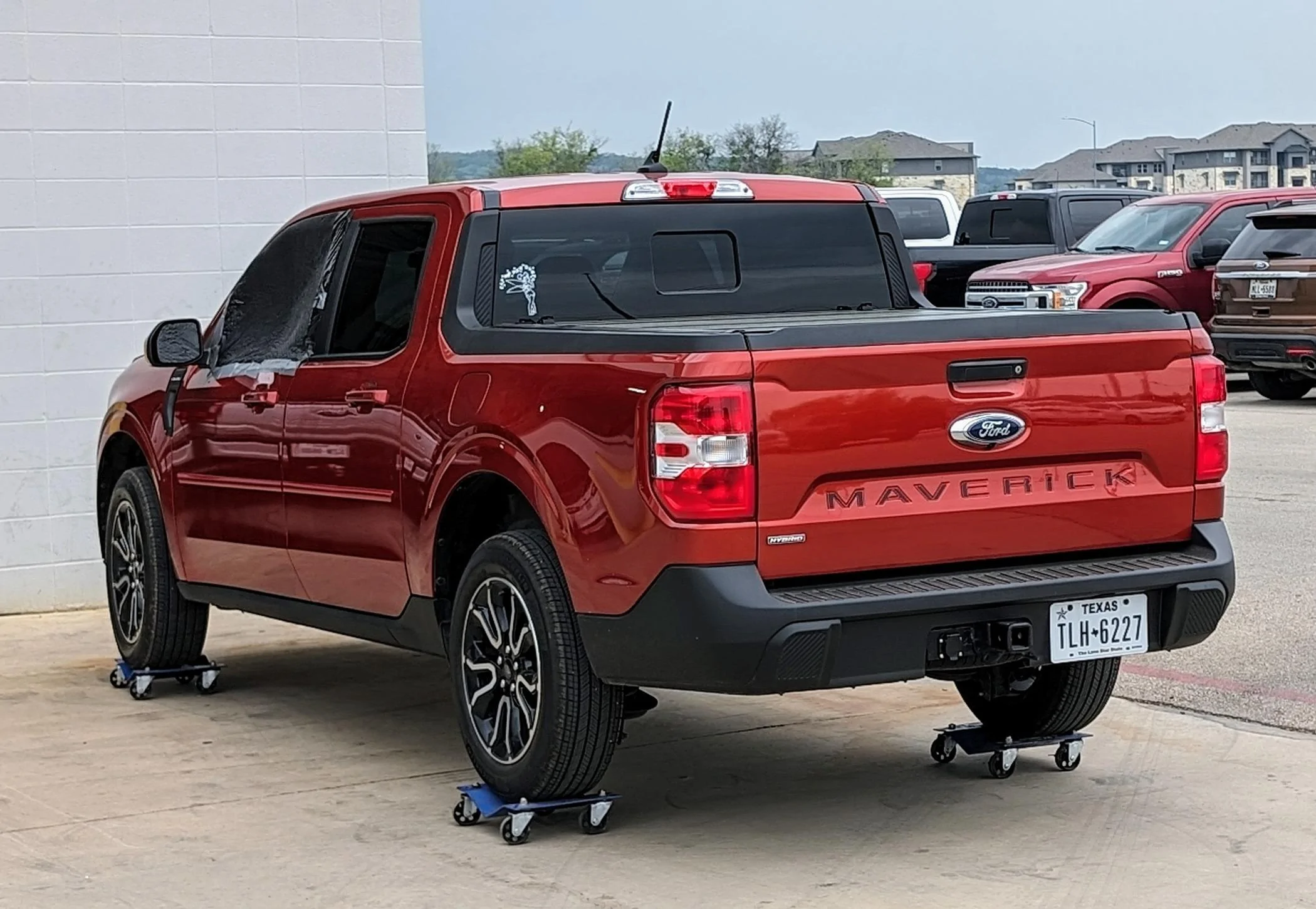

I took my 2023 Maverick Hybrid, for Its first oil change last month 03/2024. While it was at the dealer I asked for the blinker bulb recall to be performed. The dealer called two days later and said the update failed and could not get any thing to work. No Dash, or Start cant even roll up the drivers window. See attached picture they had to put it on roller skates to move it around. Some module was to be replaced and reportedly on order, with an unknown delevery date. Three weeks later I get a call that all was ready..... the tech finally figured out somthing to reboot the computer. I have the truck back and the oil was changed, no charge.... but the recall is still pending, and unfinished. I am very leary of any updates if the system can brick the truck that easily.. Has this been dicsussed on this fourm?

Sounds like they bricked a module when trying update it with the FDRS software. If something is interrupted during the update like the software or computer crashes, it can completely brick a module and that's probably why they had to order and new module and reprogram it to the factory settings (prior to recalls/updates)

I was told the new (unavaiable) module was not installed and they figured somthing out on how to hard reboot the system. The Ford App. reports the update stiil needs to be done. Maybe the next critical update will install and fix this issue. The oil change was not recorded in the history... and the infotainment/map system is acting differently.
