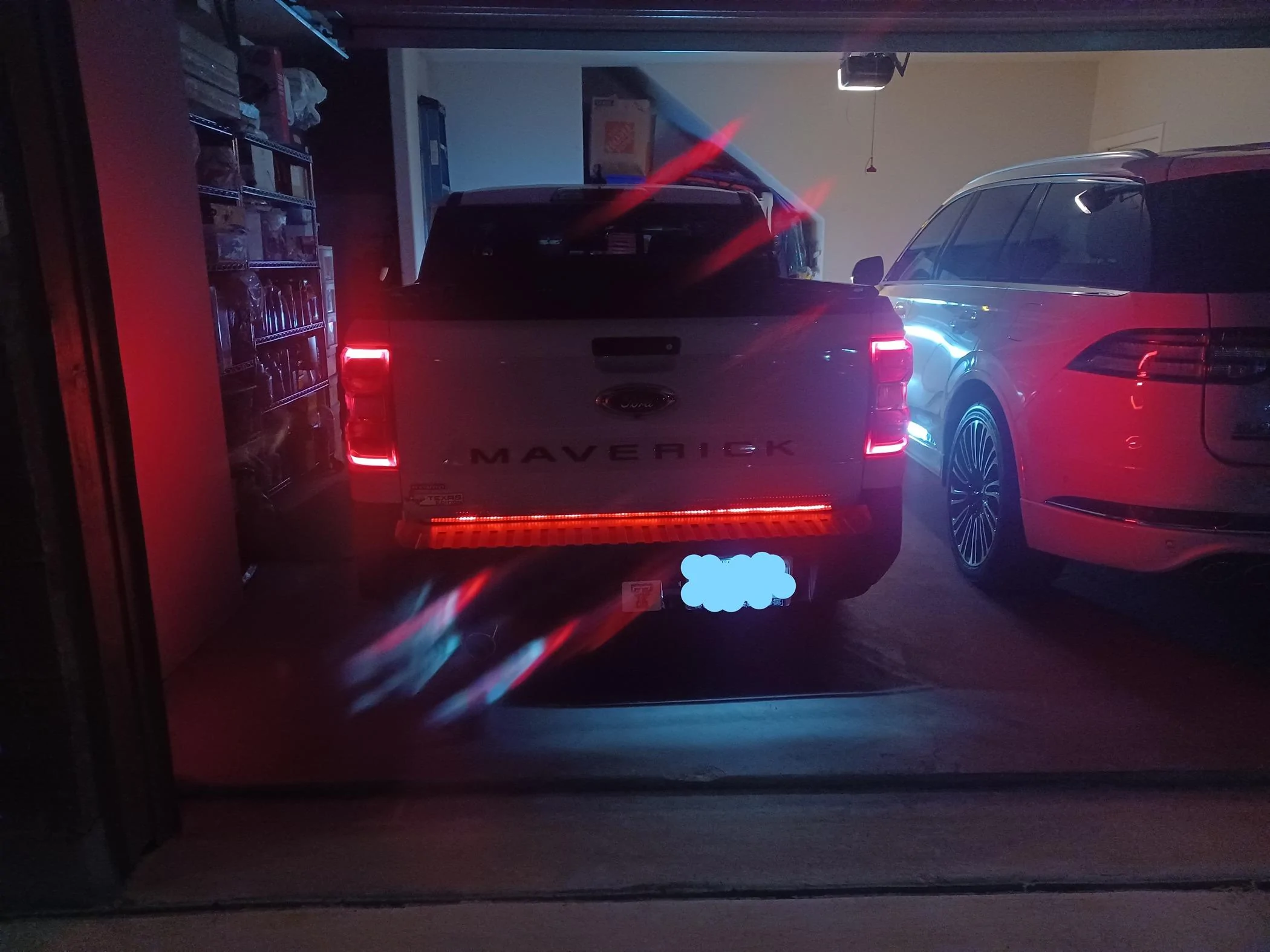

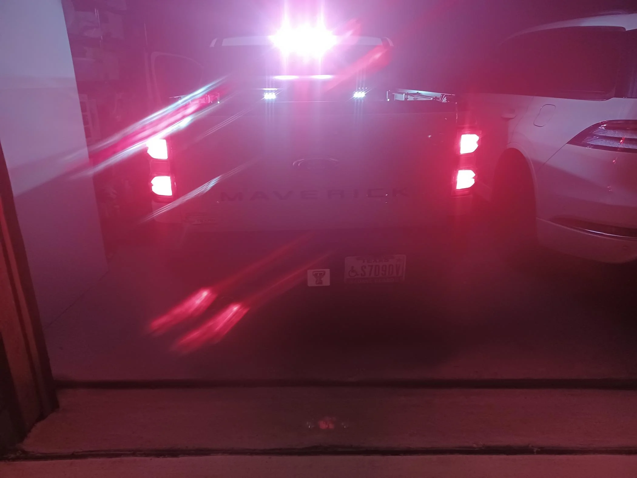

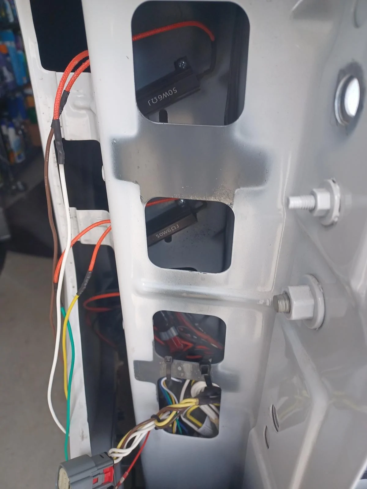

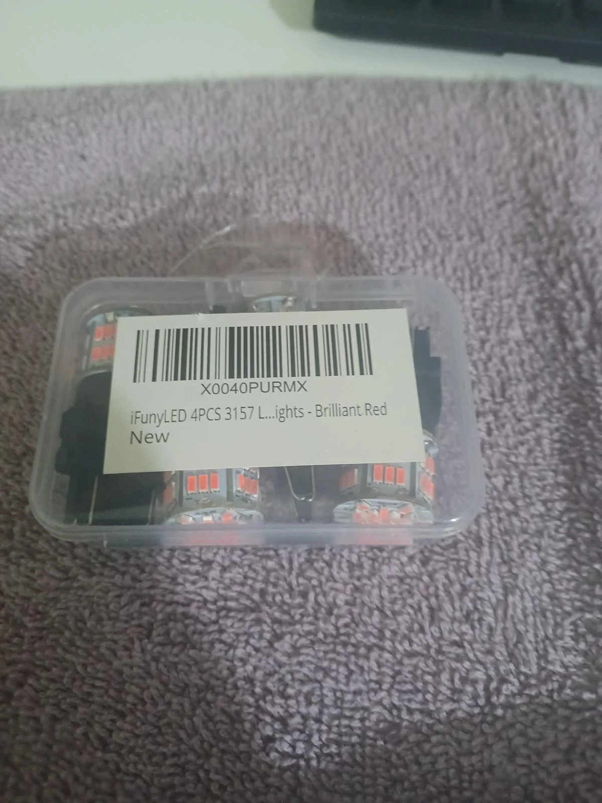

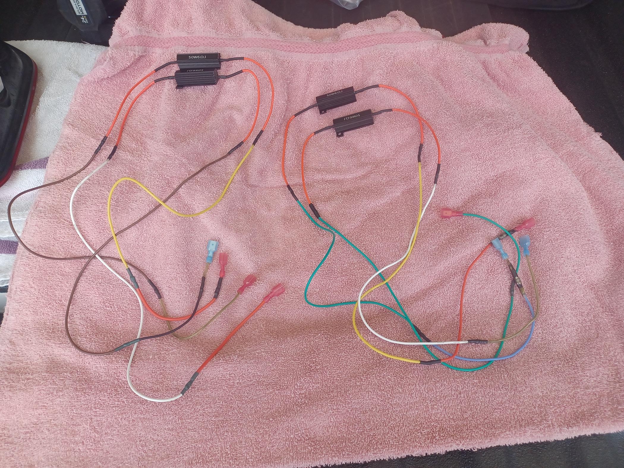

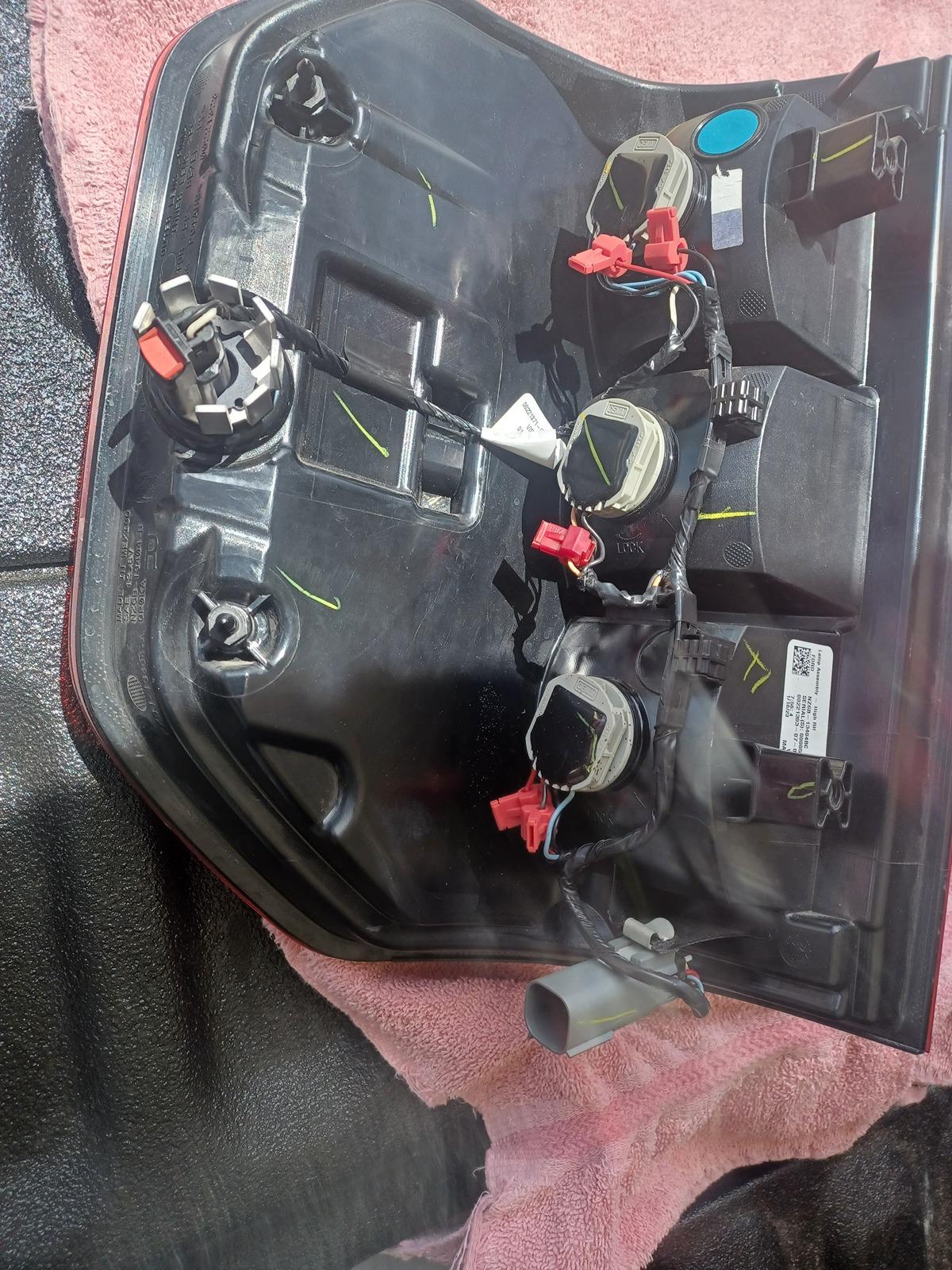

have a lariat Hybrid all lasfit bulbs rear turn signals hyperflash on dash after recall done. replaced lasfit led bulbs with stock halogen bulbs. i decided to add different brand of led bulbs for rear turn signal bought 3157 led bulbs ifunyled brilliant red from amazon 4 ea for $9.99 and osilly 50w 60hm resistors 4pcs from amazon $7.99 cut side tabs off 3157 bulb to fit in socket. enclosed pics on install no hyper flash works just fine for my liking plus i did the jmc6000 taillight mod to the 3157 led bulbs.
