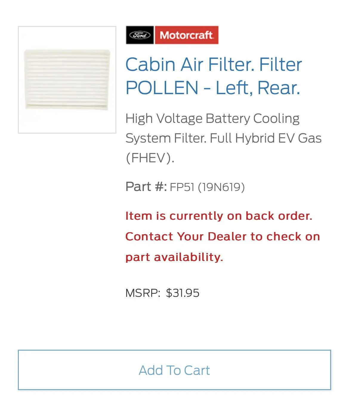

I was looking for part numbers for the cabin air filter and found that the hybrid trucks may have an air filter that filters the battery system cooling?
can anyone confirm?

Found this at fordparts.com
Ford Maverick Hybrid System Filter 8C723C82-02B3-4633-A0F5-C45612B33C51

Will Ford parts give a picture? The OLD escape ones were about the size of a recipe card and I'd be able to recognize it on sight.

That's a cabin air filter, not for the hybrid powertrain. It's also not the right part for a Maverick. Your manual specifies FP-89 for the cabin air filter.
Looking that up redirects to FP100A.
Parts: https://parts.ford.com/shop/en/us/f...abin-air-filter-15057523-1#/partMatched?pdp=y
Manual: https://www.fordservicecontent.com/...ingEnabled=False&userMarket=USA&buildtype=web
Also FYI, Rock Auto cross references the Maverick cabin air filter (FP-89 $35) as follows:
OE# JX6Z19N619BA (WIX- WP10019 or WP10019XP or Champ Labs CAF10059P)
K&N also makes this filter as VF3021 (Currently on Amazon for $41.98 with 20% off coupon)
$35 - 20k replacement interval? (I'm ordering the $35.71 lifetime K&N VF3021 from Amazon now).

I looked in the Ford parts catalog, no separate actual filter for the HVB, and using the Ford PTS Workshop manual, verified that the HVB is liquid cooled.
