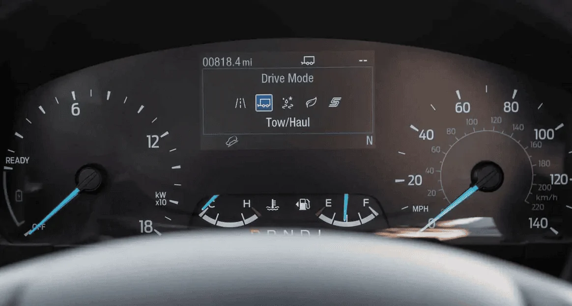

And then there's this Maverick power meter, which I've seen a few times in reviews. It implies 180kw, or ~ 240HP max....
Ford Maverick Hybrid Power Meter Calibrated 1717035673867-fx
That's a computer rendered image that was part of the Ford media packet pre-release. Hard to say how accurate/relevant it is.
Actually some other threads have shown that on non-US models at some point, with their Trip 1 showing so current info. I recall one saying Canada.
In which case it is like those speedometers that are willing to show speeds well beyond obtainable either realistically or with governor limit. Love how many cars show 160 mph.
That's a much bigger stretch of the imagination than 191 to 240 HP.
It doesn't look rendered, given the faint reflected images, and in any case, the calibration markings must have been considered in prototypes--again assuming that no other Ford has this exact same dash config-- before settling on % for production.
Given that, it is reasonable to suspect the Maverick power meter may represent some algorithm of combined torque and horsepower, representing an equiv kw of output. It is unlikely representing both peak or average power in absolute metrics, when the meter remains pegged at 100%. In other words, the meter is likely highly manipulated and at best a relative indicator.
Some dyno runs would clarify what the actual wheel torgue and derived horsepower are, as compared to the power meter. Surprised no one has done that in 4 model years.
