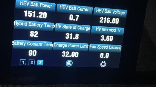

I got it working, ended up finding some custom PIDs on this post on f150gen14.com and loaded them into my Torque, there are many that don't seem to work with Maverick, when I have time I will clean up the PID codes and upload it here.
Ford Maverick Hybrid battery voltage meter . Screenshot_20230518-182547
This is INSANETY, I'm going to clamp a spare phone next to the cluster and record all my drives with a camera recording both at the same time for review later.
Torque Pro also has a very robust logging/graphing feature too, though I haven't used it in a long time so will need to relearn a lot of these features.
