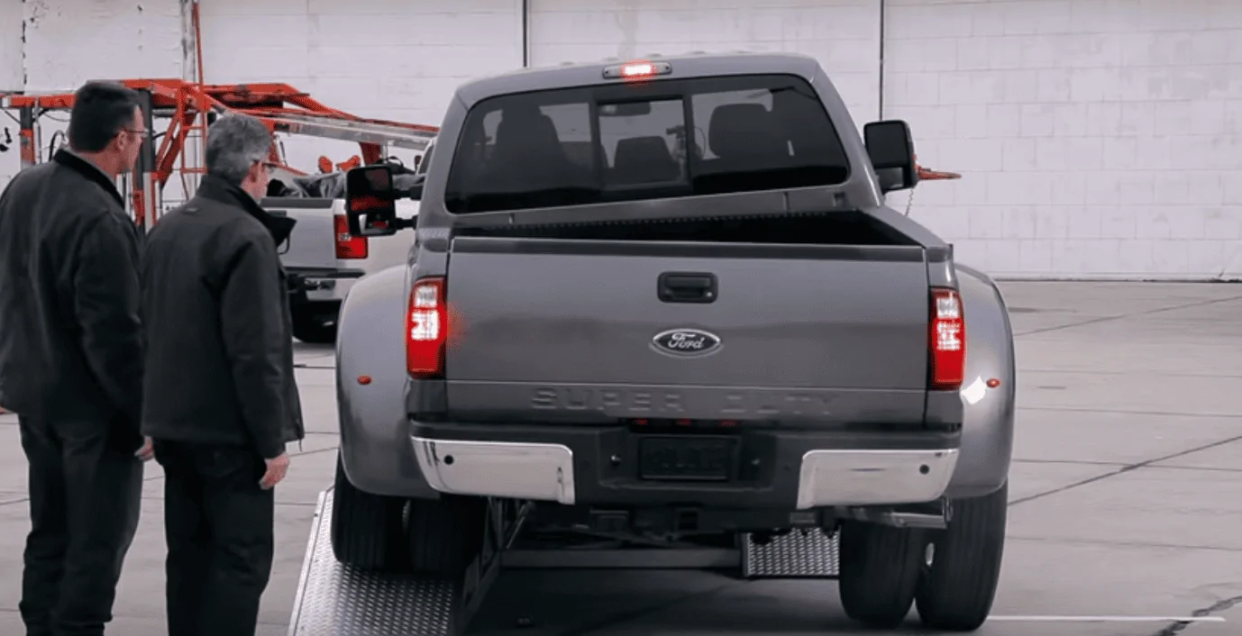

The Maverick ‘looks’ like the bed is separate from the cab (like in body-on-frame trucks) but it isn’t. A unibody truck doesn’t have the kind of torsional rigidity a body-on-frame has.
An F series Superduty truck can do this:
Ford Maverick Hybrid can tow 2000#...how many #s do you feel comfortable towing with it? fram
If that happens with your Maverick you’d be well and truly hosed.
