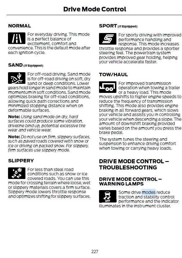

Agree that it would be nice to be able to manually control which gear you're in. However, check out page 227 of the Mav Owners Manual (you can find them online). The Drive Modes add different types of help by shifting the gears the way you would shift if you had manual control. For example, the Tow/Haul mode downshifts the transmission based on how hard you press the brake! I've never heard of that before, but that's just me. Maybe it's become common. After driving it, maybe I won't feel the need to manually shift the gears.
I am used to driving a stick in the snow. I am really hoping that slippery mode shifts like how I would in the snow and ice.

Thanks, now you're jogging my memory. I'm getting tow so I'll have haul. FX4 has the hill descent. I ain't getting that.
So I have to guess the Haul doesn't downshift down grades. Oh well.
[/QUOT
I am fairly certain that the tow/haul will engine brake. My last 3 Ford trucks did!

L mode will put the car in the lowest gear that makes sense for whatever speed you are in. It will be good for enhanced engine braking and for situations where you don't want the transmission to automatically upshift.
The primary use of it, if I ever use it, will be for the few times I do steep grades near Uniontown PA. I imagine it would be useful for putting torque down to get through snow.
Slippery mode seems to me to be for when you want to reduce slip, not make progress. I would not recommend slippery mode for getting through heavy snow or mud.
If all you want to do is have more engine braking L mode will do exactly what you need.
from the manual
In low (L) your vehicle decelerates more noticeably than in drive (D) when the accelerator pedal is released.
Note: We recommend using this mode for driving on hilly or mountainous roads or when towing a trailer. See Towing a Trailer
