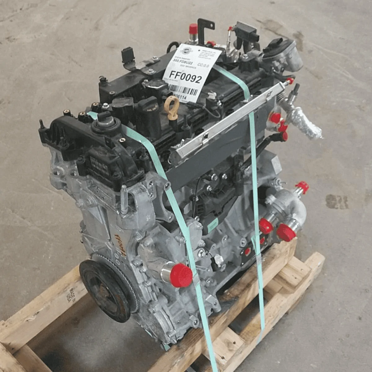

I'm thinking if you could access the front damper bolt from under the RH wheel arch and turn the engine over would it start?

I super doubt it- it's a planetary gearset.
No - I'm wondering if you could start is by driving the front damper bolt. I have started engines this way - on a stand not in the vehicle.
Does the Maverick hybried ICE have an accessible front damper bolt?
This engine does not have a fan belt.
