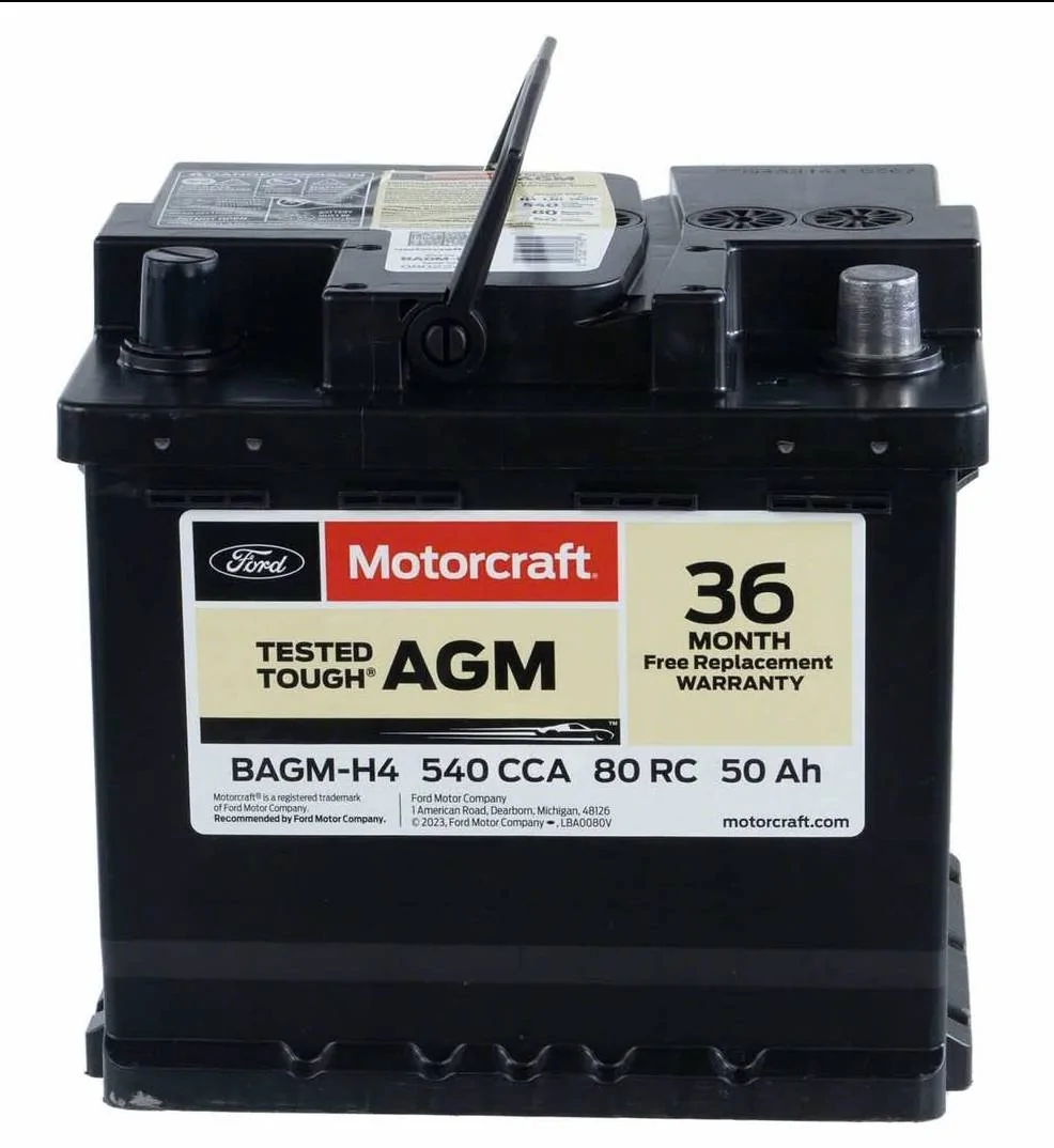

Ford does have as an H4 AGM Battery used in the Corsair & the '25 Maverick but Amazon has less expensive ones.
