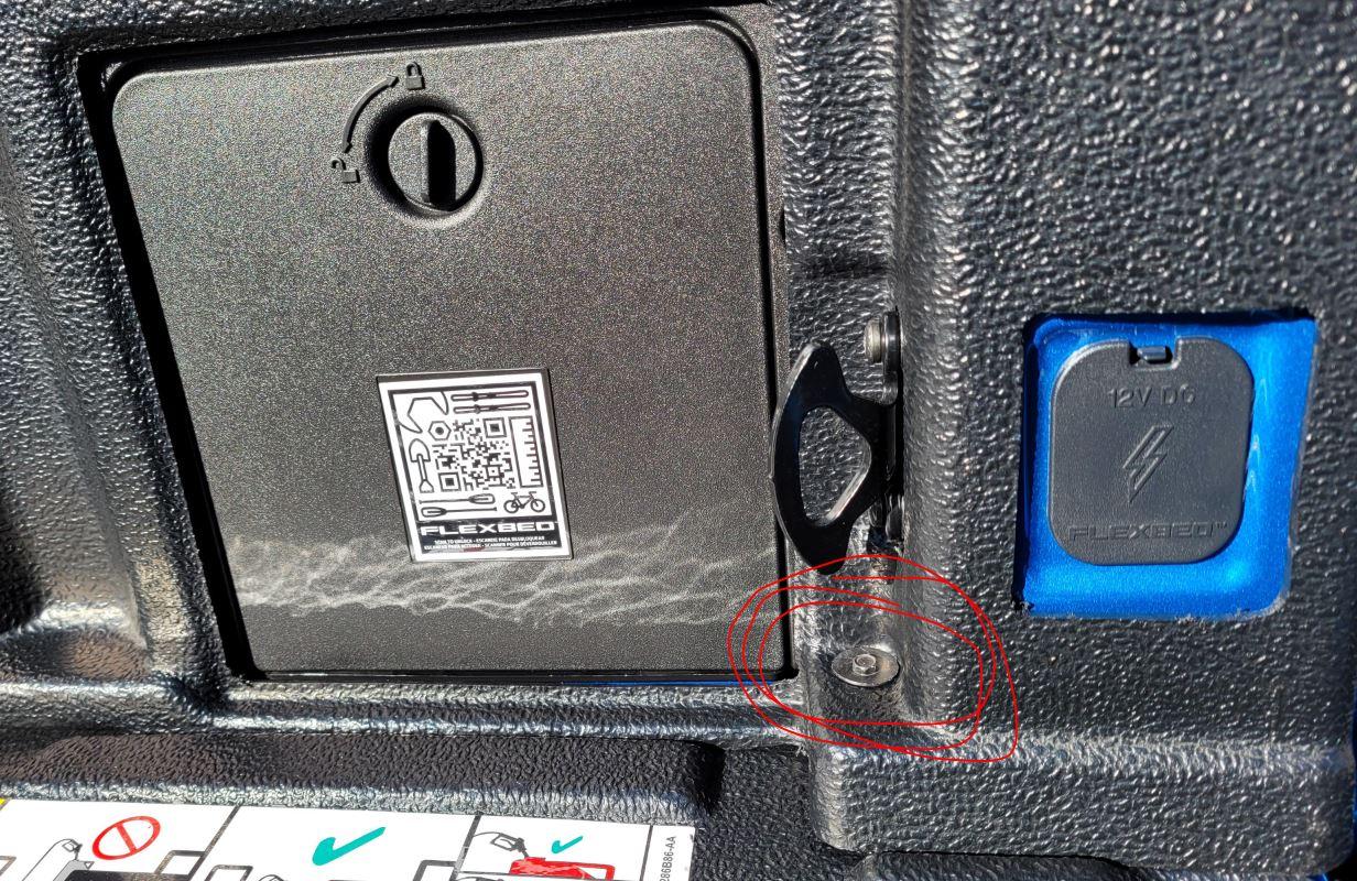

You can with a bit of luck just unscrew the little bolt/screw that is near the bottom of each side panel close to where the cutout will go (close to the tailgate). I believe there is only one on each side, and the rest is just pulling each side panel down/out from under the top rail of the side bed where they have been sort of wedged in. Then you can see the guides for where to cut on the back of each side panel.
Not my photo, but I did circle in red what I am talking about.
