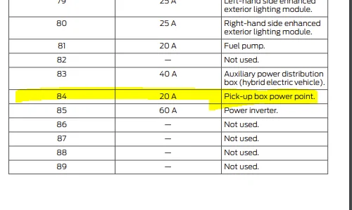

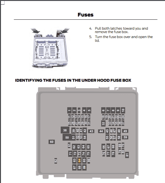

Can anyone tell me which fuse box and which fuse is the one that goes to the 12 volt outlets in the bed area. The ones designated for the 12 volt accessories.

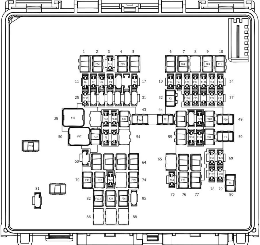

Bed 12V Powerpoints shows F34, a 20A Slotted MCASE+ Fuse.
Engine compartment fuse.
Ford Maverick Which fuse for 12 volt accessory outlets in bed BJB Fuse Position & Fuse#
Ford Maverick Which fuse for 12 volt accessory outlets in bed BJB Fuse, Position, Amps, Circuits Protected
Ford Maverick Which fuse for 12 volt accessory outlets in bed Bed 12V Powerpoint RH, LH - F34 20A MCASE+ Fuse in BJB
Bottom 20A next to Inverter 60A HT (High Temperature) fuse.
Ford Maverick Which fuse for 12 volt accessory outlets in bed F34 20A Slotted MCASE+ - Bed 12V Powerpoint

Thanks guys. I thought I’d already checked #84 as shown in the manual but have not checked #83 as BlueSpec1 showed. Will check that next.
