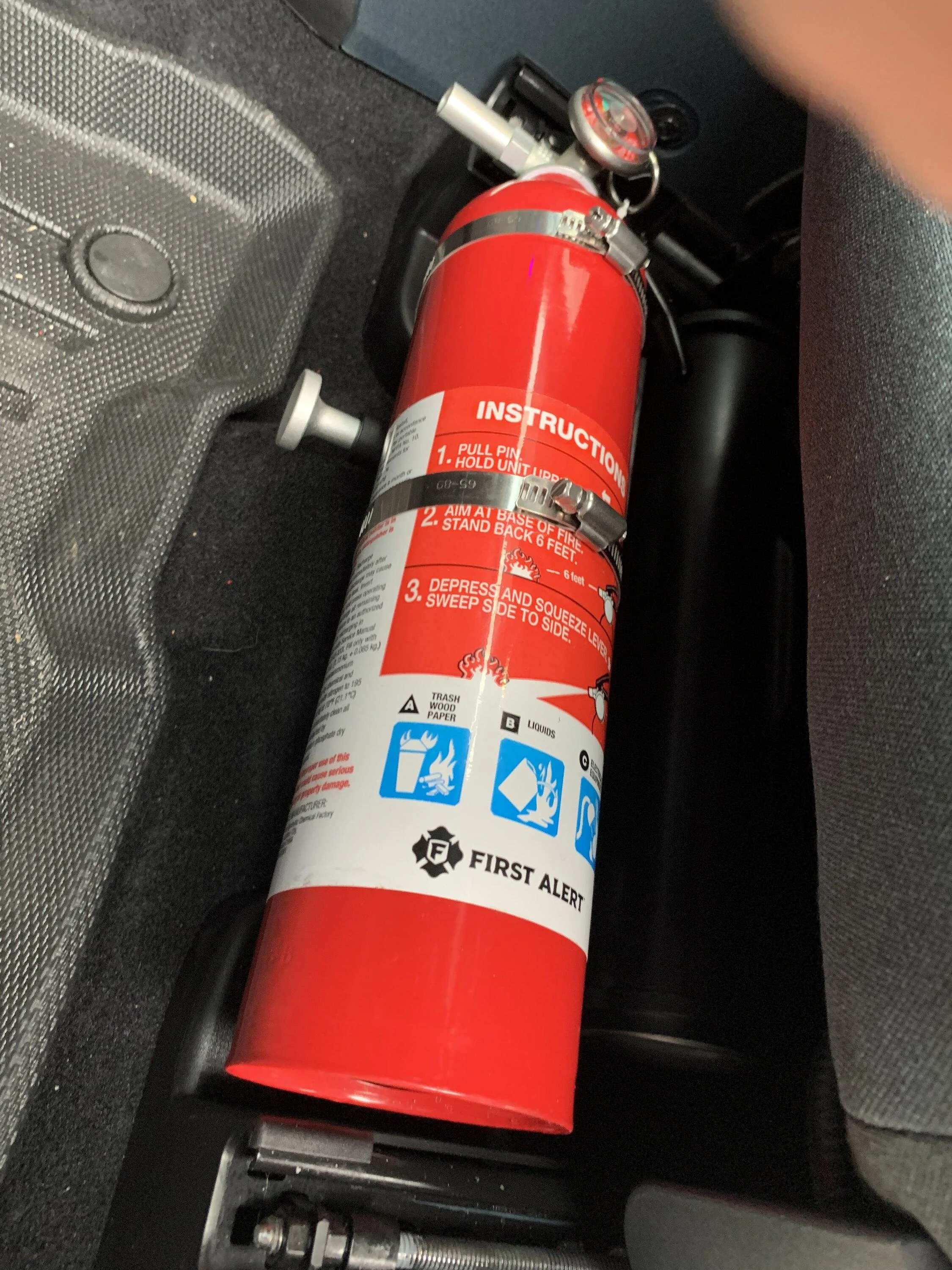

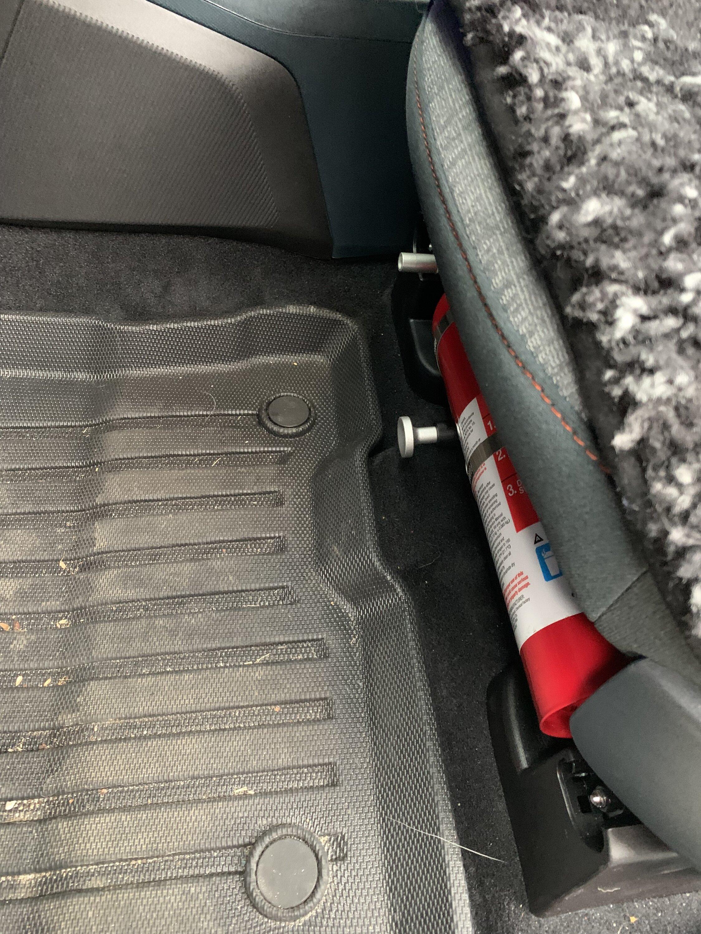

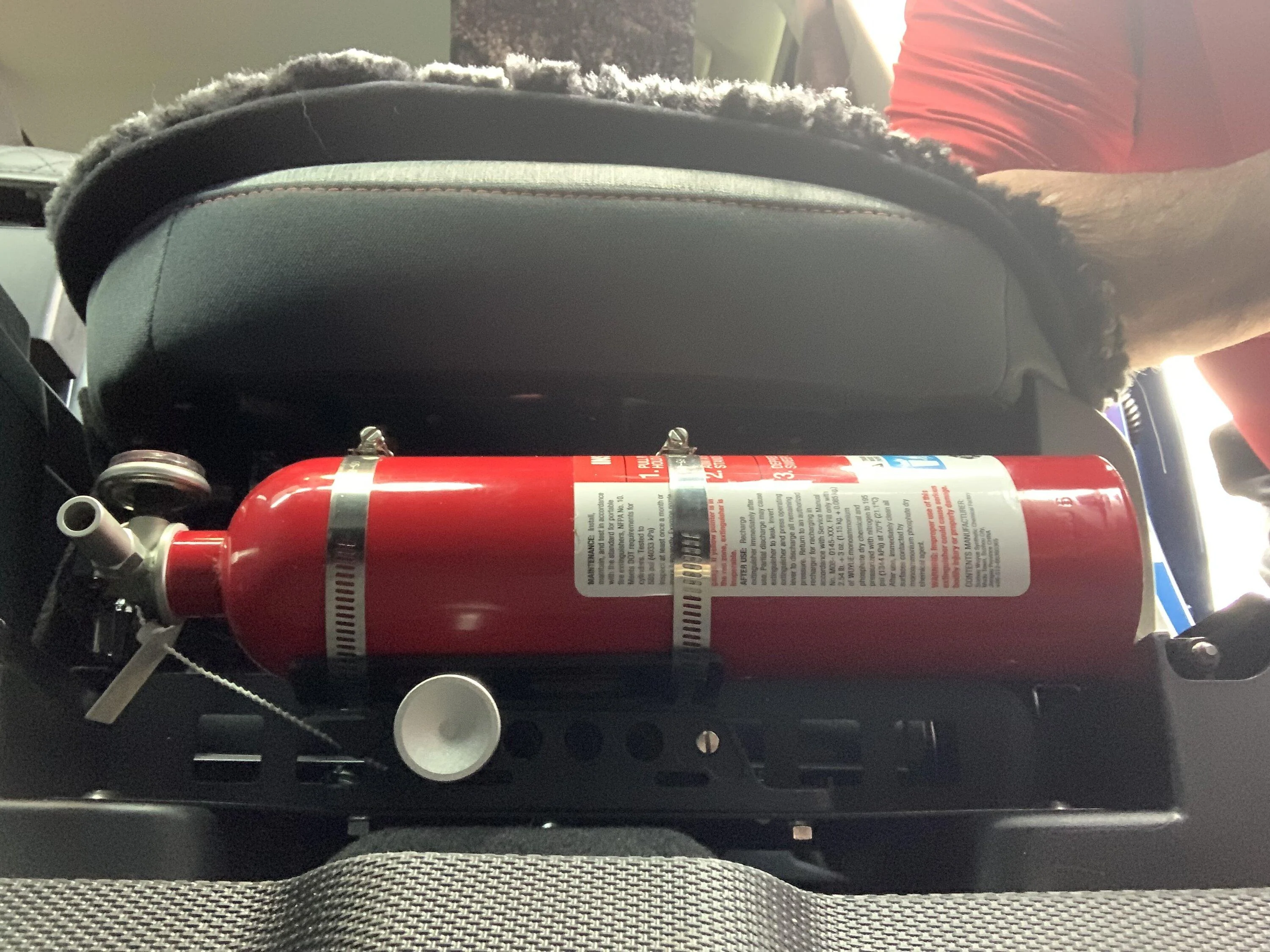

Today I installed a bracket and quick release mechanism for my vehicle fire extinguisher under the driver’s seat. The bracket holding the extinguisher I obtained from AliExpress at a cost of about $10. When the silver knob shown in the photos is pulled out, the extinguisher, still attached to the upper portion of the bracket, can be rotated up and out of the bracket’s fixed base. The lower bracket is secured to an L-shaped metal angle piece. It in turn spans and is anchored by two bolts that are screwed to the truck floor replacing OEM bolts found on either side at the front of the seat’s rails. My L-shaped item was repurposed from another product. What I like is that the extinguisher is readily available once I roll the seat to the rear. Until I need it, it is basically out of sight. What do you think?
