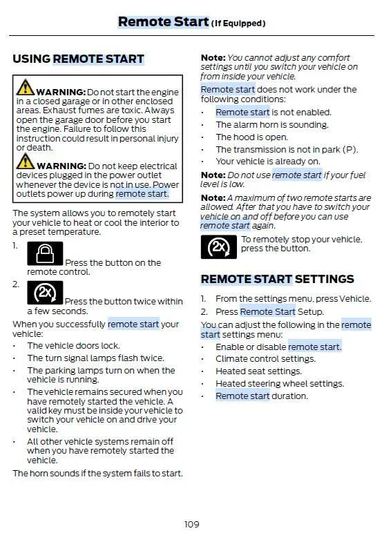

squirlz Well-known member Joined Apr 23, 2024 Threads 5 Messages 129 Reaction score 135 Location Madison, WI Vehicle(s) 2025 Maverick XLT Hybrid AWD Engine 2.5L Hybrid Jan 25, 2025 #2 If it is a 25MY, this is what the manual states.
d7602002 Well-known member First Name Joseph Joined Aug 9, 2024 Threads 3 Messages 523 Reaction score 1,179 Location Michigan Vehicle(s) 2024 Maverick XLT Engine 2.0L EcoBoost Jan 25, 2025 #3 I thought all you had to do when it was remote started and it was running was to just hit the two times button and it would shut it off.

OleFordGuy Well-known member First Name Craig Joined Dec 5, 2021 Threads 39 Messages 3,905 Reaction score 6,293 Location Alabama Vehicle(s) 11 F150 Lariat, 24 Expedition Limited, 22 Mav Lariat AWD Engine 2.0L EcoBoost Jan 25, 2025 #4 I'm not 100% sure, but I "think" you press the 2X button on the FOB twice when its running to turn it off, just like you would press it twice after pressing the lock button to start it remotely.

Ozarkbeard Well-known member Joined May 22, 2022 Threads 14 Messages 4,342 Reaction score 5,480 Location . Vehicle(s) . Engine Undecided Jan 25, 2025 #5 FWIW, if anyone reading this thread has added Start-X and is wondering if they can remote-stop their truck: To start the truck, press Lock> Unlock> Lock To stop the truck, press Lock> Unlock> Lock again.

Toddman45 Well-known member First Name Todd Joined May 21, 2024 Threads 27 Messages 2,022 Reaction score 2,844 Location St. Louis, MO Vehicle(s) 24' Ford Maverick XLT, 19' Ford Explorer Limited, 14' Chevy Equinox Engine 2.0L EcoBoost Jan 25, 2025 #6 squirlz said: If it is a 25MY, this is what the manual states. Click to expand... Same for 22-24. Sponsored
