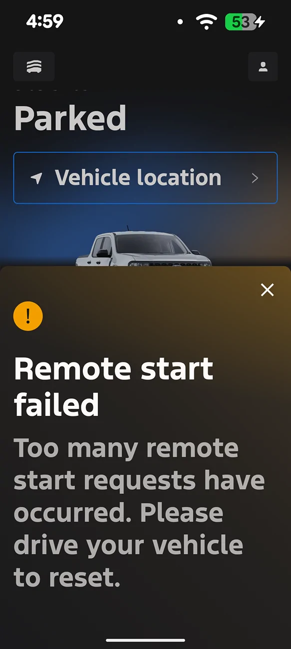

But no remote starts? - because yes that would affect an EB too.
Deep sleep mode after 14 days not driving - yes that should have affected you too. EB's get it also.
Do you use Fordpass app - did you open it to attempt something remotely?
No, I went on vacation for the holidays, I didn't think of performing any remotely starting. Truck started up with no issues when I got back

Are you saying my truck still goes only sleep mode, my dome lights don’t work after the car is shut off, and my remote start doesn’t work?
Something was shutting all that stuff off after my vehicle ignition was turned off. When I exited my vehicle after a drive and re opened my door the dome lights would not turn on. 10 min later I’d get a remote start deactivated and no ford pass communication. This would aslo happen with a battery charger on. I tested my battery with my works expensive battery tester and it passed all checks.
They made updates to software and modules and referenced by numbers and letters.
The symptoms I’ve been having have been solved and it took two trips to the dealership. It’s been months now and I have no issues.
I’ve looked at your Debbie downer posts on here. Might be time to trade your car in for a Honda.
I worked with my dealer and they got me a solution that is working. I’d tell everyone to do the same. If they can’t fix it that’s when I need paperwork saying “we can’t fix it”. Not all mavericks have the same issues and that’s very confusing to everyone. I guess I’m just lucky.
You had the ACCM software update - and that was your issue. Probably.
Or you had a stuck SOC% value in the TCU, so no matter how good it currently was - it acted on a value that was too low from before and kicked off the actions.
Again an update.
Again an update.
Dug through my paperwork, Yep ACCM update. They also reset my fordpass.
My '23 Tremor sat at the airport for 16 days while we were enjoying our vacation.
The truck started right up as one would expect it to, the difference is that when we unlocked the truck ( with the key fob ) and opened the doors, the dome light DID NOT come on. This is an indication that the truck went into "battery saver mode" or as it is also called "deep sleep".
As far as I understand it, that operational mode shuts down unnecessary, or non critical modules, including your Telematics (therfore remote functions are unavailable) to conserve the state of charge of the battery so that the vehicles WILL start.
It may be different for the Hybrid owners, but, I think the operation of this festure is the same for all Mavericks- and many other vehicles, especially Ford's -
Personally I pulled fuse 11, no Telematics, no APP, no notifications about the truck taking a nap if I don't drive it for an extended period. The truck starts everytime I turn the key, or use the remote start on my key fob and that’s what matters.

It's the same type of question as how to disable the ASS (auto start stop) legit question , I'm merely asking if anyone knows how to remove the 2 remote start limitation, if you don't know, don't worry about it, no need to get snarky.
Ask the same question over and over all you want. You got the answer on the first page. The answer is simple, you cannot with the consumer interface in the truck.
Maybe with Forscan, but I’m not an expect on that software. It may require a dealer level scan tool, if it can even be changed.
