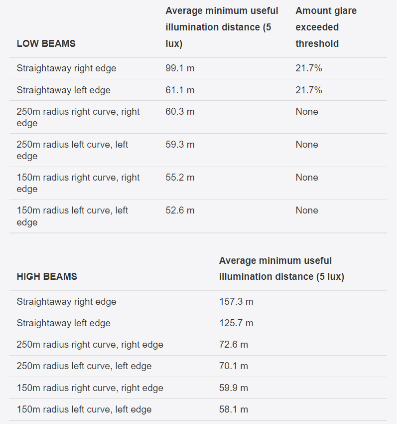

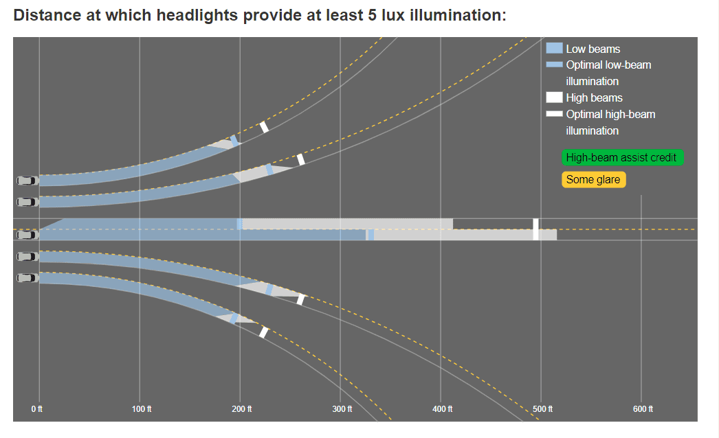

iihs headlight test rating was Acceptable. There is definitely room for improvement. 1) Reduce glare on low beams. 2) Improve high beam illumination on left side. 3) I would like to see upgrade to curve-adaptive headlights.
Low beams
  • On the straightaway, visibility was good on both sides of the road. On curves, visibility was good on the sharp right curve and fair on the gradual right and both left curves.
  • The low beams created some glare.
High beams
  • On the straightaway, visibility was good on the right side of the road and inadequate on the left side. On curves, visibility was fair in all 4 tests.
  • High-beam assist compensates for some limitations of this vehicle's low beams on the straightaway, on both left curves and on both right curves.
Unlikely to see those in an entry level model vehicle. The headlight units are already over $1k a pop, make them adaptive and that shoots up $2-3k per unit. People here freak out over $300-400 price jumps, just imagnine what they'll do if the price goes up $4k just due to the headlights!
