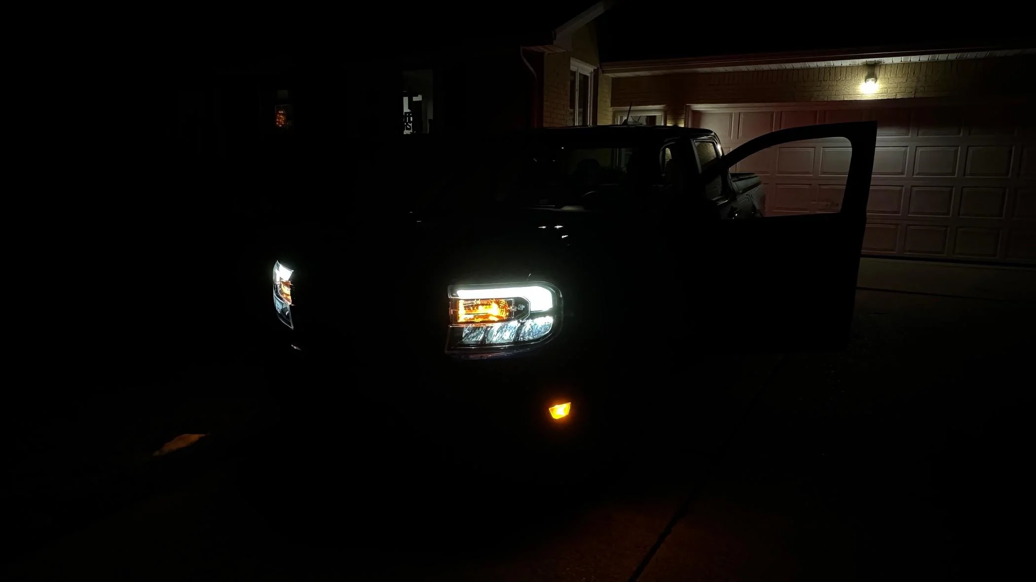

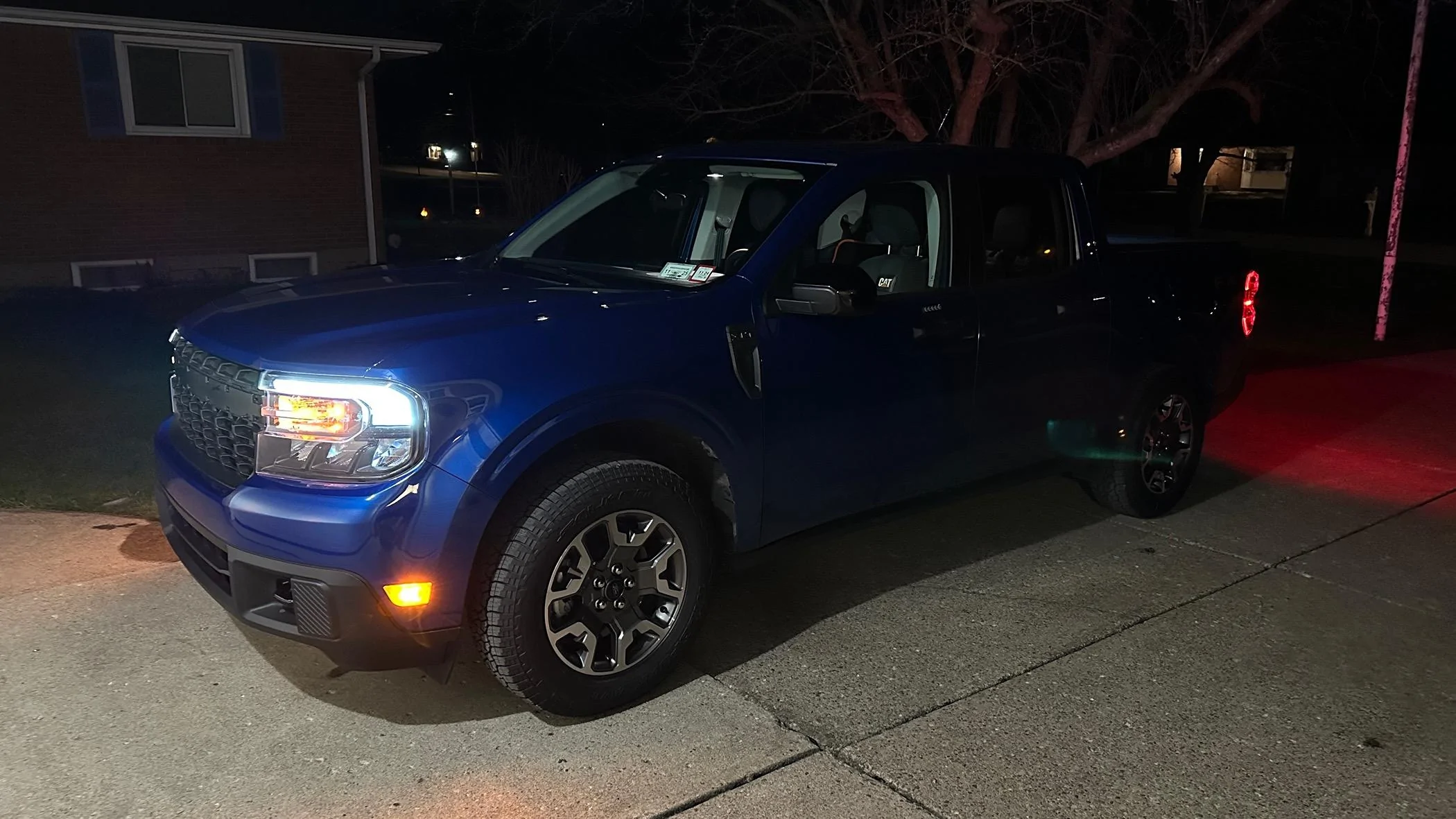

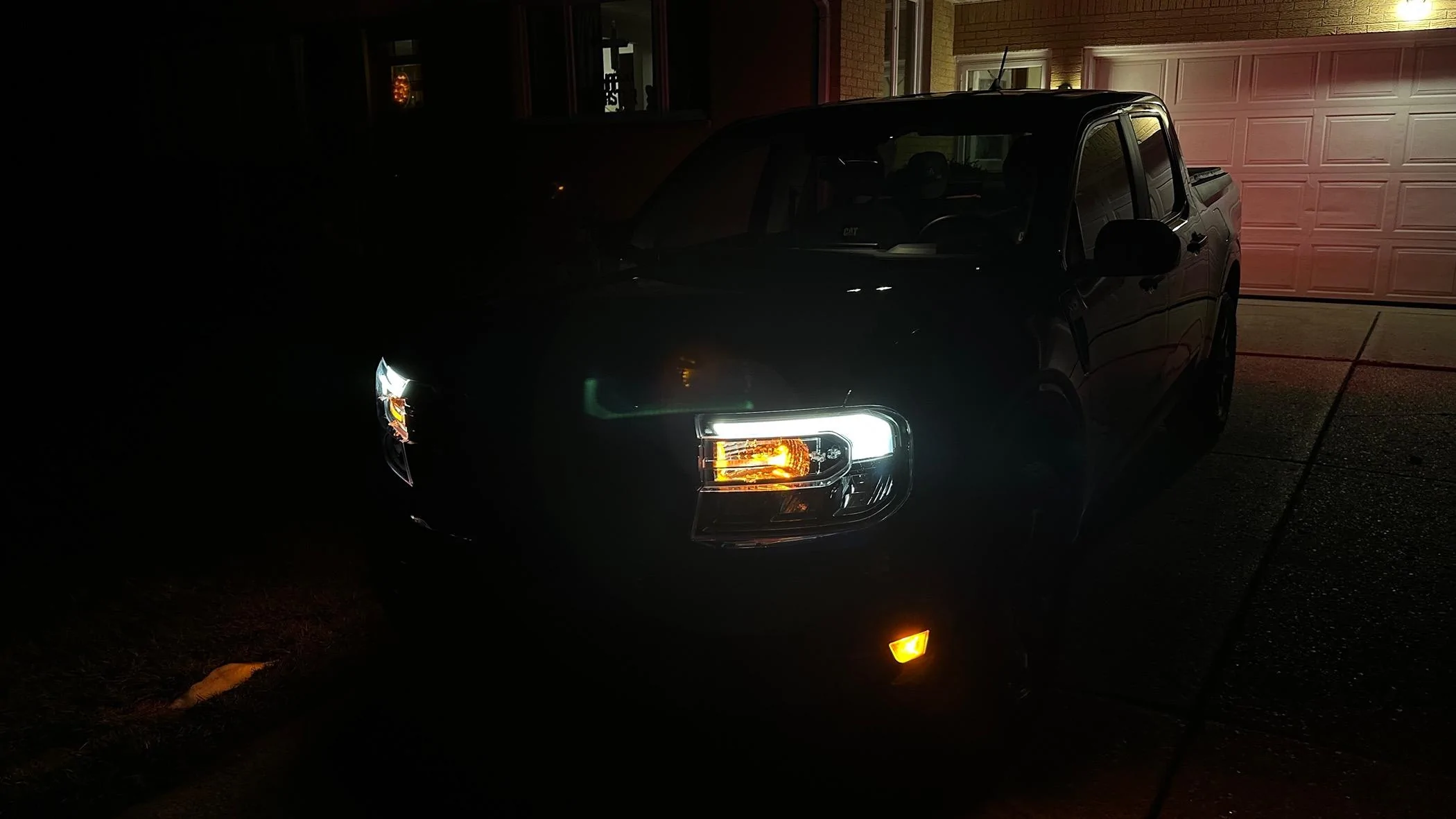

Well for anyone interested, the DRL’s on top work on my XLT now. Not sure how.. I haven’t changed anything in the BCM in the last day or so. I went out tonight to grab something from my truck, when I unlocked it, the lights came on! And they work with DRL mode too!! Thanks to everyone for the advice!

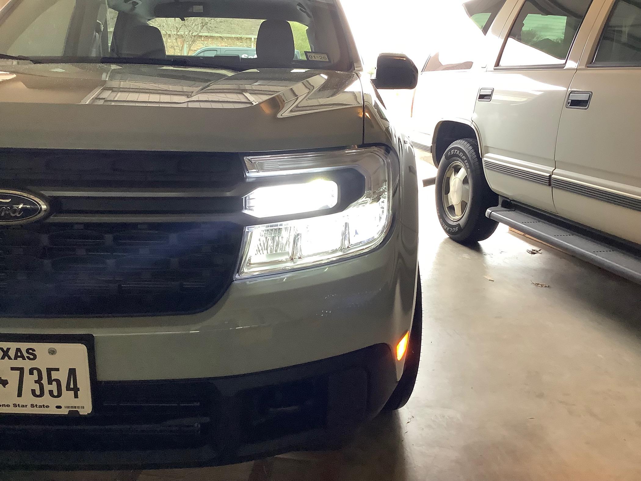

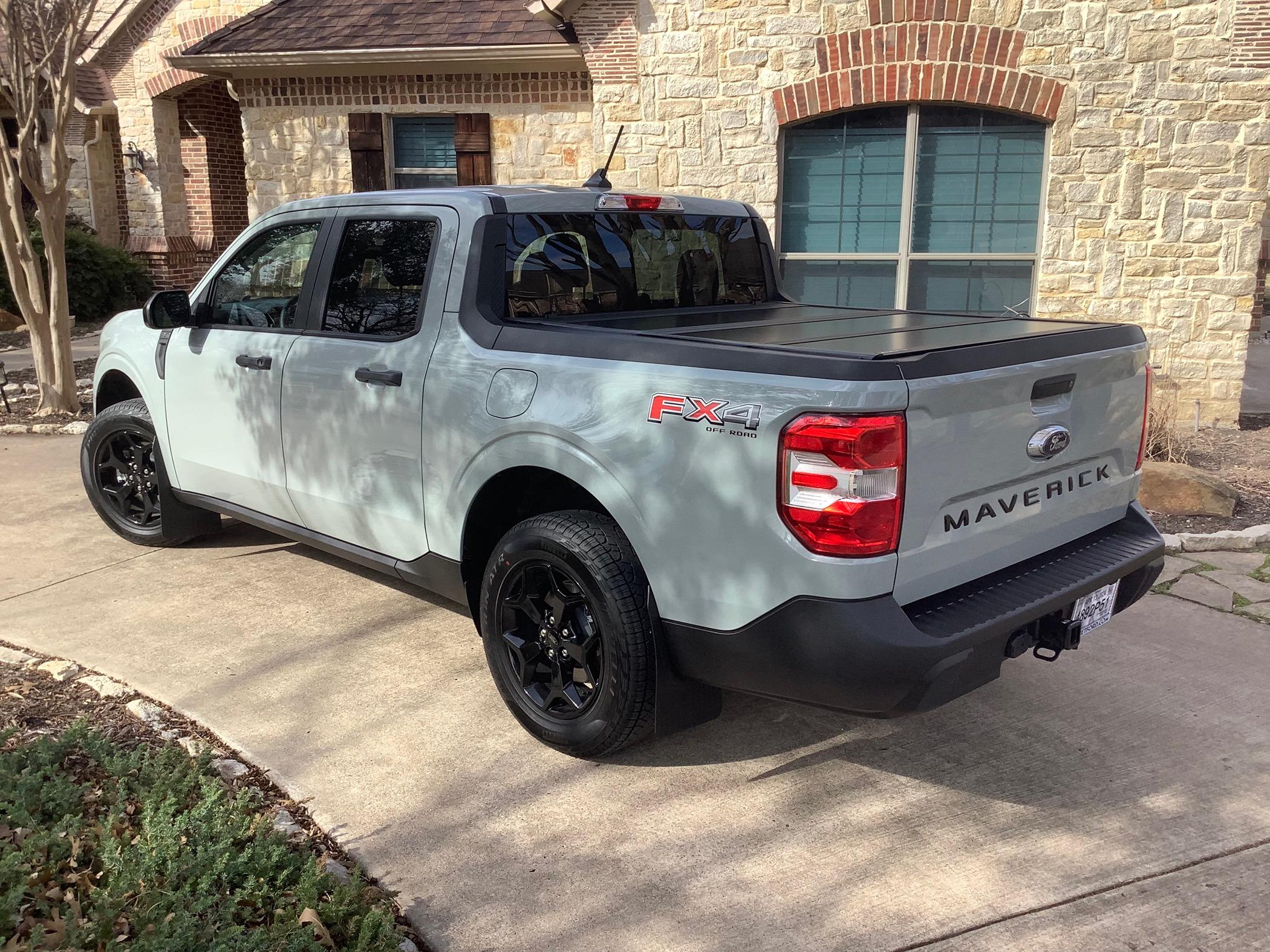

I may be all wet, however I have a 24 XLT FX4 that, I to, would like to consider the BAP head And tail light assemblies. Trying to order the BAP isn‘t allowed with the FX4 package, which I am sure you are aware.
The approach I am considering is to purchase the XLT BAP headlight assemblies, and install Lasfit Switchback Directional Signal LED, which I have already done to my standard assemblies. They look and work great. During the day, the DTRLights are white in appearance and turn amber when signaling. At night, all lamps are white and are similar in appearance to the Lariat style, but no light in the upper part of the assembly As does the Lariat version, but you can’t tell because of the combined intensity of both LED lights.
Obviously this approach requires zero wiring or programming changes. I don’t know if you can return the Lariat BAP assemblies. Just a thought.
I also forgot. The BAP taillights are plug and play. Work with no modifications whatsoever. I’ll send part numbers in the morning to make ordering easier.
