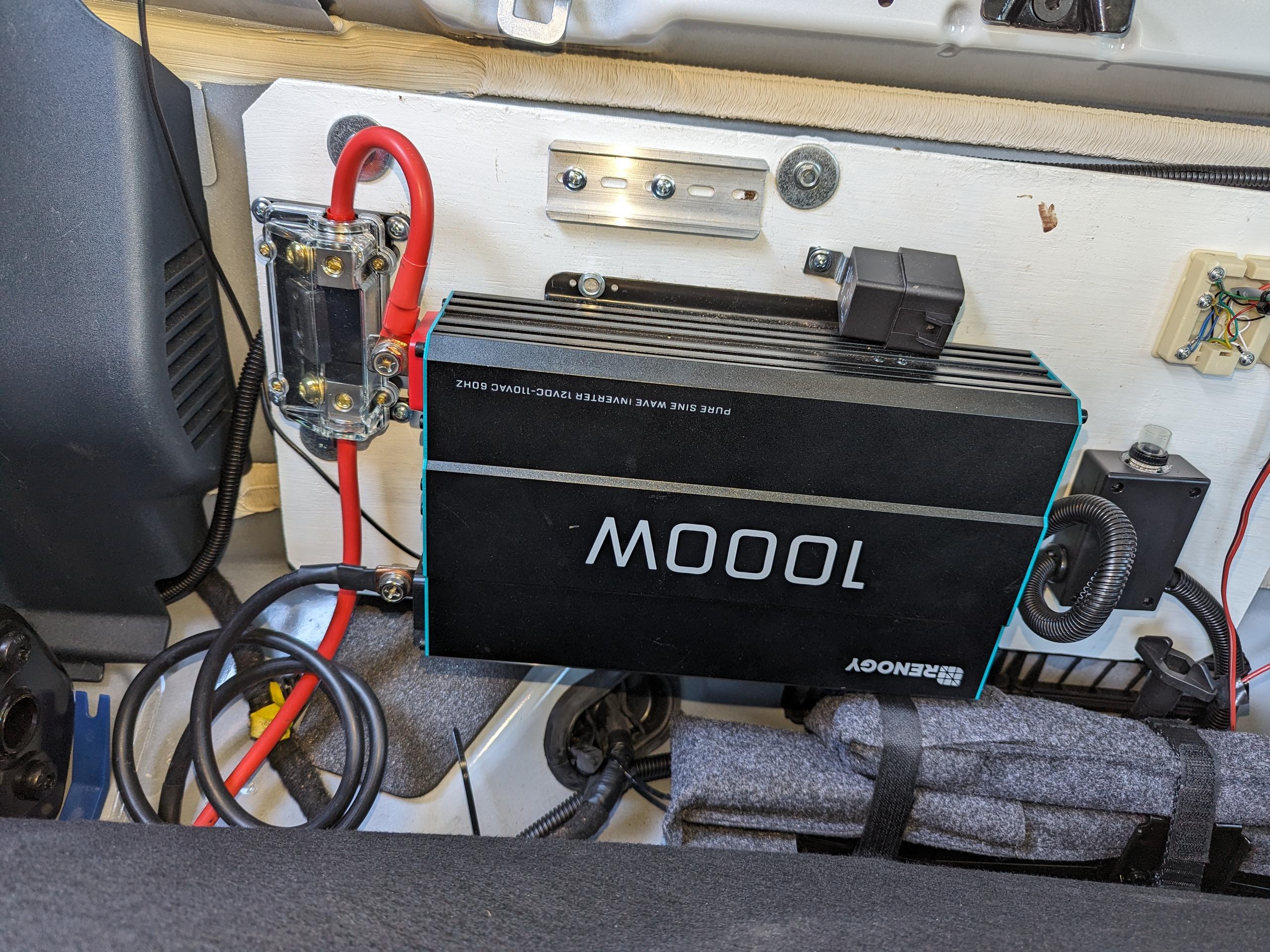

I installed a 1KW PSW inverter behind the rear seat mounted to the bracket for the audio upgrade which I don't have. I wired it through a 100A fuse to directly to the battery.

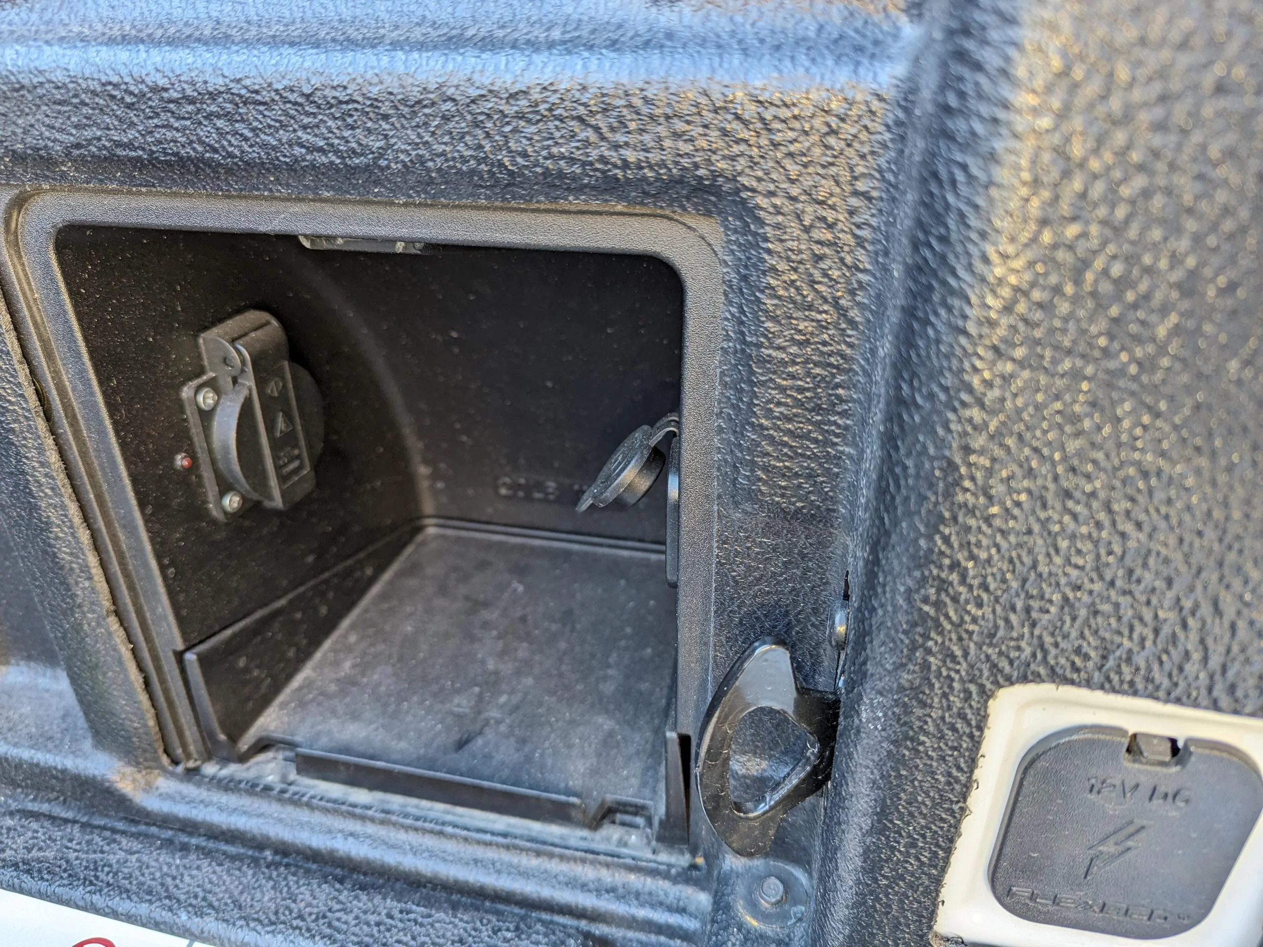

I installed an outlet in the right cubby. Wiring it through the floor.

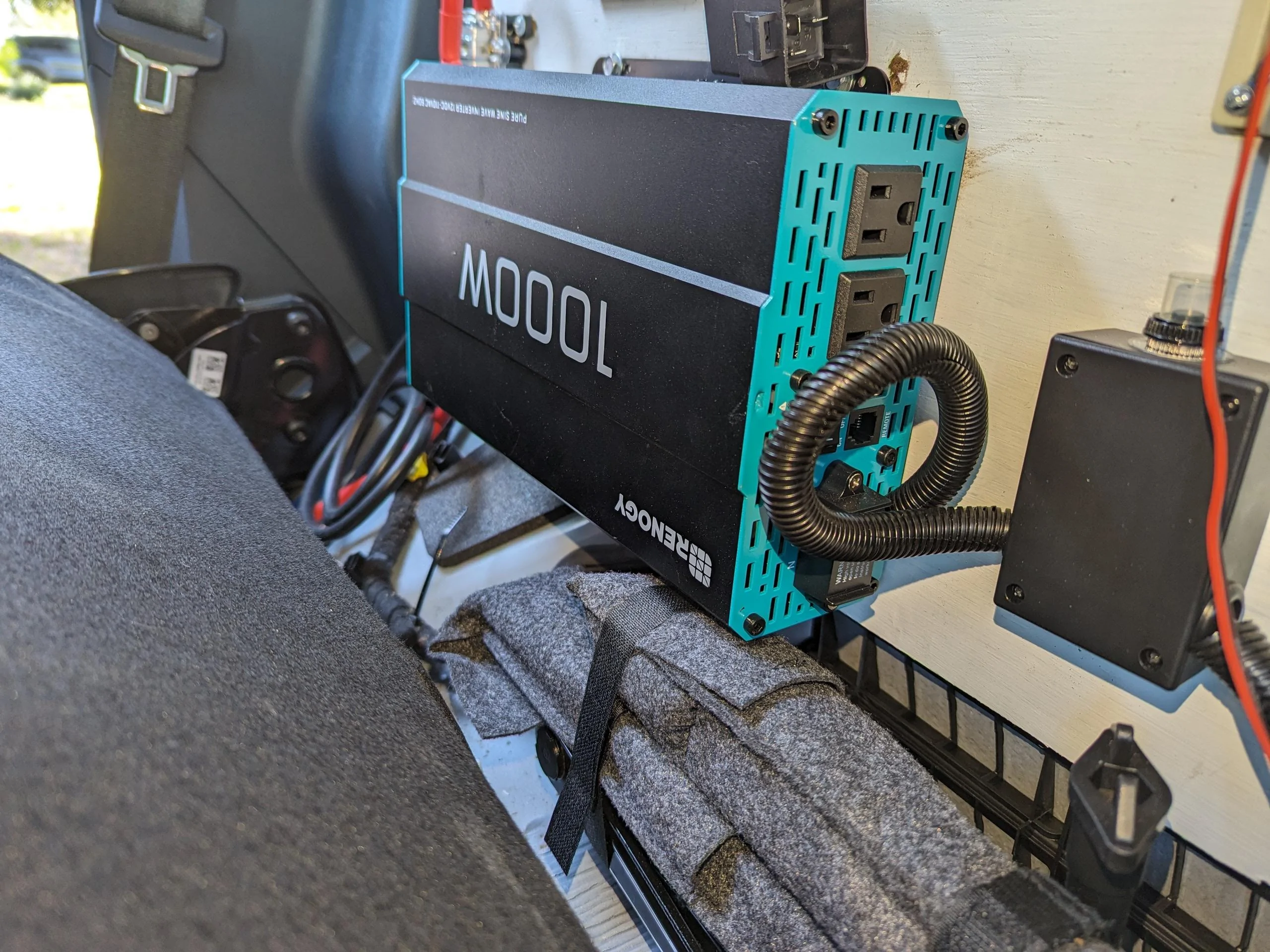

As you can see I attached a thin plywood panel painted white to the unused audio bracket.
The inverter and a 12v/100A fuse are installed to the panel. The small black box on the right of the inverter is a circuit breaker for the 110 V circuit.
The Renogy inverter has an output to hard wire the the 100v wires. Inverters with a plug receptacle output would work just as well.
I ran 16/3 gage SJOOW inside HF 3/8" protective wire wrap from the inverter to the circuit breaker to under the seat. Under the seat, under the storage panel, is a black rubber boot in the floor. I went through the boot to under the truck. From there I went up and over the heat shield and back the opening under the cubby. Zip-tying the wire wherever I could

You would have to size the wiring larger for your 2KW inverter.
Mine currently works as I want it to but it is still a work in progress. I am adding a remote control to the dash and connecting it to the vehicle start circuit so I have to have the key on to run the inverter..

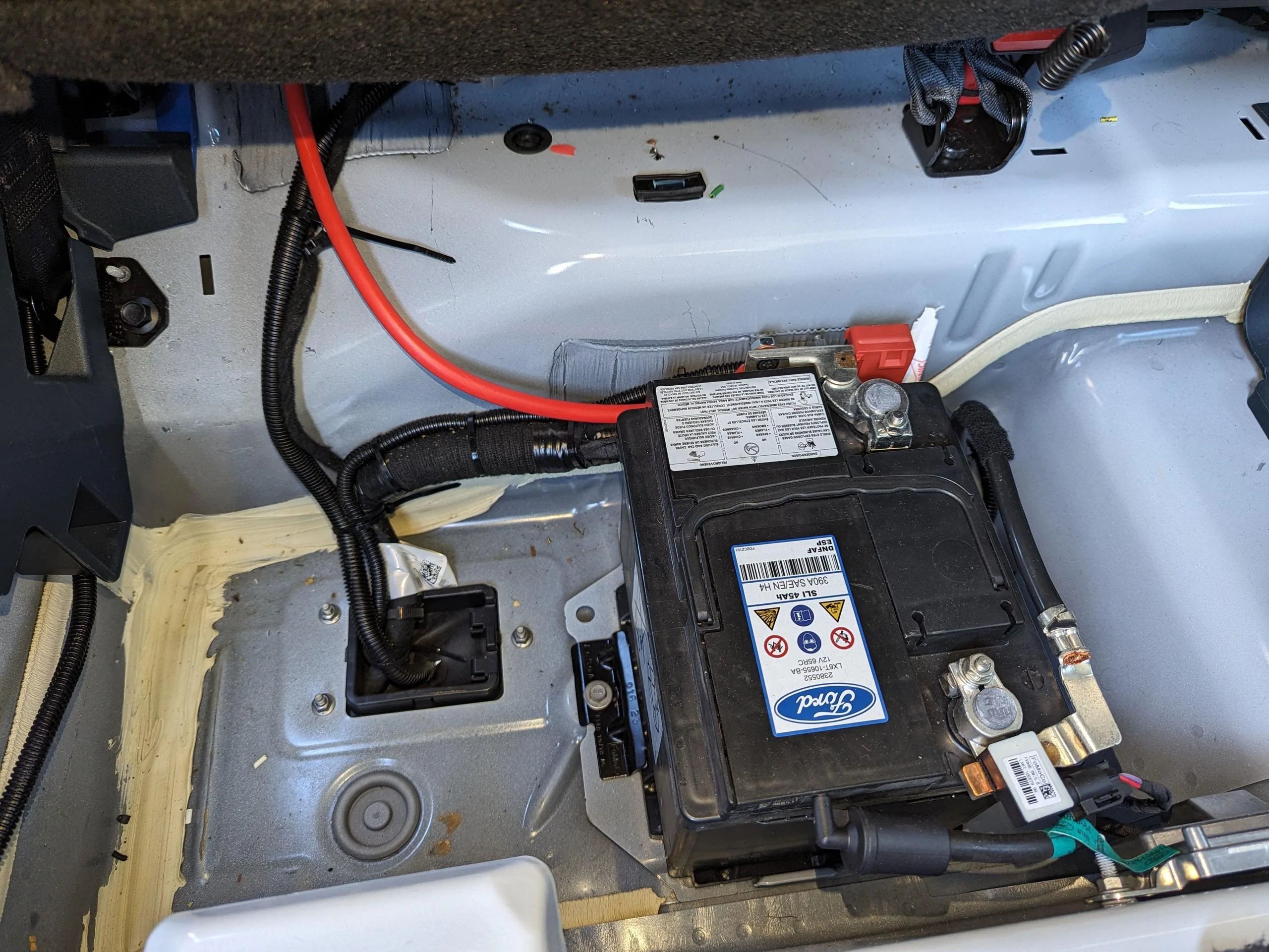

the positive went directly to the battery. I used an existing stud.
The negative is connected to the body.

Here is a update. I ran the 12 Gauge power cord it the rear Driver side cubby through a rubber grommet that was already there. I did have to make a small hole in the grommet. In addition I found running it side by side and Zip ties it to existing wiring worked very well. Power outlet was installed. So far so good. I did have to remove the shielding that covered the area 2 thin crews and two bolts. Made it way easier to do. Wizard THX. Question What is this thin air sheild/damm made of. Feels way to soft to last.

Did you wire the positive and Negative leads to the Battery?
Sorry for the delay.
The ground screw on the upper left (facing rearward) is where I grounded the inverter.
You can see the stud on the bottom that I used for the negative input for the inverter.
You can see another available stud just to the left of jack package.
I connected the positive inverter input to an unused stud on the battery clamp.

[FONT=arial]Wizziard[/FONT] I have been delayed on the project. Finally have gotten back to it. I have a question how did yo remove the battery housing to get access. Ive taken a look at mine and cant see how to do it without breaking
the box. Any advice.
