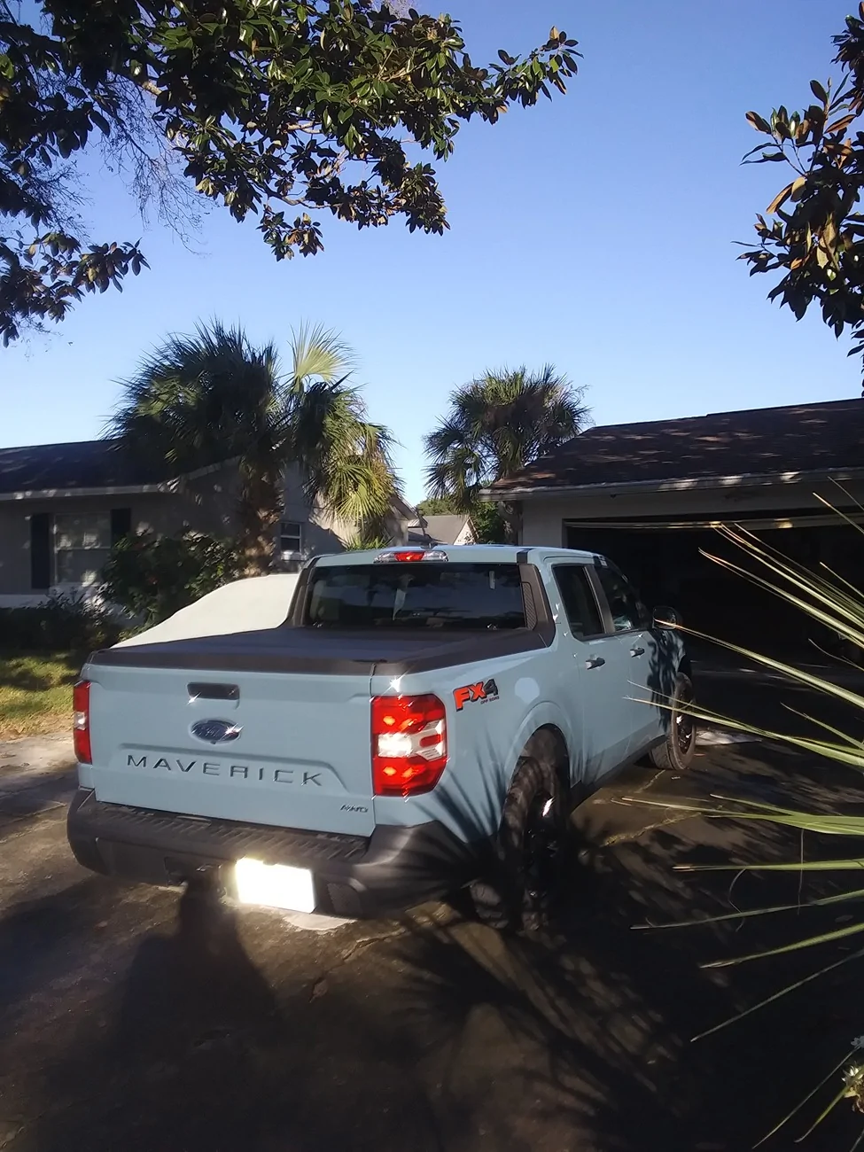

Put a power station (appropriate size according to need ) in bed of maverick . problem solved for 120 volt needs . I have a 300 watt ( paid $90) and 1500 watt power station (paid $360) for emergency here in Florida . Also have Honda 2000 inverter/ generator for emergency purposes . Also used for previous camping with rv trailer .
