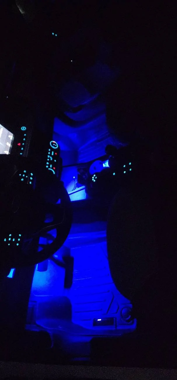

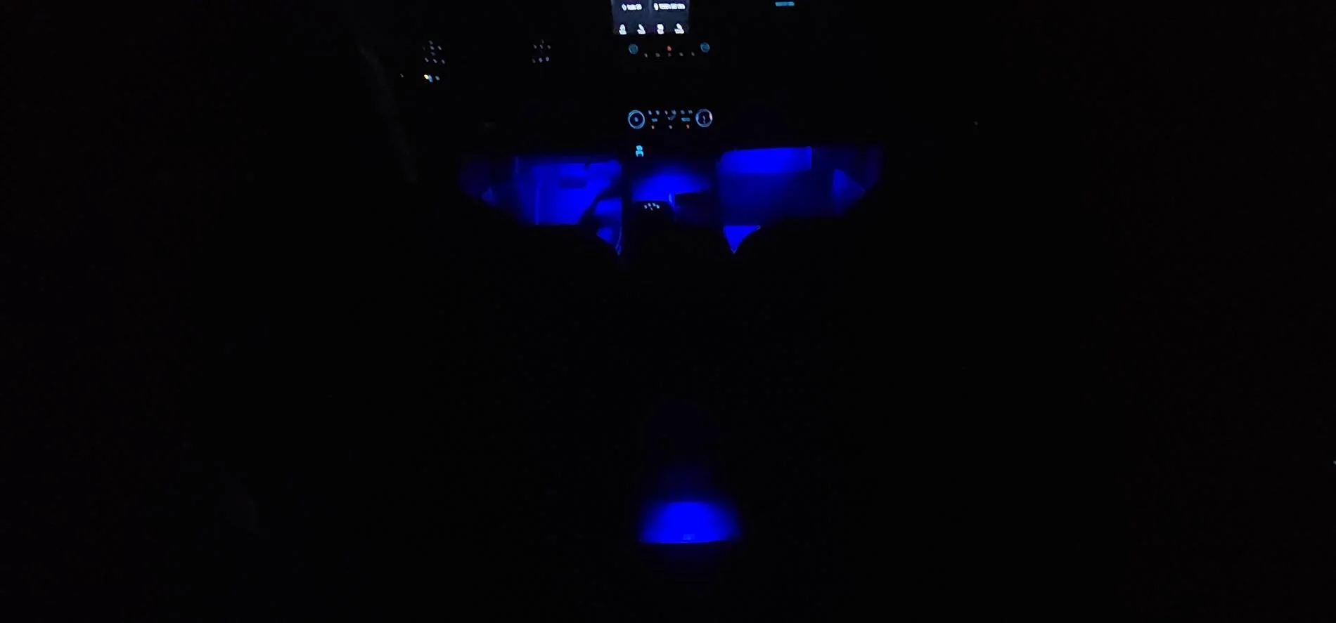

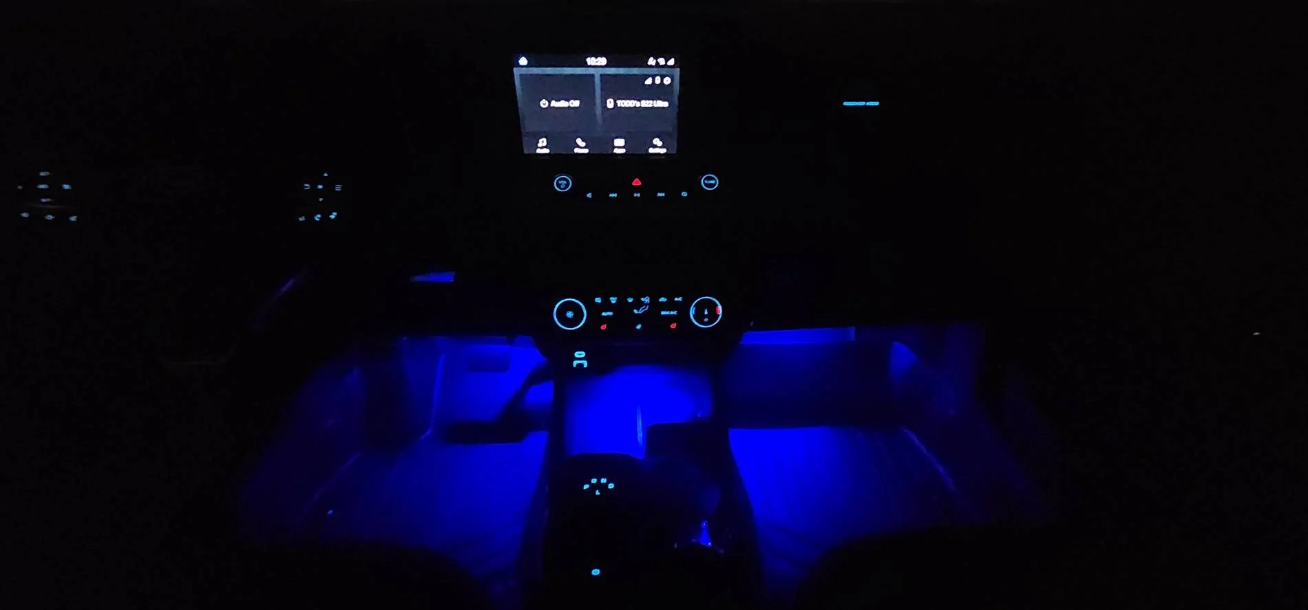

I tapped the 12 volt plug for my ambient lighting.

Looks like you removed the entire center console. The OP removed the lower section under the climate control knobs.
Yes, it was the easiest route to install my ambient lighting in the area of the front cubby below the HVAC controls the cup holder area and the rear of the console.
Would have been very difficult to do it with the console and the truck still.
